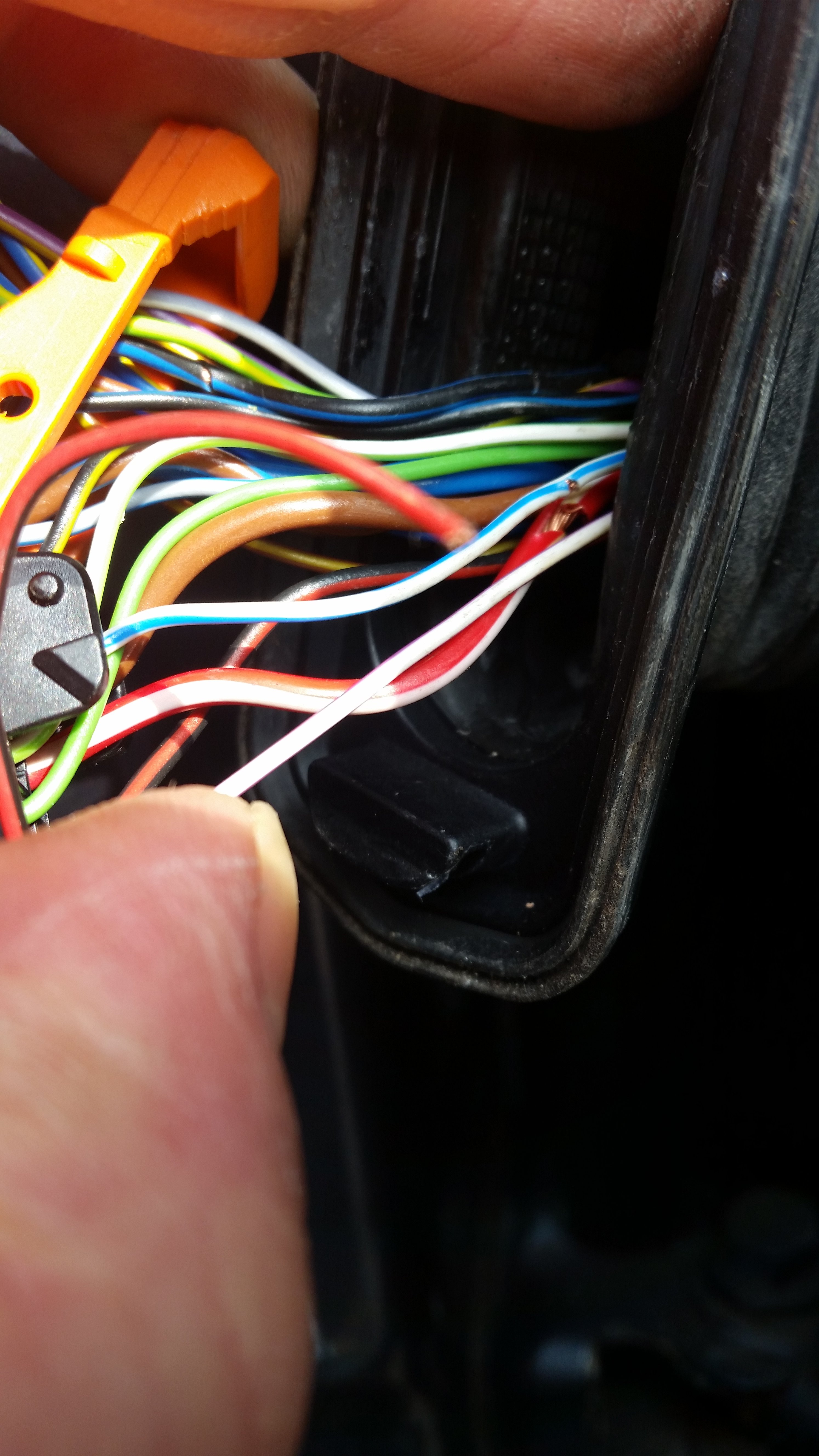

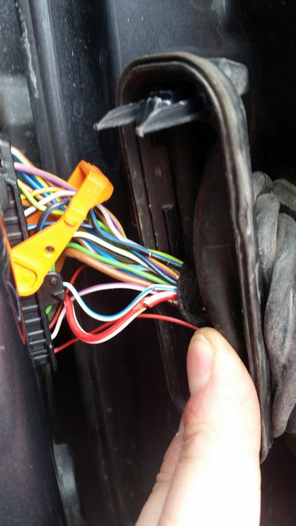

I've just removed the rubber boot &  taken these 2 photo's from the drivers door side wiring loom & found more than 1 wire damaged, but the passenger side will be much the same, as when opening or shutting the passenger door the central locking keeps operating.
I have been quoted (Skoda dealer) £84.60 for the driverside door wiring loom & 1 hrs labour for fitting it.

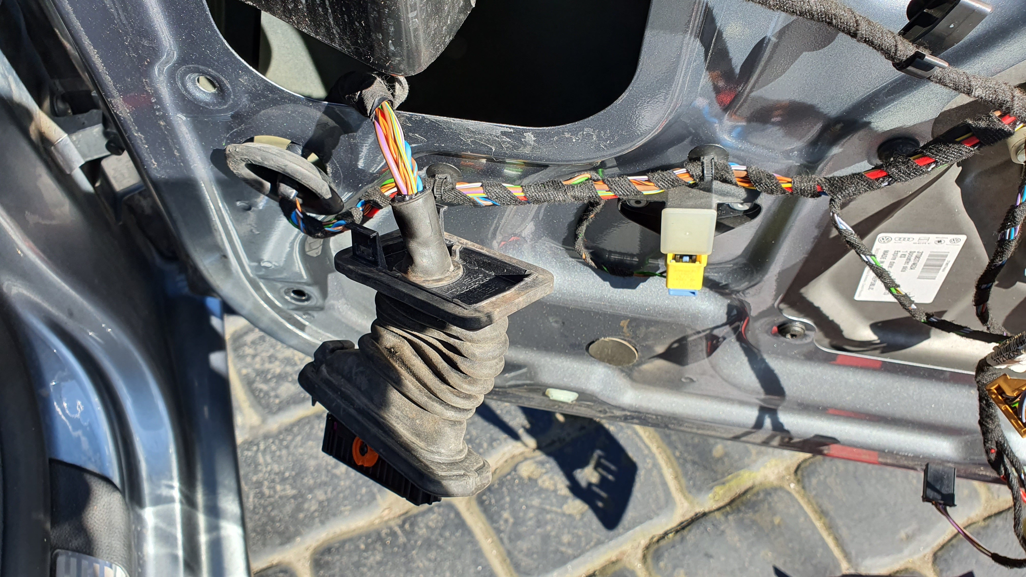

I was able to repair the damaged cables if it helps anybody. I removed the door card etc and was able to feed the plug out to repair.(not easy but doable). I fed it out on the inside of a metal bar that the window runs on. Out thru where i removed the sticky cover. Superb 2011
