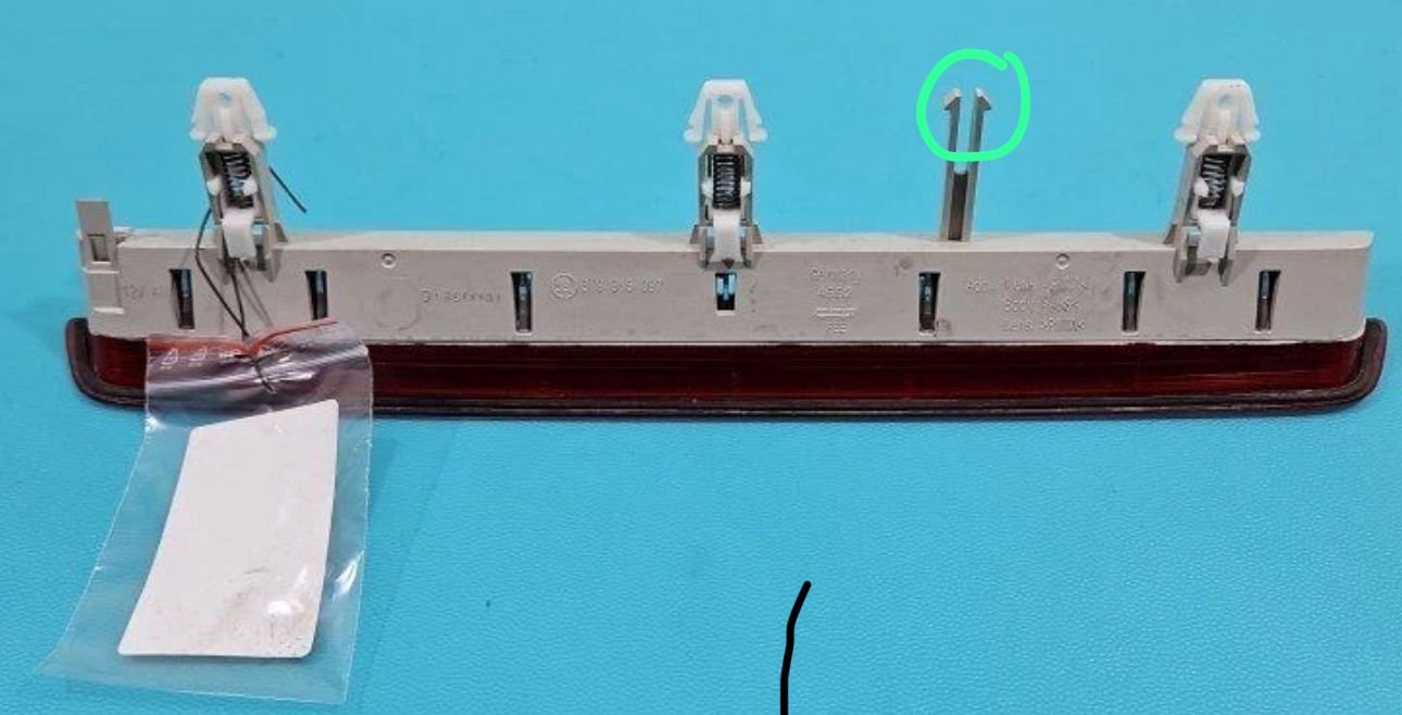

when you then see the led it doesn't have any bolts (so nothing like the youtube octavia video)
but does have some weirdo plastic spring-loaded clips you can barely see thru tiny openings.
it would have helped if I had seen the pictures first before doing this
Eventually popped it out with the help of some patience & small long nose pliers - there is probably a much easier way.
managed to crack a corner of the otherwise pristine cover waggling it out.
the secret seems to be after freeing the 3 plastic tabs back through the holes there still remains a single plastic retainer as shown in the photos.

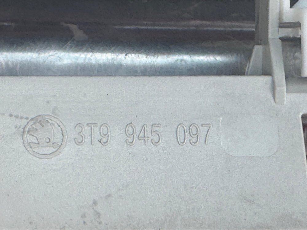

anyways if you get the 3rd brake light check the wire loom first, its honestly about a million times easier that removing all that trim and light,
there is a distinct lack of that light 3T9 945 097 on ebay etc and its easy to see why - its almost designed to self destruct on removal.
New ones are £150+ and when I looked out of stock..
