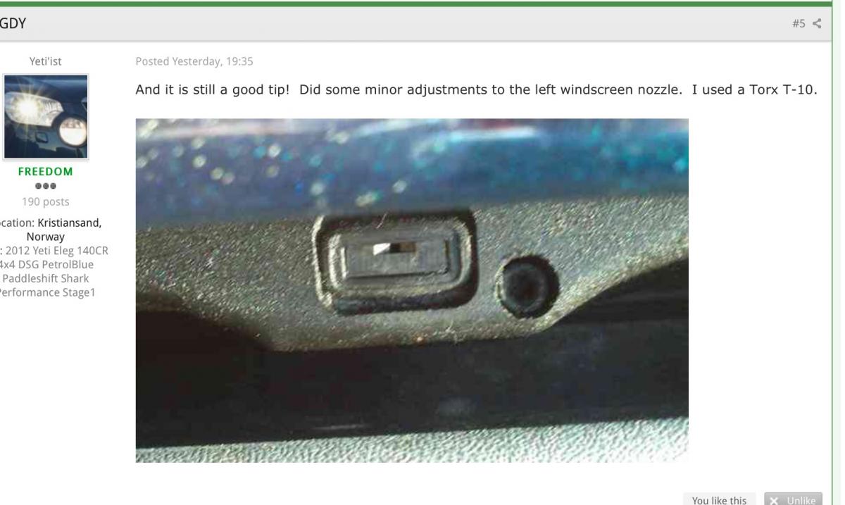

  • if they are like the Audi ones, you turn a torx bolt to adjust the hight of the washer aim, do 1/4 of a turn and retry.

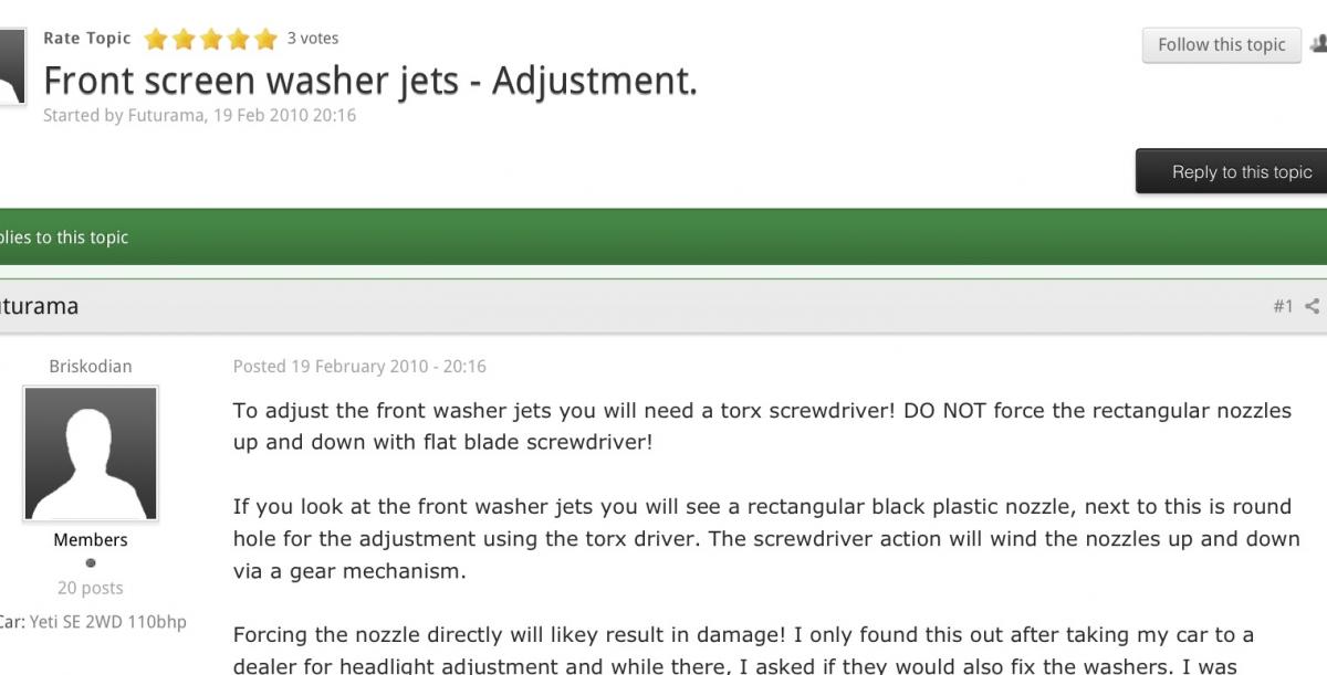

  • The topic was partly covered some time ago.... I did screenshot for my future use.... Hope they help.

Adjusting the screenwashers is no problem, it is the same as the MKII a smal torx/allen head screw. At least it is on my 190 L&K. Possible reason for aparant extra pressure on the near side could be that the tank and pump are on the nearside.
At slow speed it could be a little higher on the drivers side, but raising mine sends too much over the roof at 60/70 mph. The new jets have 3 jet sprays per unit not the full fan spray as the MKII. I still have new spare MKII units and if I do not get used to the new ones I will swap them.

how exactly does that work? Does the position of that screw alter the position up the windscreen?
Good picture of the adjustment screw, only difference on the MKIII unit is that it is not a fan spray.
