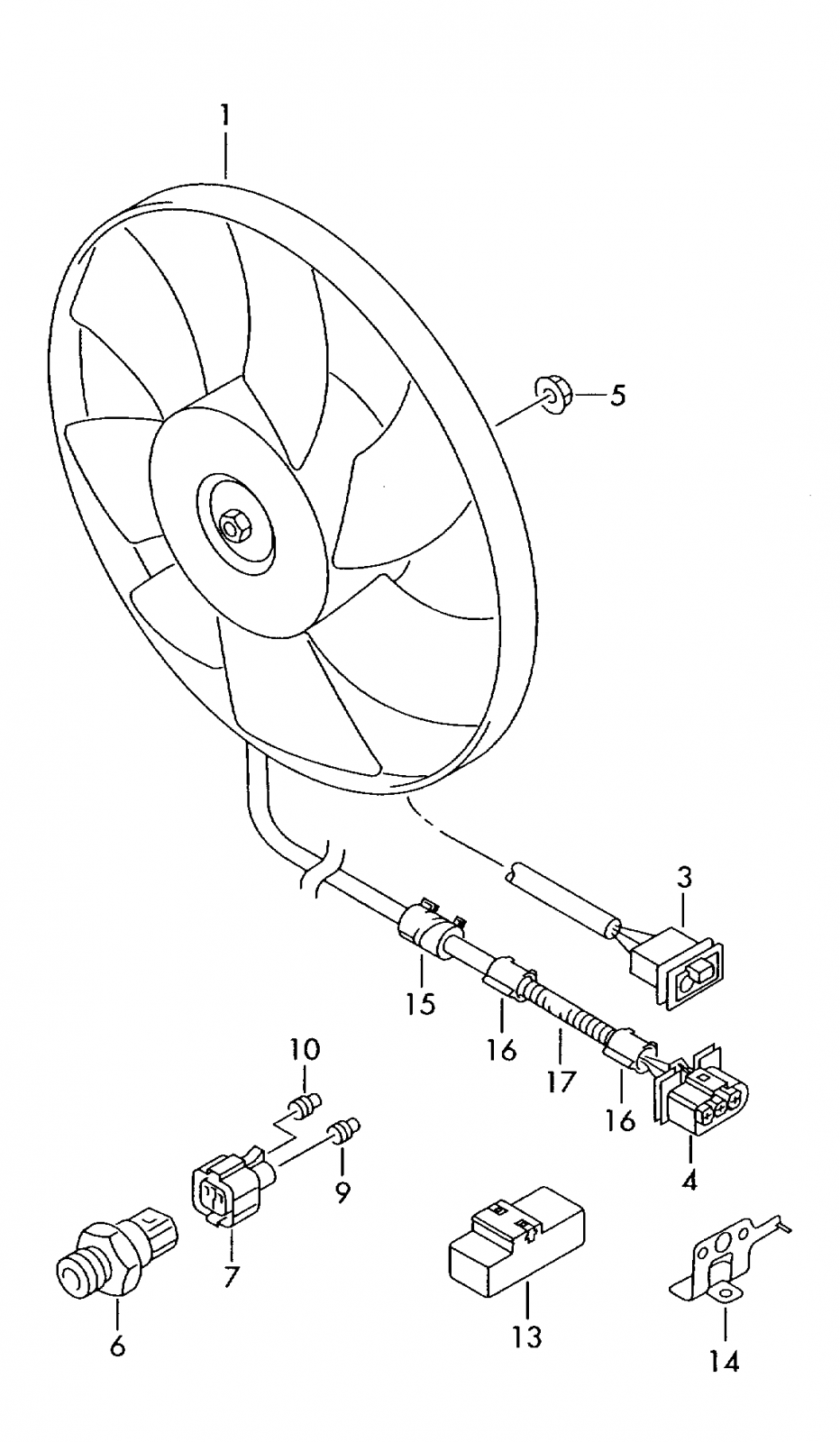

Check the fan thermoswitch just above where the bottom hose joins to the radiator. Two wires and it's a single speed fan, three wires and it's two speed.
Check for blown fuses in the battery-top fusebox. Low speed is probably a 30 amp blade fuse under a cover.

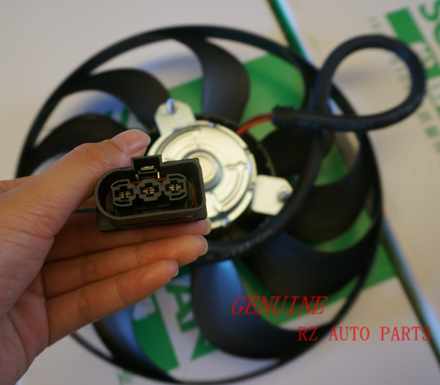

thank you for replay , actually three wires  , I think must change my radiator fan

Worth checking fuses first, and you can also test the fan on each speed by linking pins 1-2 and 1-3 on the connector which plugs onto the thermoswitch (with ignition switched on).
There might also be a fan control unit, which is a small black plastic box with a couple of relays inside, hanging off the bodywork near to the thermoswitch. Check the wiring and connections to that if you have one.
has been check the bin of fan direct,  linking pins 1-2 not working  linking 1-3 working
