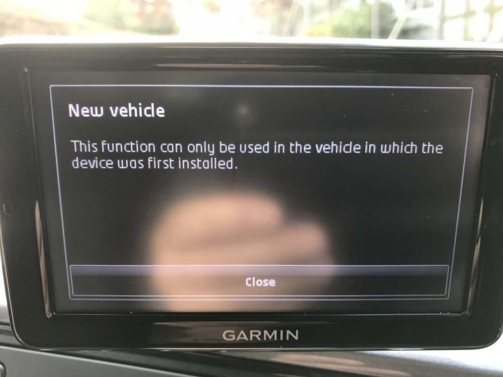

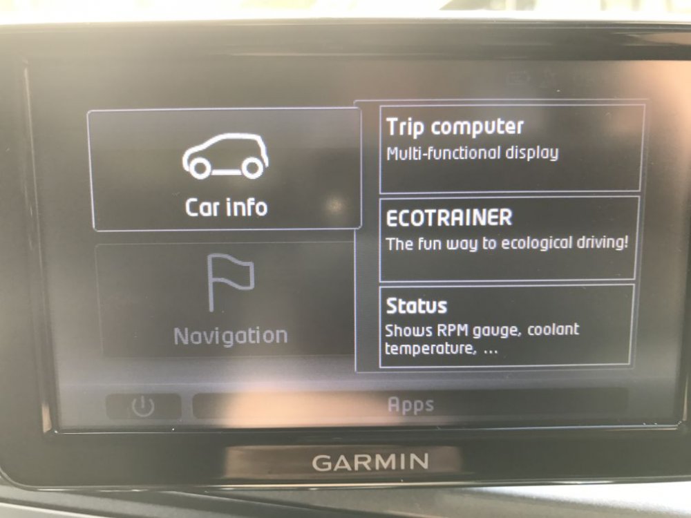

So I just bought a 2014 Seat Mii from a Seat dealer with a Garmin installed and when I select the ECOTRAINER option I get the message 'This function can only be used in the vehicle in which the device was first installed'.
I called the Garmin Navigon helpline and they stated that nothing could be done to fix this.
Anybody know something they don't ?

Nobody ?
Must have been an ecomotive Mii it came from as I don't have that feature on mine.
