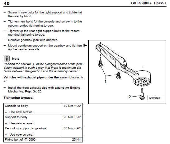

Hey folks. i'm getting quite a shuddering when pulling away or reversing on hills/quickly. reckon it's either clutch or dogbone related.  the other engine mounts seem ook. I checked my timing and it seems ok but does waver +-0.6 (measuring block 4))
how does this dogbone look? missing some rubber but still enough?
While you have it off. I would change it. For the cost it's worth doing

That bottom part doesn't look to healthy to me. I'd stick a new one in.

I had same issue on my 406. Dodgy feel to the clutch. Dogbone engine mount ripped. The lower one was in two half's. Changed and felt like a new car
That bush/mount looks fine to me. I think you may be seeing remnants of the webbing from when the rubber part is manufactured that is making you think it looks worse than it is. The tatty looking frayed bits of rubber in the cavities serve no purpose at all.

The new one ended up looking pretty much the same as the one i've got so i left it for now. Will have to get a camera mounted under there for a wee drive
It's the clutch/DMF causing the problem as you correctly guessed, doubly so now that you've eliminated the dogbone bush.
