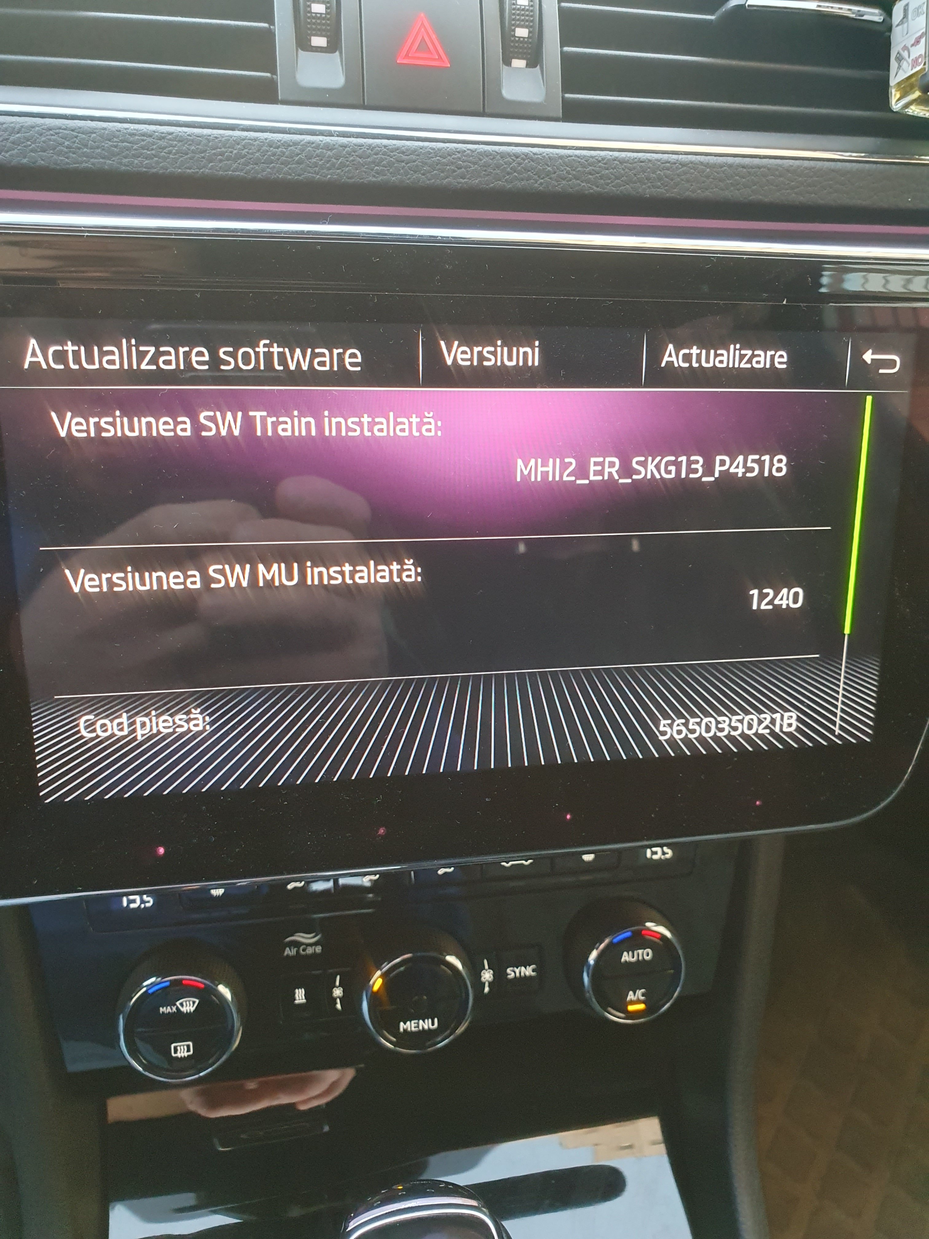

These are the Screens from before and after the Firmware update
IMG_1261.HEIC IMG_1276.HEIC

IMG_1276.HEIC
sure, but thats my screen now ;)
2 minutes ago, mrlittle said:
That was for @Rachetz32 his update is different to yours.
I replied quickly to 2x different posts, and the forum "helped" by merging 2 posts into one (which can confuse)
