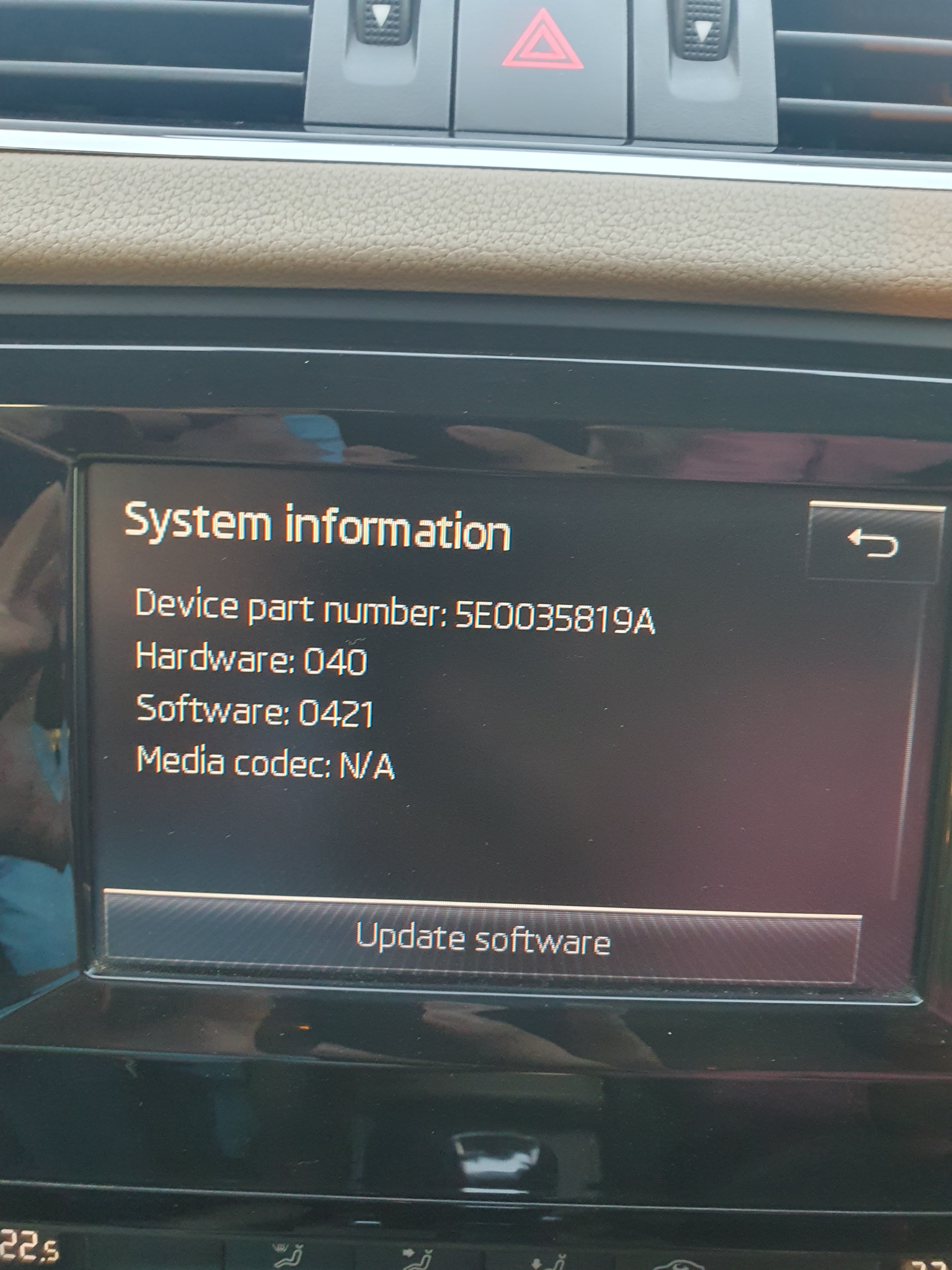

Hello, Guys! I am new here and i hope somebody can help me update my radio?
My system information are
Device partn: 5E0035819A
Hardware: 040
Software: 0421
THANK YOU!
MY EMAIL: *****@*****.tld
Hardware: 040
Software: 0421
THANK YOU!
Hardware: 040
Software: 0421
THANK YOU!
*****@*****.tld
i have no idea about any of this

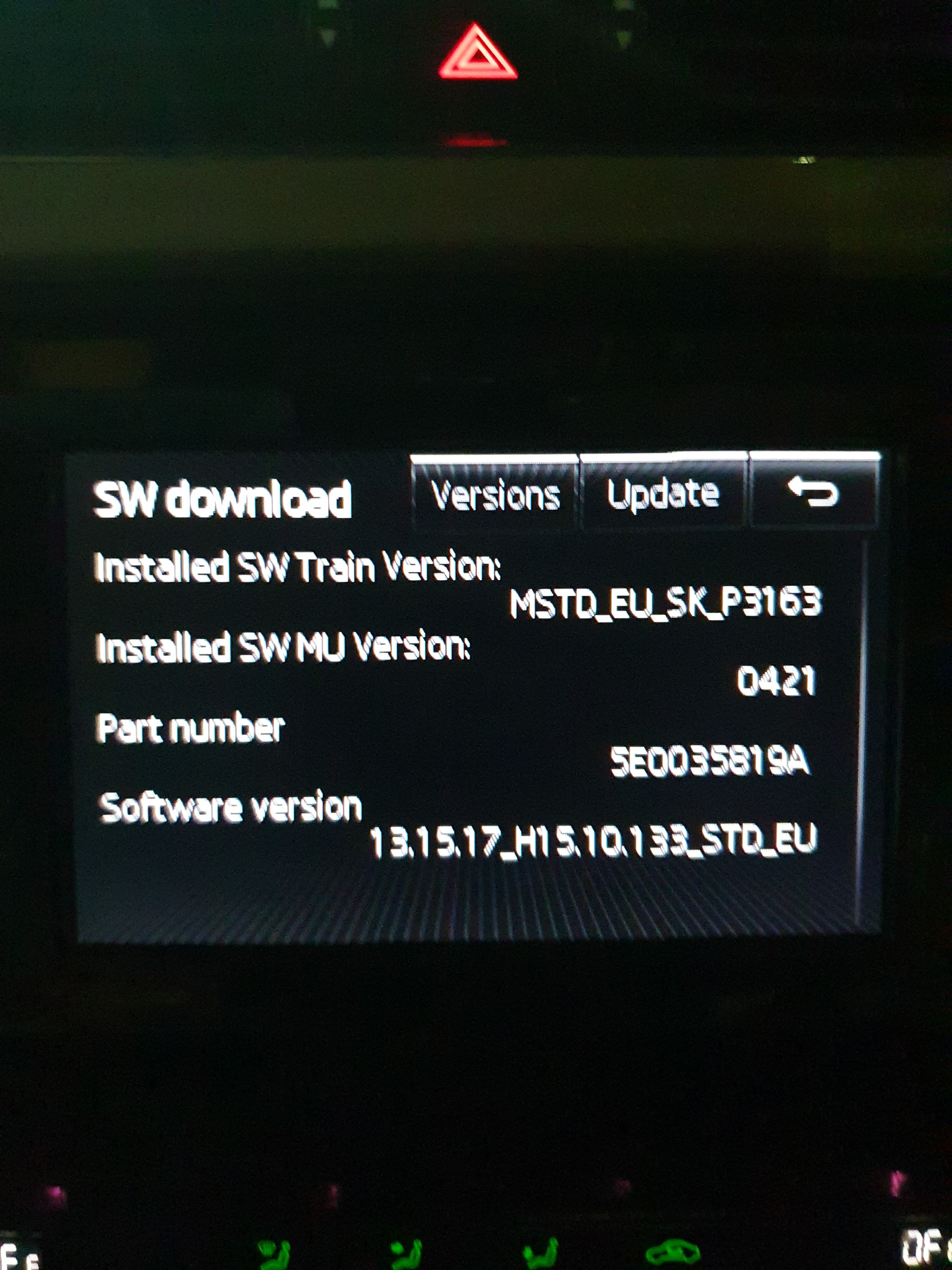

Hardware: 040
Software: 0421
THANK YOU!
/cdn-cgi/mirage/7f3a4109b7c9db5275ba0696e58b3cb7d9ae65c743ad6ace706caf7e66e199cc/1280/https://www.briskoda.net/forums/uploads/monthly_2023_01/20230117_174945.thumb.jpg.f9a0df4790d5b6740803dfe1b7f0d45c.jpg
Press and hold down your Menu/Setup button for about ten seconds to enter the hidden engineering menu.
You are looking for Software Train information.
is this the one?
4 hours ago, AryadityaD said:
is this the one?
Yes this is the screen to perform update, and verification of Software Train

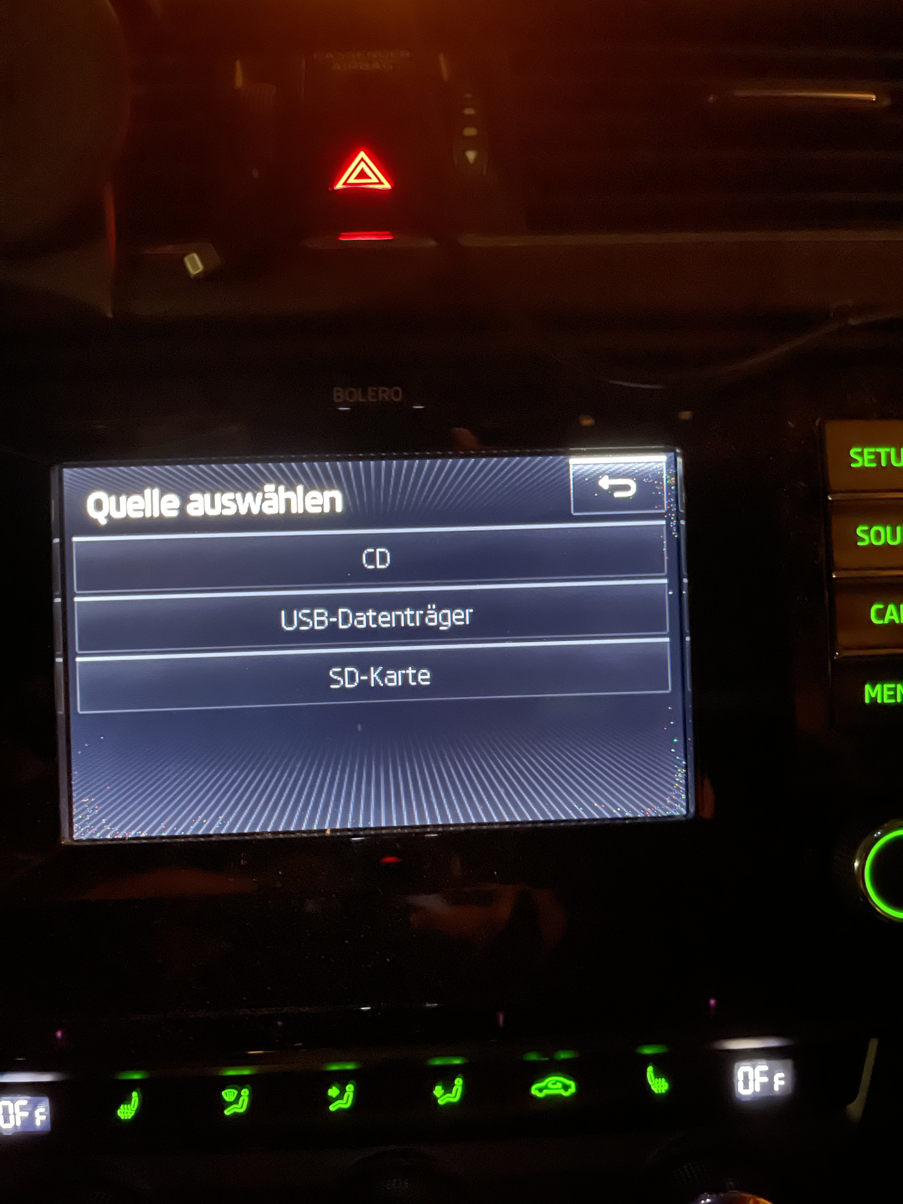

i was not able to choose the Sd Card as an update medium because it was grey.
fat32 formatted
fat32 formatted
Have you tried with a USB stick?  That would be next choice.
no not till now, that can i test later.
the Sd card works because theres a audio file which can be played on the media player but alle three udate things are grey with an fat32 formatted  32Gb SDHC card
