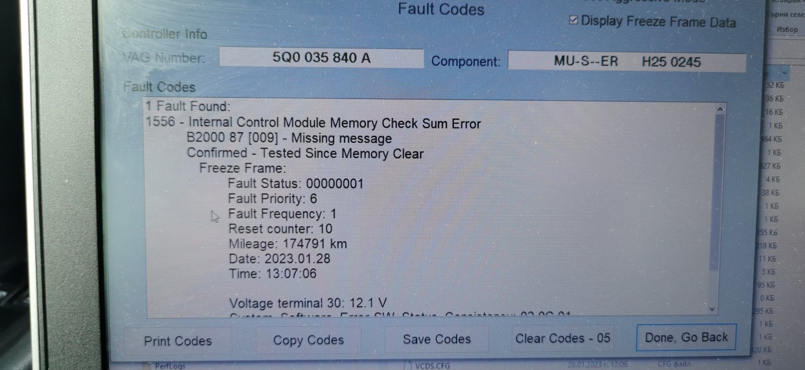

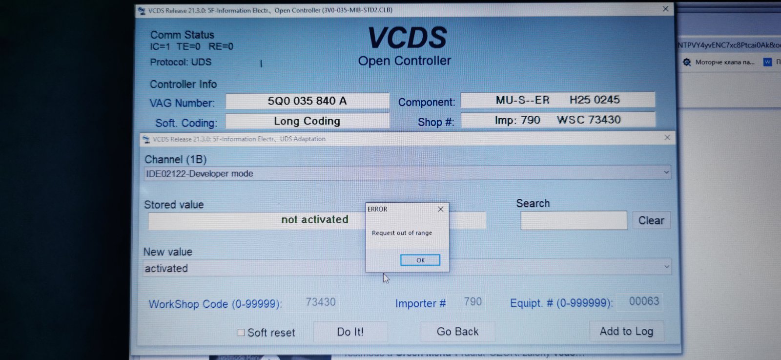

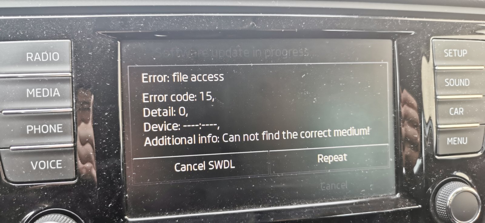

I have a problem. I can't get to the green (engineering) menu. And when updating to MST2_EU_SK_ZR_P0253T, it gives me an error. Do you have any ideas?
@AtanasYordanov
Green Engineering Menu needs to be enabled in VCDS, if that what you want.
Meanwhile, engineering menu should be available, and in theory be able to update firmware, but it could be the internal storage in the Amundsen radio is corrupted.

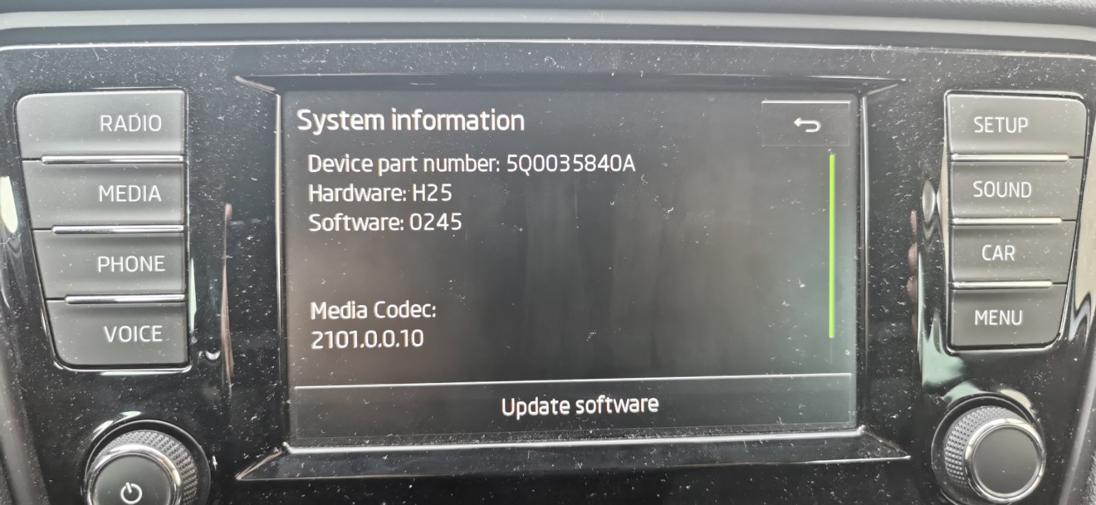

I managed to update, I used SD Card, with USB it failed.
But green menu does not activate, probably my cable is defective or weak.

No matter, I just wanted to view extra settings.
"Also did you login to controller first for security?" - No, maybe I had to enter some code into Security Access?
Yes you would need to login with security access, enter S12345.
Then try to change value.
Thanks, I have a green menu now.

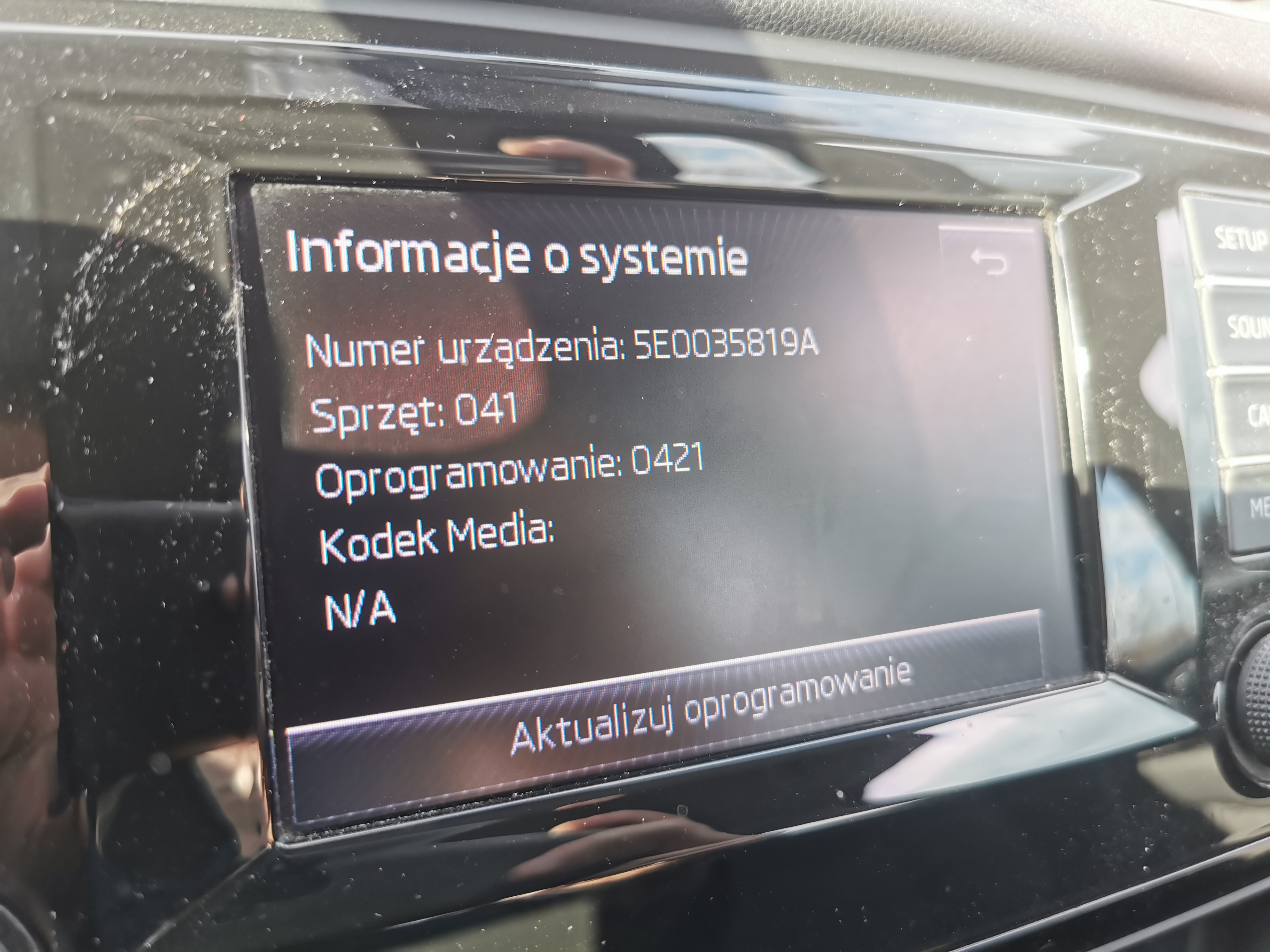

Hello,
Any chance to update this one?
5E0035819A
Hw 041
Soft 0421
Kodek media: n/a
Very often sth gets screwed and the radio looses stations and radio icons.
Br
Robert
25 minutes ago, FishRman said:
Hello,
5E0035819A
Hw 041
Soft 0421
Kodek media: n/a
Br
Robert
I will send you update to 0490 version.
