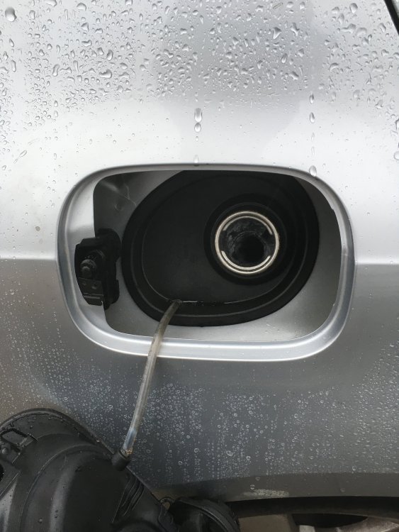

  • Just to update this, I ordered the part from Skoda, received a couple of days later and fitted it tonight.  Luckily I could still open the fuel flap by thumping the body just behind the flap and press
  • Waaayy-haay!! Done it!!. Removed all the driver's side trim, including this time the upper C pillar cover (behind which there is no airbag, despite there being an Airbag symbol on the panel) which th

Oh yes! Many many times, putting all sorts of different pressures on the actuator end of the flap, pulling, pushing, hitting it, thumping it, you name it, I've tried!
Still no success opening the filler flap.

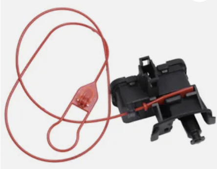

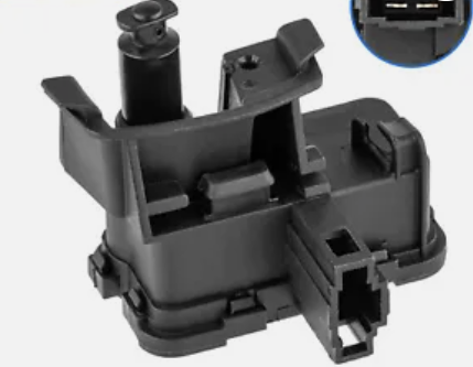

Apparently the locking solenoid can easily be levered out with a small screwdriver once the flap is open. but when closed it locks itself into the housing.
"Have you tried going in from the boot?" they asked - and of course I have to no avail.
"Have you tried removing the arch liner & seeing if you can find anything there" - and of course yes I have but no luck.
Then they fiddled on the computer for a while & came up with the diagram featured in earlier posts together with instructions how to replace the solenoid when the flap is open....  but no instructions what to do if the flap is locked shut.
"Looks like you're going to have to lever it open until something breaks" was the ultimate technical solution.

I can't understand why these manufacturers make life so complicated. Why is it necessary to use a solenoid with its electrical connections, etc. to lock the fuel filler flap. Why can't they just use a cable like they used to. Much less likelihood of failure and much cheaper but I suppose it doesn't reflect the wonders of the technological age in which we live.
The ecars of today have a single loom from the computer which would make plugging in a 'cheap' solinoid v simple compared to routing a cable and the fixings at each end............. Time and ease of assembly on the production line, I suspect.
Looks as though the "cheap" solenoid isn't so cheap after all.
My enquiry to 3 dealers has revealed prices ranging from £32 to £43.50 plus delivery. Interestingly, the lowest price was a VW dealer, the highest was Skoda.
Not spoken to my local Skoda agent yet, but I'm guessing their quote will be around the higher price. That's just the solenoid unit, it doesn't include fitting - which I intend to do myself anyway.
EDIT: Just noticed an email's come in from Listers Seat Worcester (via [email protected]) who have quoted £24 delivered, which is better, but still not cheap.

As the cover appears to clip onto the body of the solenoid housing, I was going to have a go at taking the unit apart to see what's sticking inside and lubricate it with contact grease, but I'm pretty sure the contents are spring loaded and could fly out all over the place if i take the cover off. I'll look at it again in a few days time when I have nothing else to do....  (a very rare occurrence!).
