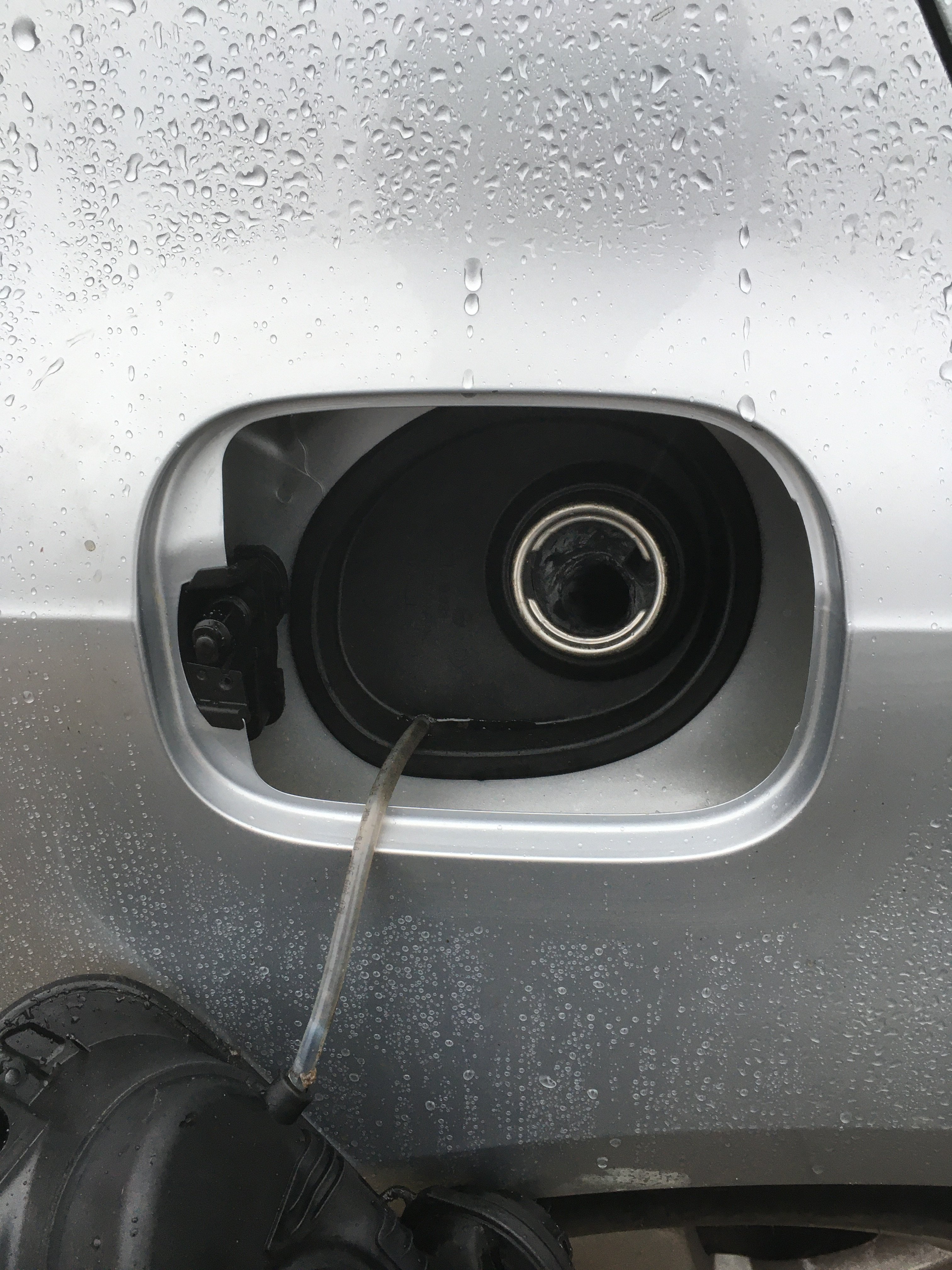

My filler cap just got stuck.
After stressing and loosing about 3 years off my life.
I used a plastic dashboard lever tool I had hanging around.
I just rammed it in near the locking mech and it popped open.
Sadly you can't leave the filler cap slightly 'ajar' as when you lock the car the alarm goes off. (circuit not completed?)
I ordered the part new solenoid from local dealer at £31.33
Collecting tomorrow.
Moral of the story don't be afraid to crack open the cap, I've done it about 5 times and it's opened fine.
