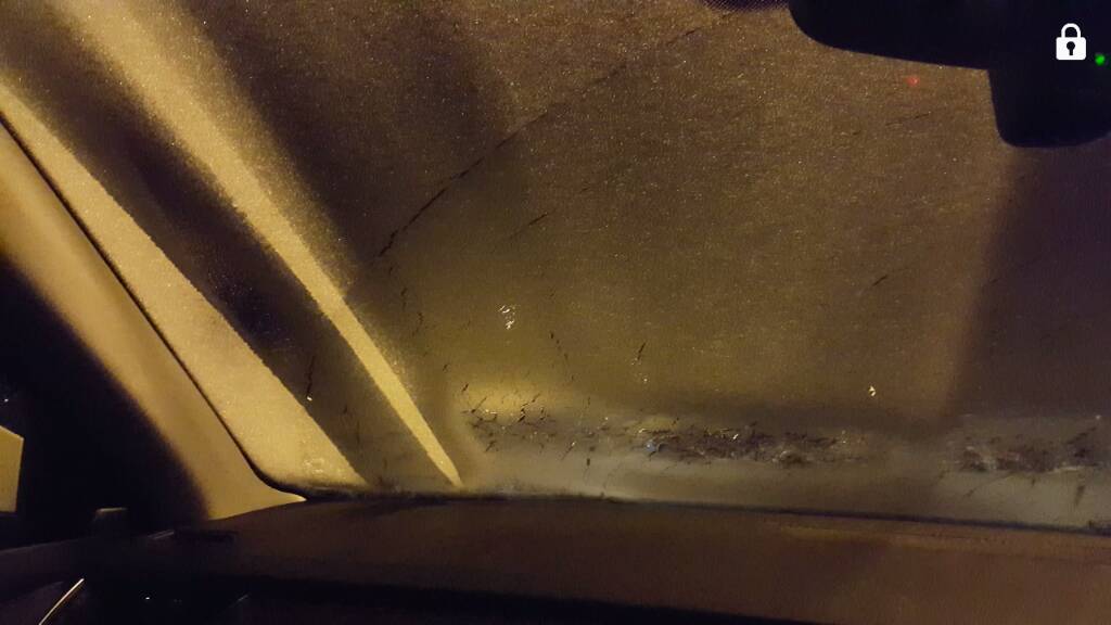

So just got to try out my heated windscreen for the first time yesterday and on the passenger side there is a strip that doesn't defrost (no I'm not talking about the edges of the windscreen where it's not really supposed to defrost) so I crossed all my fingers and toes hoping somehow it might have been a one off but it as done it again today.

A photo would help, but I guess you have a vertical strip somewhere in the middle of the passenger side of the screen that doesn't heat up?
Only cure for that is a new screen, there is a common busbar top and bottom for power on each half of the screen.
Someone posted a while ago on here a heated screen where only half of it worked. As andyvee said, pictures would help; certainly a warrant job though.
A full half not working is likely to be a fuse, relay or some numpty at the factory didn't connect it up
A strip in the middle of a half is a faulty screen
There is a very thin line right down the middle that doesn't heat as it is the very small gap between the two halves, you only notice it briefly though.
I recorded a video rather than take a picture to show the full defrost from beginning to end
Faulty screen. Had just one like that in my old Mondeo. Only mine was right above the steeringwheel.

Faulty element. I expect it needs a new screen. I think I had this problem in a previous car of mine.
