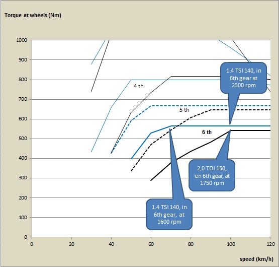

In fact the 1.4 TSI is doing better than the 2.0 TDI for carrying load or towing.
The gearbox is designed so that it brings more torque to the wheels in 5th or 6th gear than the 2.0 TDI, and at far lower speed.
The 2.0 TDI 150 is provided with a gearbox having very long transmission ratios, well suited for low consumption.
Unfortunately it jeoperdizes any potential advantage of the high engine torque.
Of course, regarding fuel consumption, your comment is right.
