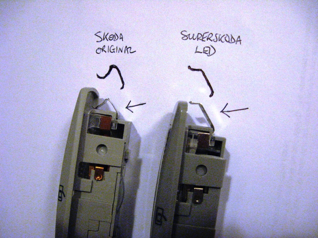

Has anyone fitter the LED rear seat interior courtesy lights from SuperSkoda?
I bought a pair when they had their 20% off deal earlier in the month and they are fantastically bright, but I cant get 'em to clip into the housing in the headlining.
The spring clip is a completely different shape to the original Skoda lamps, so the new ones don't click into place.
I've emailed SuperSkoda with photos & details, and they tell me that they are all like that & they fit ok in their own Yeti.
Am I doing something wrong?
I think I held the clip with a pair needle nosed pliers and gave it a slight twist. Pretty sure someone on here or YOC advised that. My SKODA originals are not as extremely angled as yours.

I think you may have bent the sping on the original when taking it out.
It should look like the Superskoda one.

Nope - definitely haven't bent the spring on the original lamps, and both sides of the car are identical.
And as Urrell says, you have to remove the lamp from the spring end first as the other end is retained by the wiring connector,

The spring on the lamp in the video (thanks) is exactly the same as my originals. The Superskoda ones are a different shape that doesn't spring into place against the metal edge to the lamp aperture.
I'm not going to try further on this car but will await the arrival of my new Yeti at the end of March, as I suspect that once in place the end of the spring on the Superskoda lamps will disappear behind the headlining and become captive thus preventing the lamp unit from being removed by the screwdriver method as shown.
My engineering mind tells me that when the new clip flexes, the tip will go up under the grey housing, thus it will not return to its position shown. The head lining orifice being much smaller the clip will remain compressed with the flat portion nearest the tip against the orifice side.
I've just made a rough mock up using cardboard, and even with several layers to imitate the thickness of the headlining aperture, the Superskoda version's clip does indeed flip behind the surround, whereas the original does exactly as you describe as the flat bit at the end of the clip is longer and at such an angle that it compresses as you push the lamp into position, holding it securely but retaining the ability to be removed later. I'll wait for the new car and try again then. If necessary I'll see if I can remove the spring clips from the original lamps & transfer them to the Superskoda ones.
