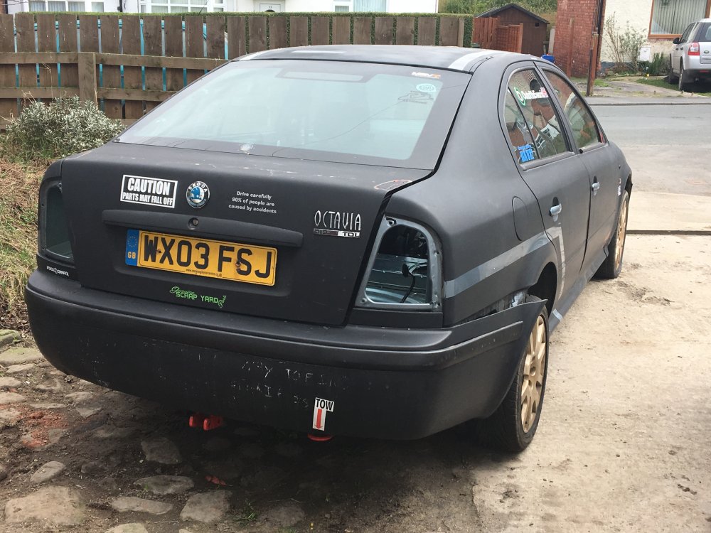

Outofthi5worlds dodgy wiper removals.
Do you want your wiper removed wrong? Then you've come to the right place! This is the right place because the left place will do it right, and that's just wrong!
Overused gag? Maybe, but so what?
Well today was supposed to be productive, but it turned out to be counter-productive in quite a big way. First thing I did was go out to the car with a socket set and un-bolt the rear wiper motor from the boot lid, then I got a spanner set and removed the retaining nut from the wiper arm on the outside. I pulled the wiper a bit and it wouldn't budge, so I got a big spanner out and put the open end under the wiper blade and on the glass, pushed a little and the wiper moved up, so I pushed some more but this time the glass went down.  :peek:
So out came the hammer and shovel and I cleaned up as much of the glass as I could. then I got the hoover out, started to hoover the glass out of the boot whilst taking stuff out and because it was cold the hoover pipe was becoming brittle and all of a sudden I lost all vacuum due to the hose splitting in half. As if this wasn't already bad enough.Now with all the glass in the bin and the stuff from the Octavia re-located I went out in search of something clear to put in the hole. No scrap yards were open as they seam to all like the idea of Monday to Saturday and the only place that had a piece of plastic big enough was B&Q. So I picked that up and a couple of tubes of Evo-Grip and went home. Then had to cut the original sealer off the car along with the glass. Eventually after a long time with a pen-knife, a screwdriver and a hammer I got to this:
Nice and clean, although now the center break light isn't connected because apparently the wires for that are in the sealant for the back window.  :wall:
Then with the Dremmel I cut the plastic to shape, nice enough job and wasn't that hard to do to be fair. But the next part was impossible, the mastic gun wouldn't start the tubes off, which was later found to be a tube of sealant where you first have to puncture the end with a nail or something after cutting the end off. Never seen that before. So I ended up cutting the tubes up and using a bit of waste plastic as a spatula to spread the glue. Then came the plastic, I stood on the boot with 1 foot on the bottom left corner, 1 hand on the top left corner, a foot and a hand in the middle and my dad with his hands on the right hand corners. We were there fore a while but it wasn't holding so eventually I said f*** it and decided that it wasn't going to stick so tried pulling it off only for it to have stuck along the top and cracked it when I pulled so I put it down again and got some duct tape, taped the sides to the boot lid, closed it and left it. I'll be back to it in a week when I get my next day off and see what it's like.
The bit of tape at the top going down is where the crack is.
Also I do realize it says for interior use only and that it is a mess but at the minute I don't :swear:  care. I should have just bought a car cover and got another boot-lid at some point because both of those things are now going to have to be bought anyway and that bit of plastic was stupidly expensive.
If anyone wants to buy a build-it-yourself window kit then this one is for sale:
However I have very successfully removed the rear wiper assembly which was my initial aim.
