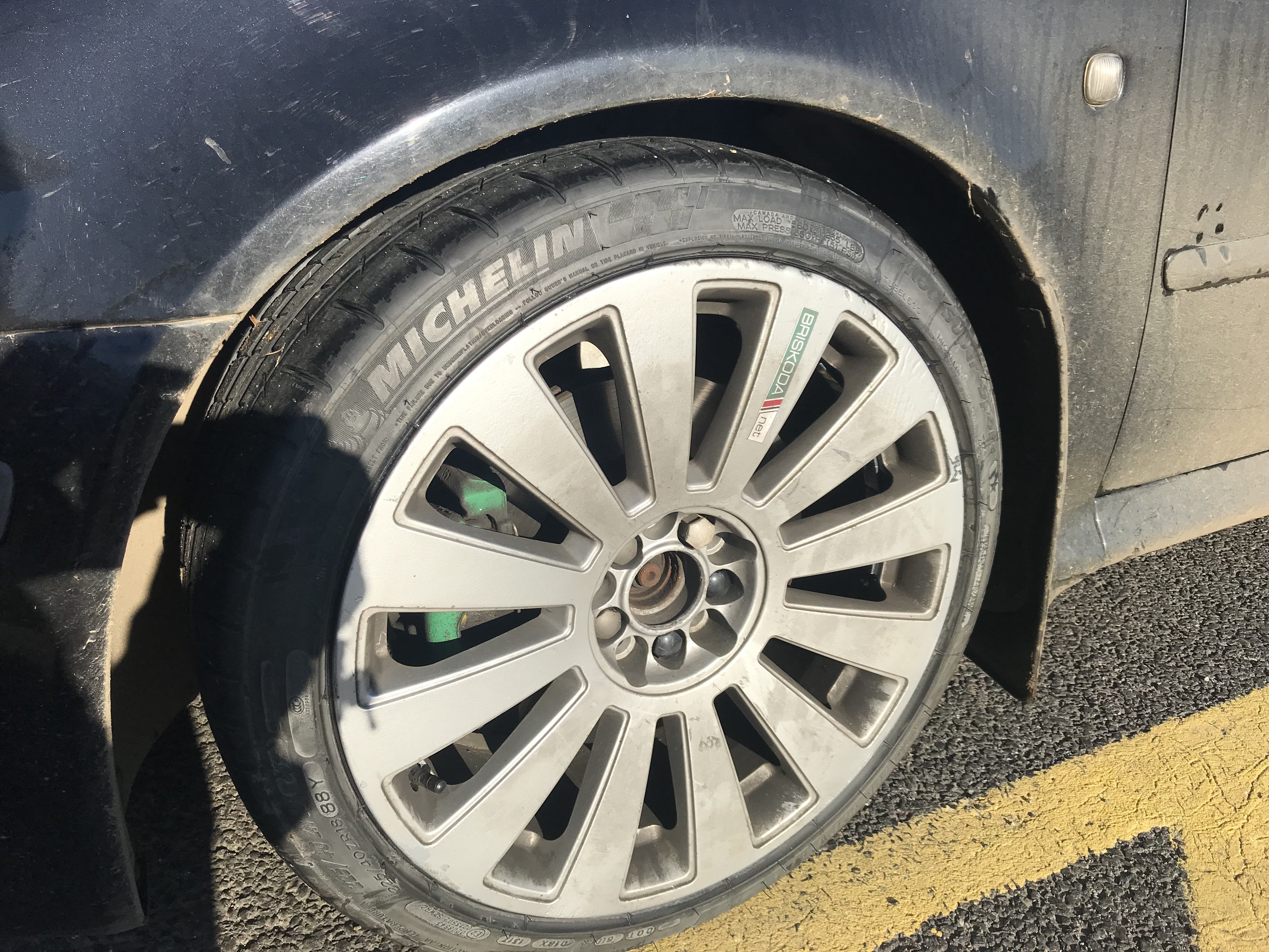

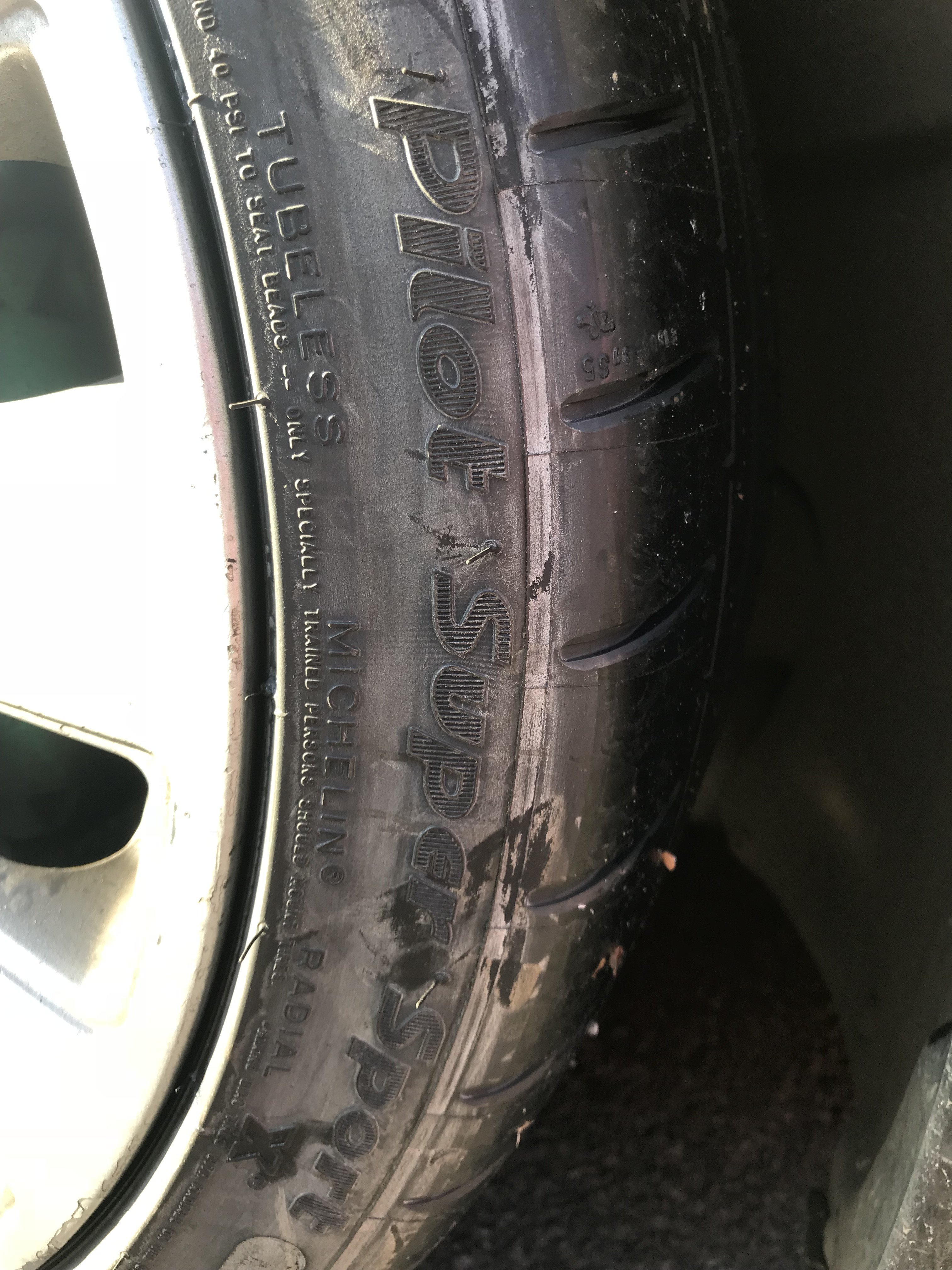

right, my 3mm track tyres are not cutting it anymore, tries to kill me in the wet.... taken them off for some "proper" tyres .... seeing as I only do the one track event a year (The annual Nurburgring trip) I have changed to a different tyre... I still don't need winter performance (winter tyres on the 4WD Brera) but a more road biased tyre, that can still handle being driven on the track! so we have gone for Michelin pilot supersports..... track carcass construction, so stiffer sidewalls (Using Michelin motorsport tech) , and dual compound tread, hard compound on the outer half, for track use, able to lean on those big blocks without them folding over like normal road tyres, and softer inner compound with groves, to work the water on a wet day! lets see how they go! (Had the rears on at this years ring trip, gripped perfectly, a match for the NS2R track tyres that were on the front!) so a matched set of four on the car now :) only a short drive in the day today, but the "broken wheel bearing" noise has gone! lol... (caused by the worn track tyres) ..
stance is good
proper tyres! :O
looking good :)

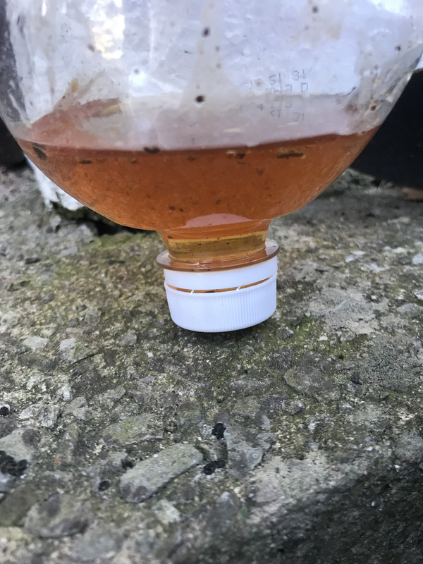

well emptied the catch can today as it was full! doing its job well, glad this crap isn't going back into the engine!

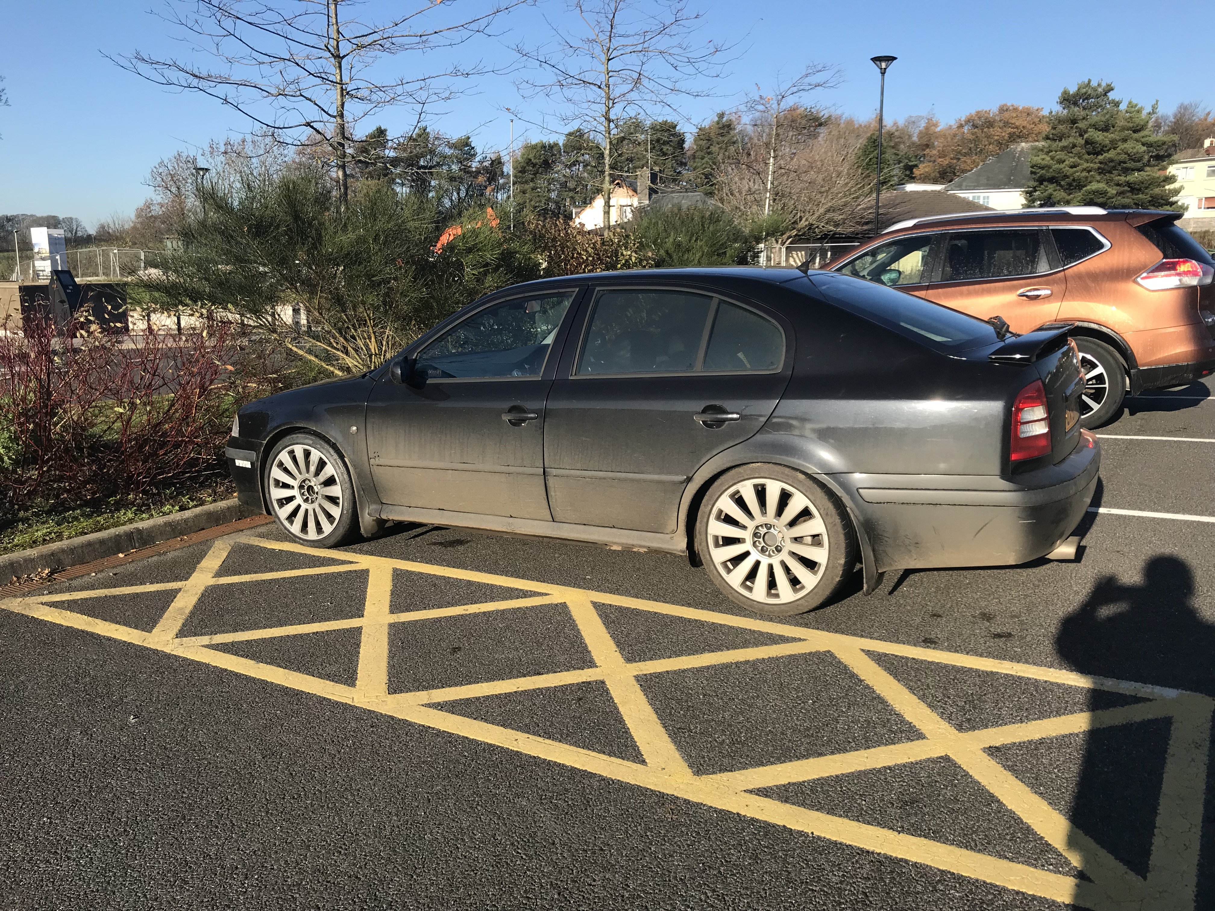

Given him a rare winter wash as I have been off work today... still looks good for 17y/o and 190,000 miles..! IMG-3459.jpg

yeah... £130 each fitted, but the best you can get for road/track use... normal road tyres don't work on track, normal semi-slick track tyres don't work on cold wet roads.... these are the best of both worlds really!
