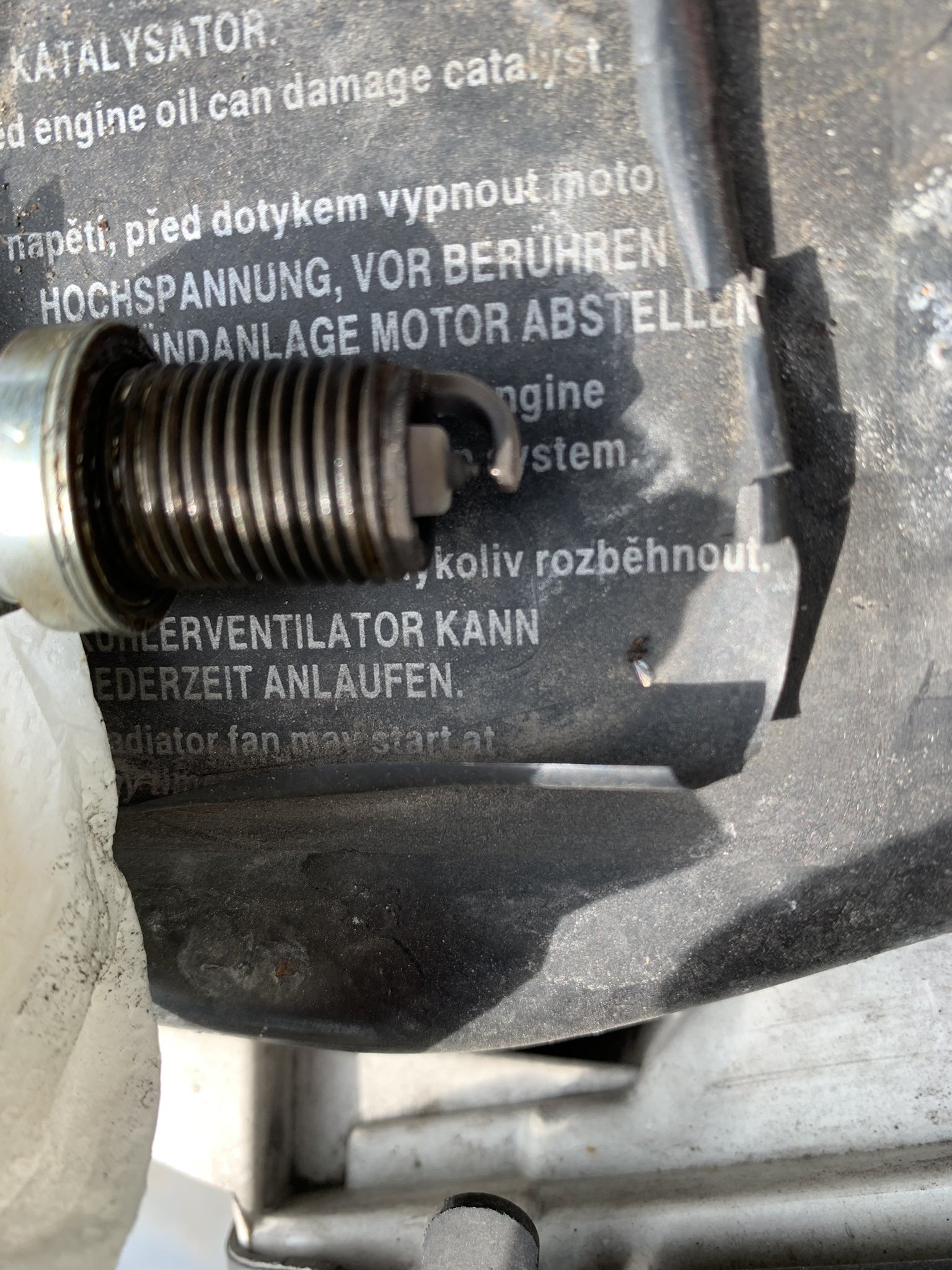

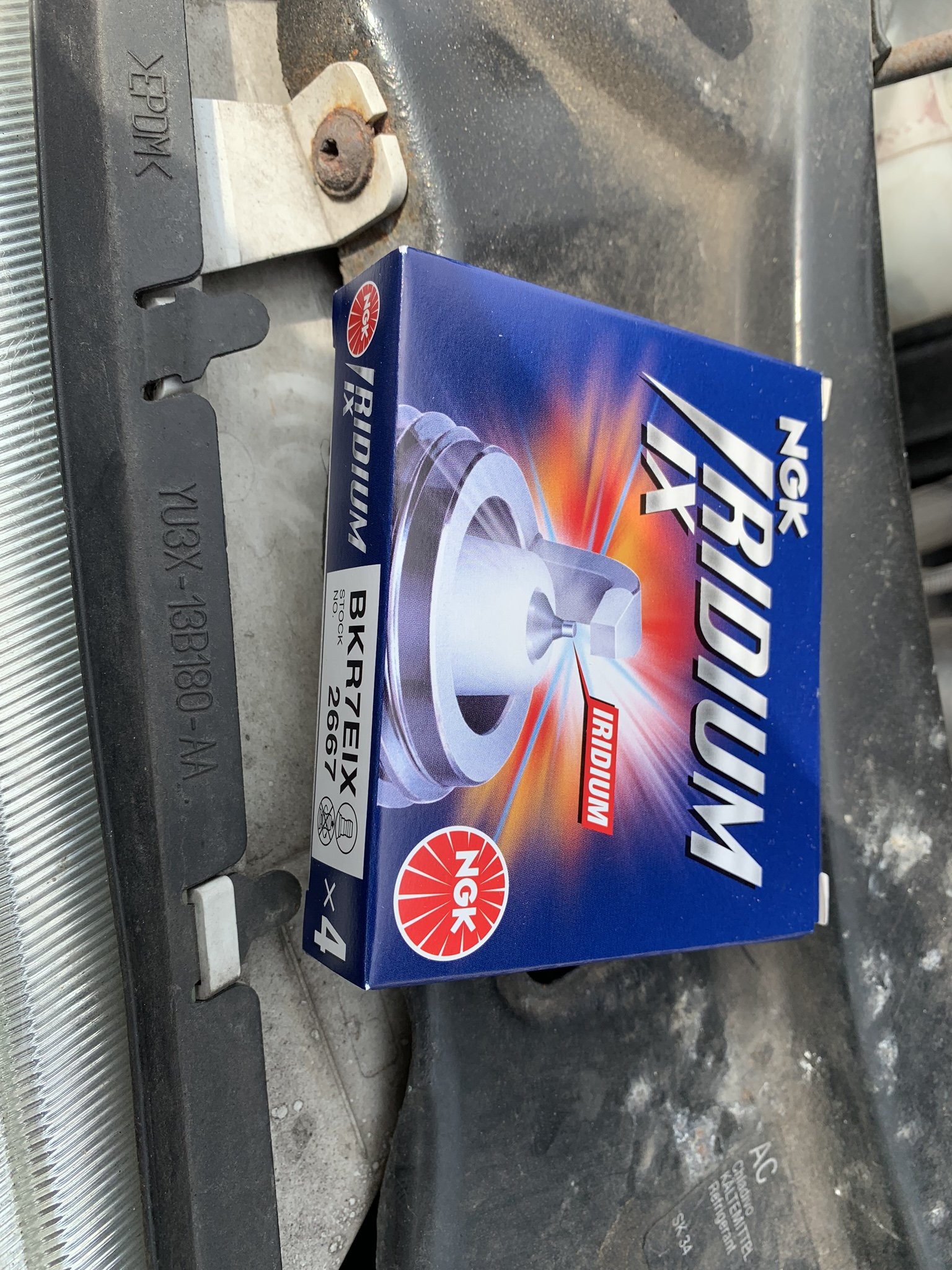

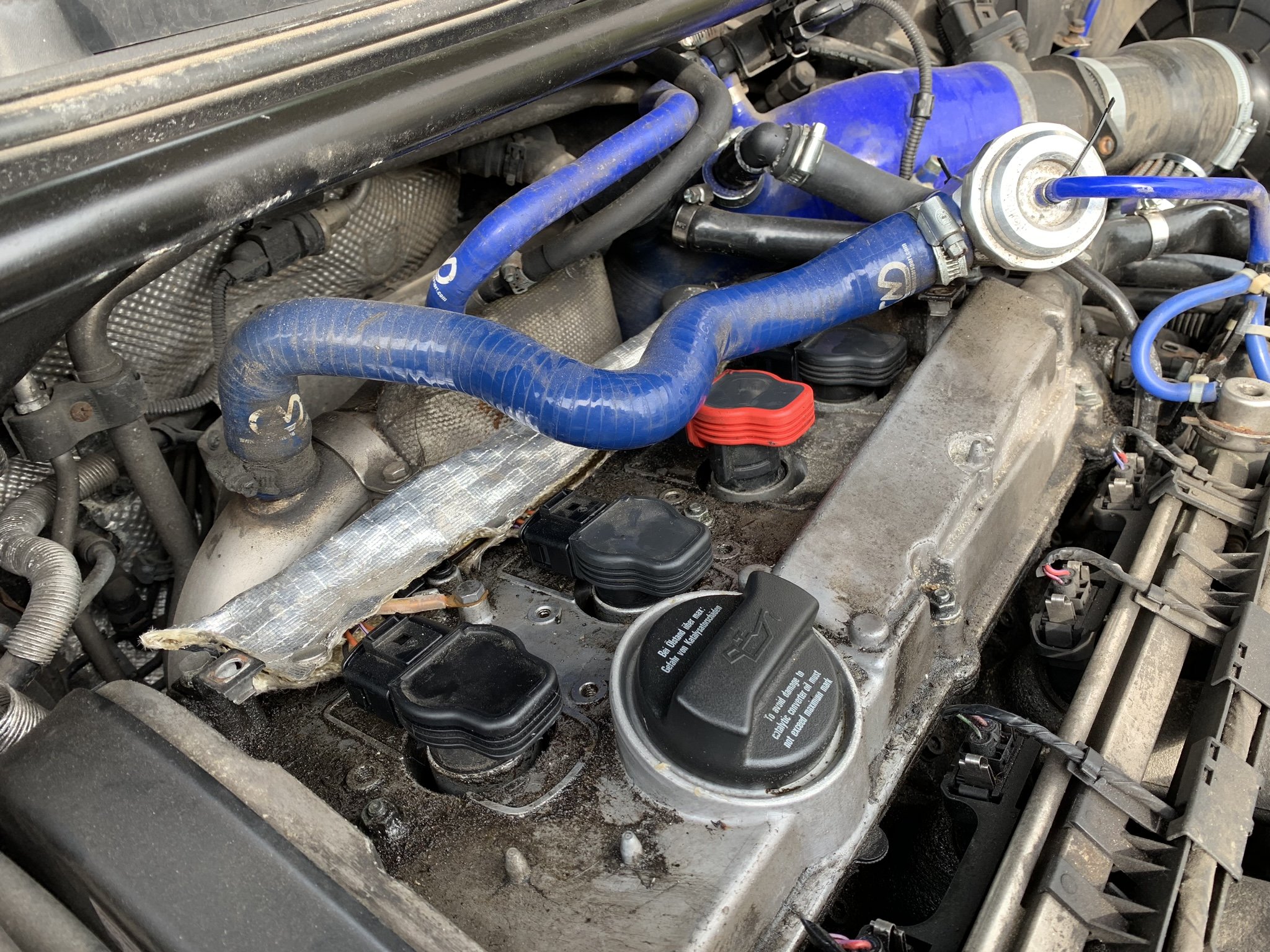

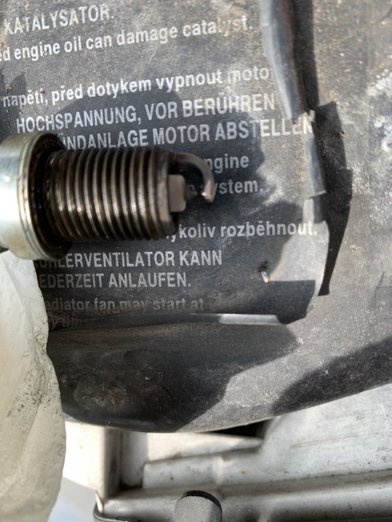

misfire today 😞 scanner says cylinder three , to be fair its only dropped one coil pack so far .... I was going to put new plugs in for the europe trip in sept, so may as well do that now...
old plugs look ok, seeing as they have been in 20k, and they are standard plugs running much more power and heat...

Down to my last two coil packs, and they are the stupid red top ones... "this isn't my engine, the coil packs are too short!!"
Question is , will it start! ? lol...
sounds good, think I've fixed it... need to drive it under load, but I'm taking the five to work tomorrow as its going to be sunny :)

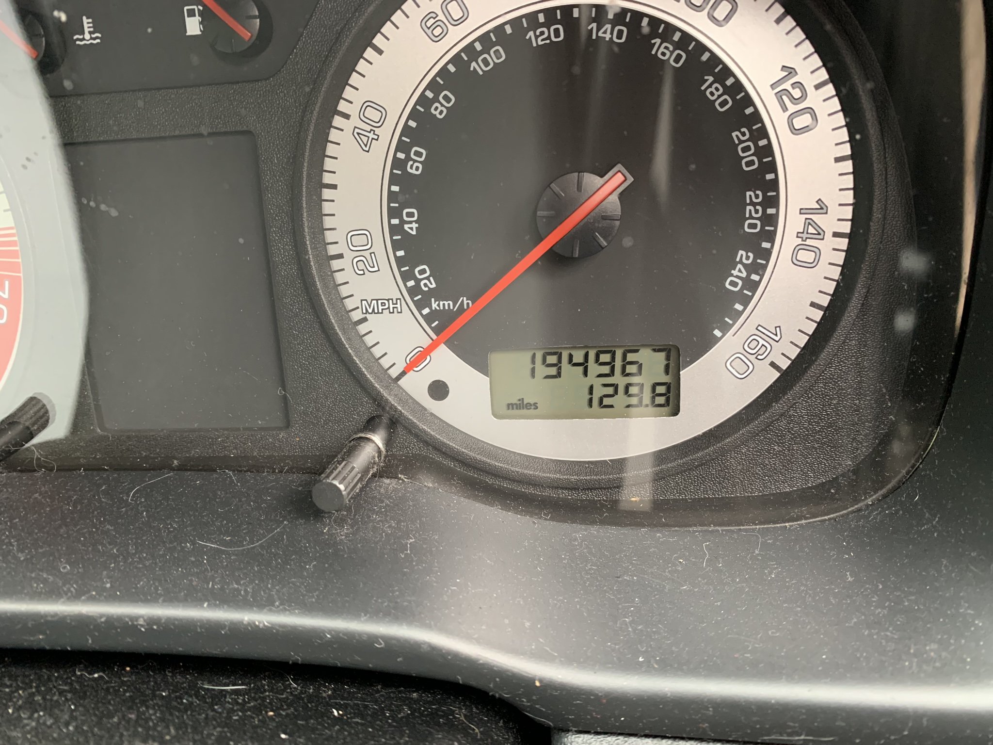

Right, oil change done, new oil pick up pipe installed, last one was in for 50k... it really wasn't bad, just one small piece of debris in it! Mech did say the sump was full of carbon deposits though, so he cleaned the sump up to fresh new looking aluminium.... just in case some deposits came off and headed for the pick up pipe! just goes to show what extra maintenance is needed as you approach 200k! lol.... happy its prepared to head out on its 3,000 mile plus journey across Europe next week! 😮 Am I mad attempting this journey in an 18 year old vRS with nearly 200k on ? lol.... The breakdown companies seem to think so lol..... most wont cover over 10 years old, the rest wont cover over 15 years old! so got my work cut out.... the AA and the RAC will (at a cost!!) and one other I've never heard of.... funny, when it reaches 20 years old, I should be able to get classic insurance for it, then it will be easy!!  Anyway.... shot of the current mileage, hope to see that 200k soon! 😮

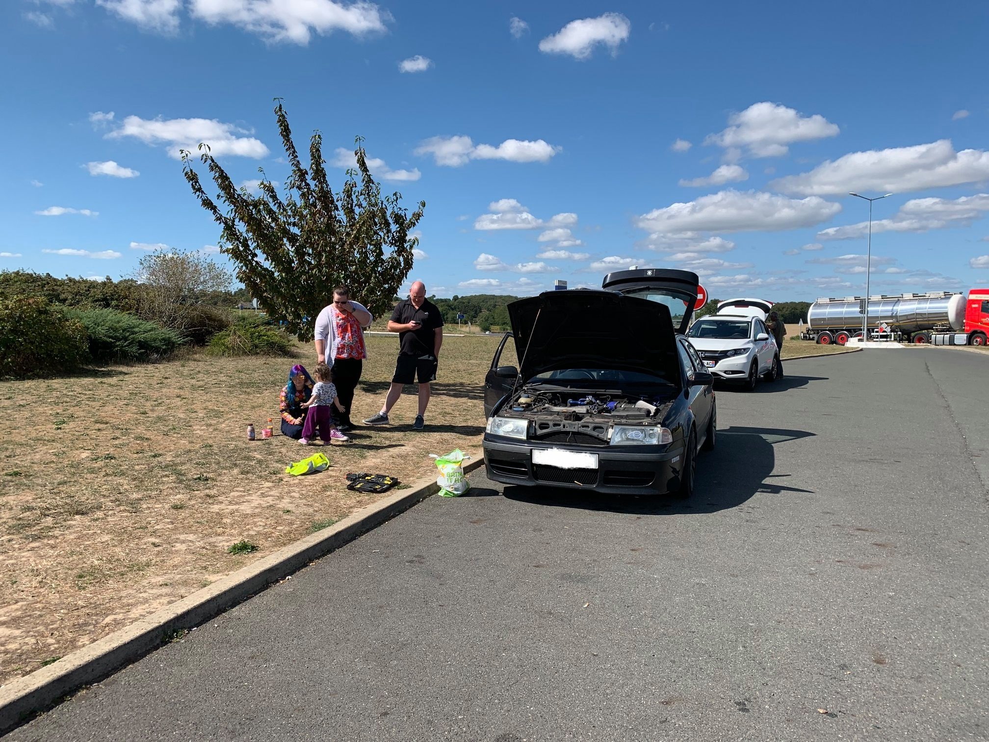

well, the road trip didn't go to plan.... car broke down half way to the south of France... I must say AA brakdown cover were BRILLIANT , worth every penny, i highly recommend them, put us up, towed the car, hired us a car we could continue our road trip in, and even drive back to the UK.... luckily my car got fixed before I had to return, shame I had to do the awesome alps roads in a ****e pergeot 2008 😞
Edited by sharkrider

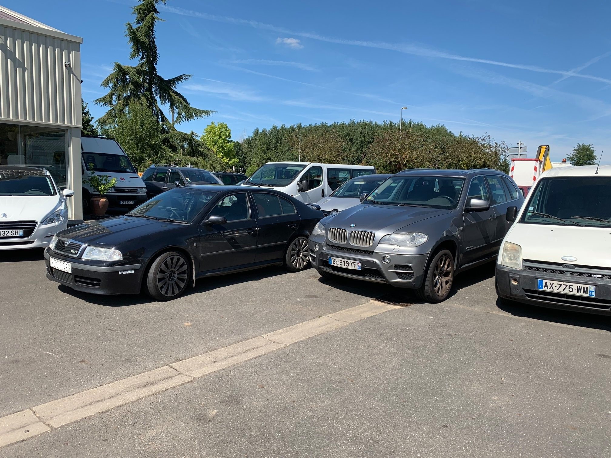

we were towed off the private french motorway by the police, and taken to a "garage" who had no time to look at the car ..... it sat for a while in a car graveyard, where things that broke down on the french motorway came to die, never to be recovered by the owners...
wait... whats this hiding in a backstreet french garage.....
She Rides!!!....... it was the crank sensor... replaced and fixed... french mechs knew their stuff.... sorted it for a reasonable price.... the car lives... and don't buy a pergeot 2008 , they are horrible... if someone offered me a choice between a £25k 2008 and my old octy, I'd have the octy ...

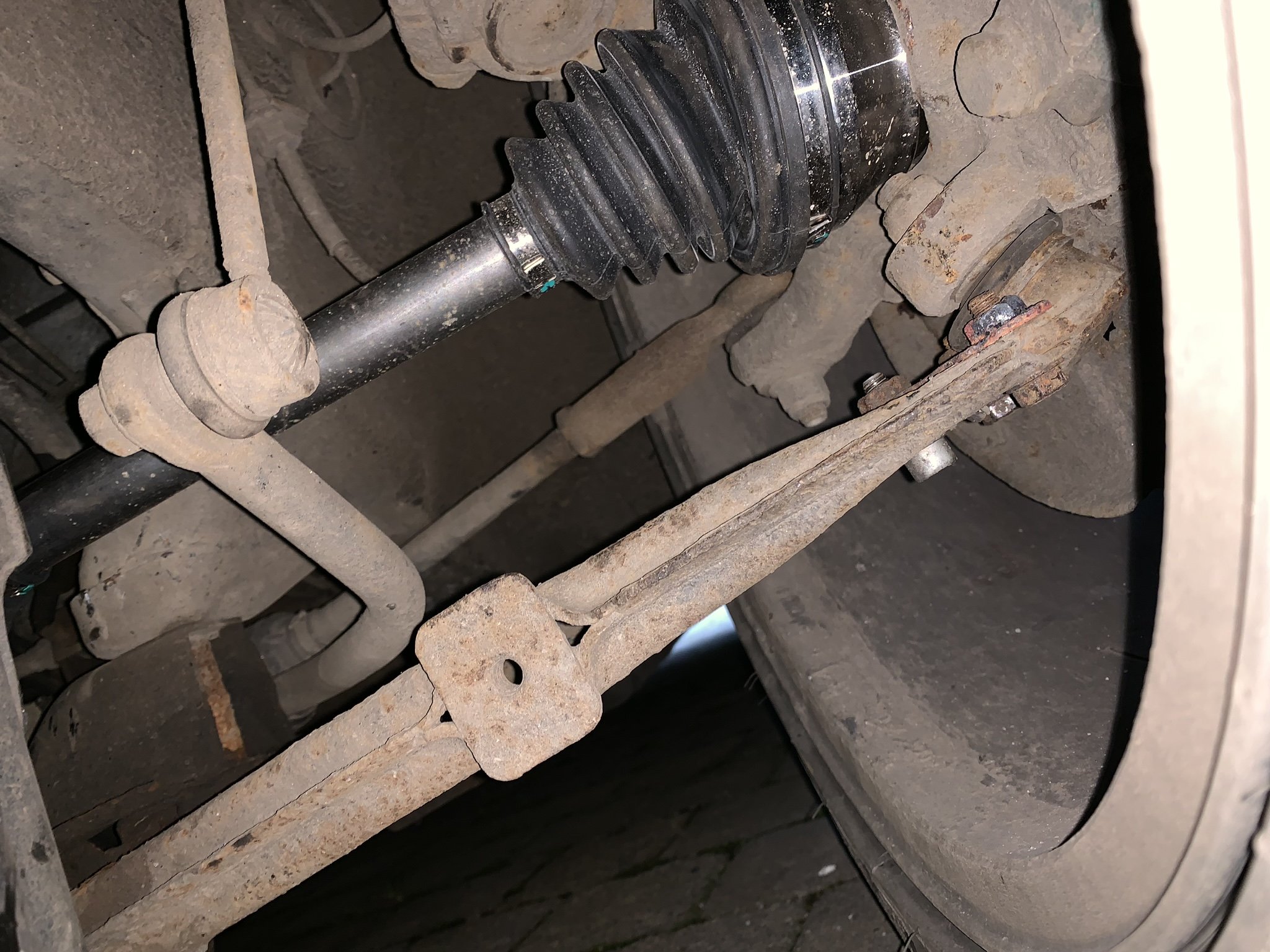

ok, further investigations result in it being a knackered driveshaft! getting it replaced next week :)
ok, car is fixed, new driveshaft in, oddly the guy says the rack is putting the shafts under massive pressure on full lock.... anyone else running the TT rack on their cars?
I got x2 driveshafts lol.... other one was apparently on its way out, both OE spec, and brand new, not reconditioned, tracking was checked, car is healthy again, i can cane it around :)
