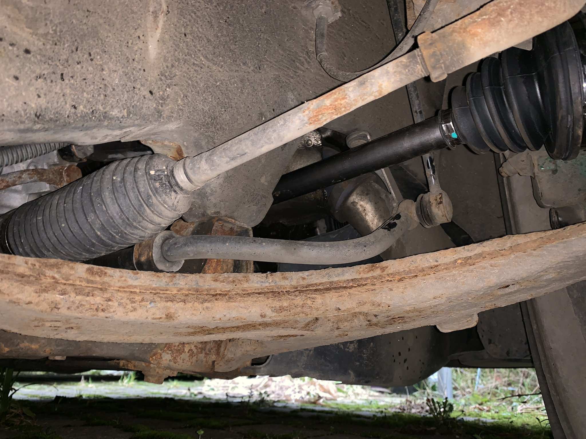

ok, car is fixed, new driveshaft in, oddly the guy says the rack is putting the shafts under massive pressure on full lock.... anyone else running the TT rack on their cars?
if you go for cupra cast arms, hubs etc it wouldn't put stress on your drive shaft
yeah, maybe next time they have to drill an ABS sensor out of the hub I'll scrap them and putt the cast arms/hubs on...

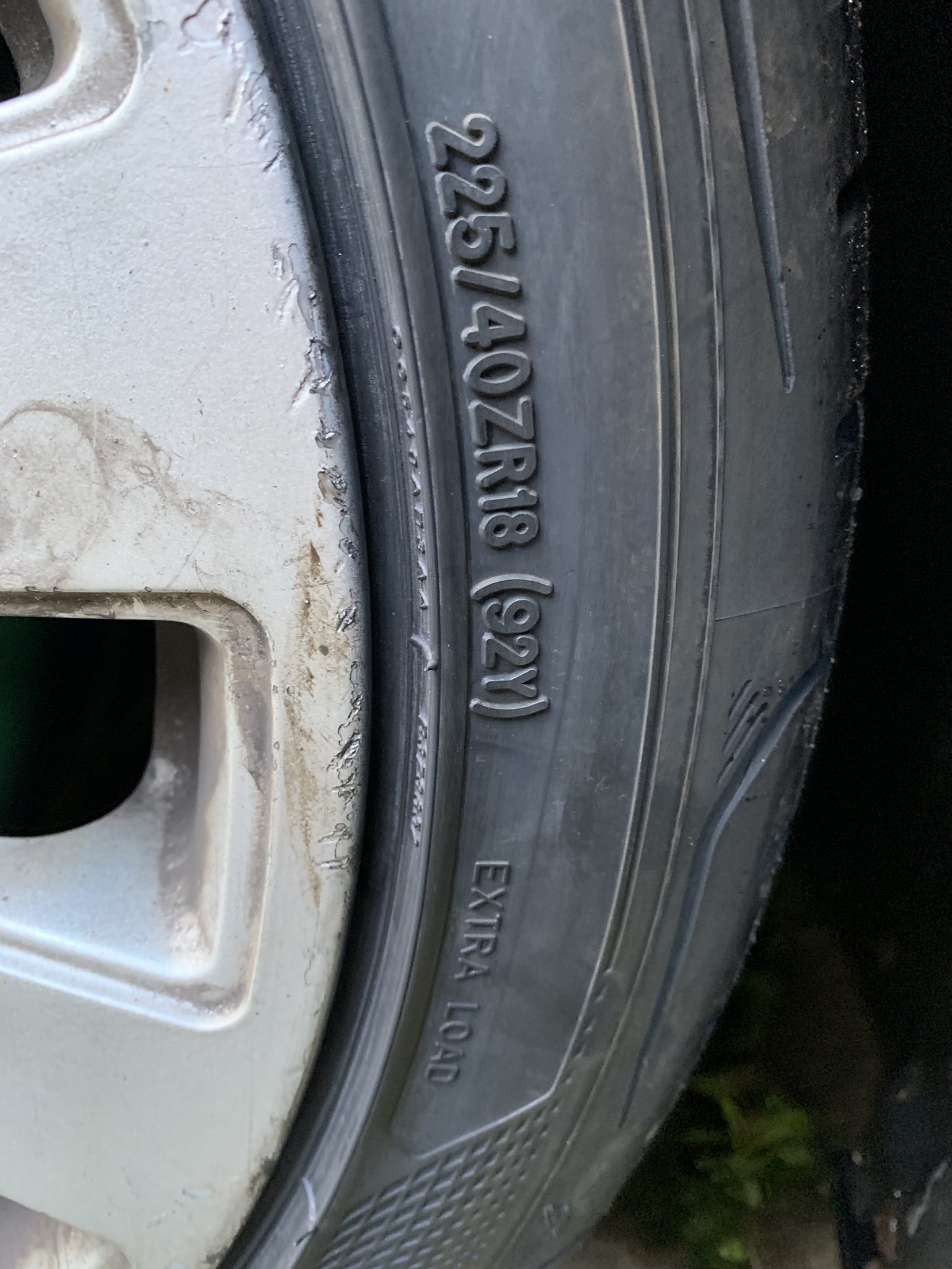

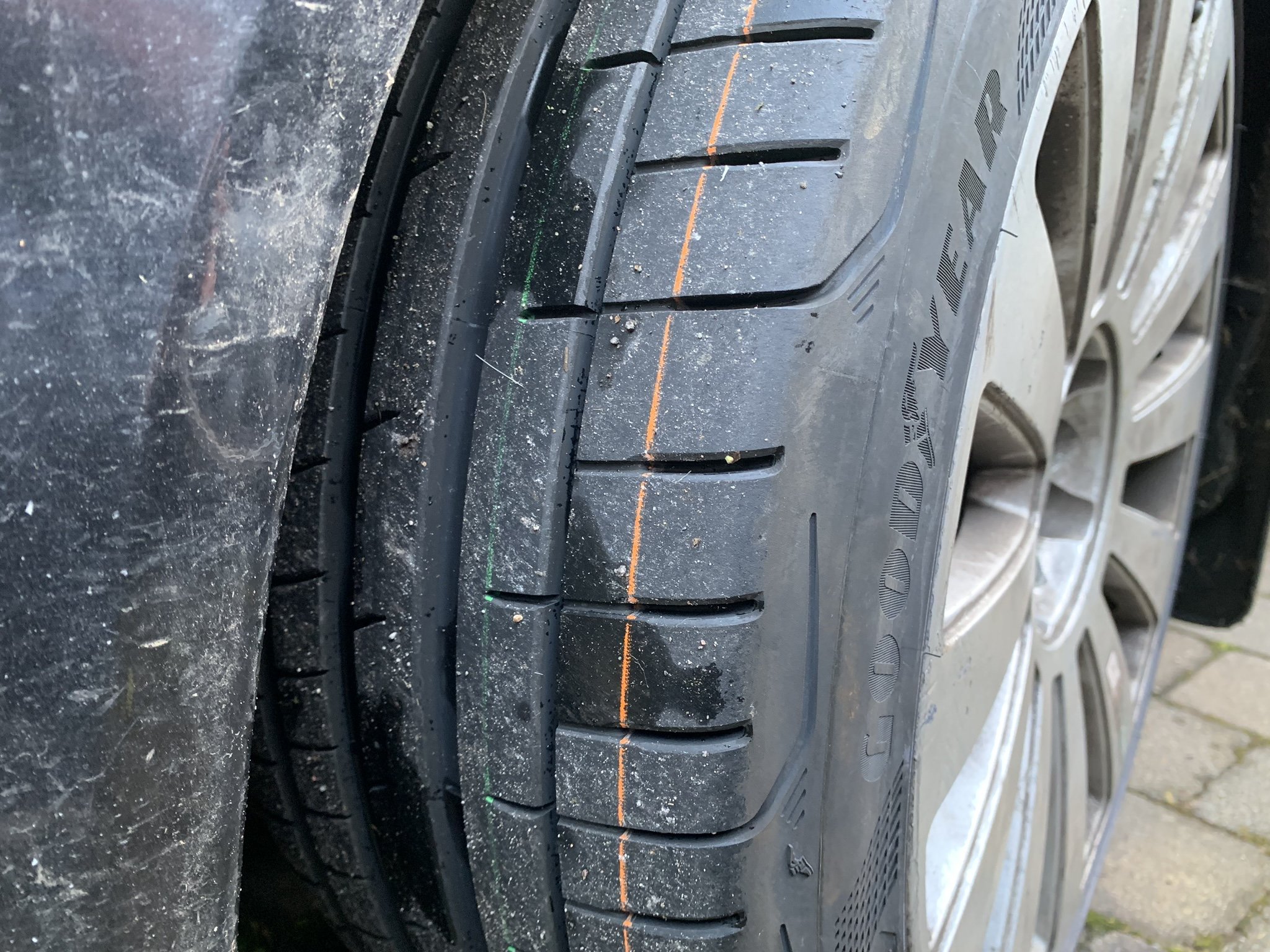

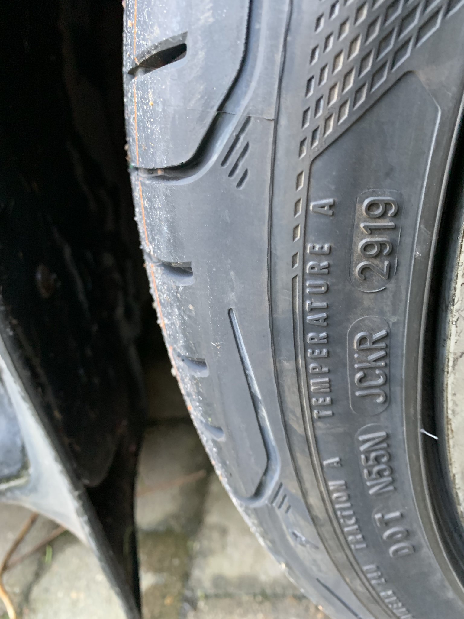

new boots time... goodyears, yes, but can you guess the model ?
92y extra load :) decent rim protectors seeing as they are on 9" wide wheels! the last tyres had a little stretch....
brand spanking new, as its a new tyre from them!

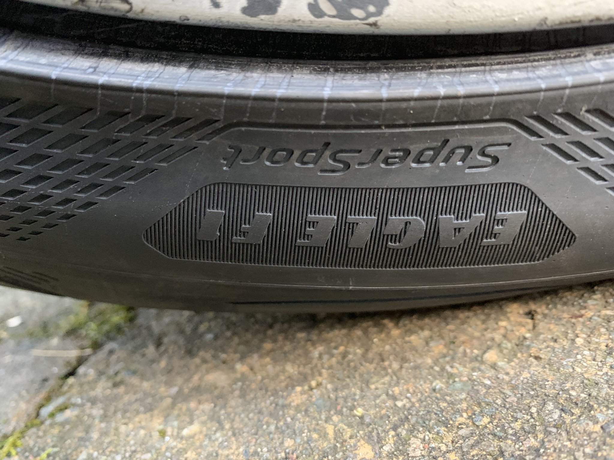

Eagle F1 SUPERSPORT .. according to the guy from tyre reviews, who tested it back to back against the "benchmark" michelin PS4S, it was exactly the same time round the track in the dry (in an M2 competition) and several seconds faster in the wet... win win, especially as it was £20 each cheaper than the michelin supersports it replaced, and very hard sidewalls to, specifically to improve track performance —
look forward to the opinions after you put some miles on them :)
done a bit now... definatley as good as the michelin pilot supersports in the dry, and miles better in the wet, a step up really, a track tyre that will stand up to lap after lap, yet let you drive to work in the pouring rain.... technology is moving on!

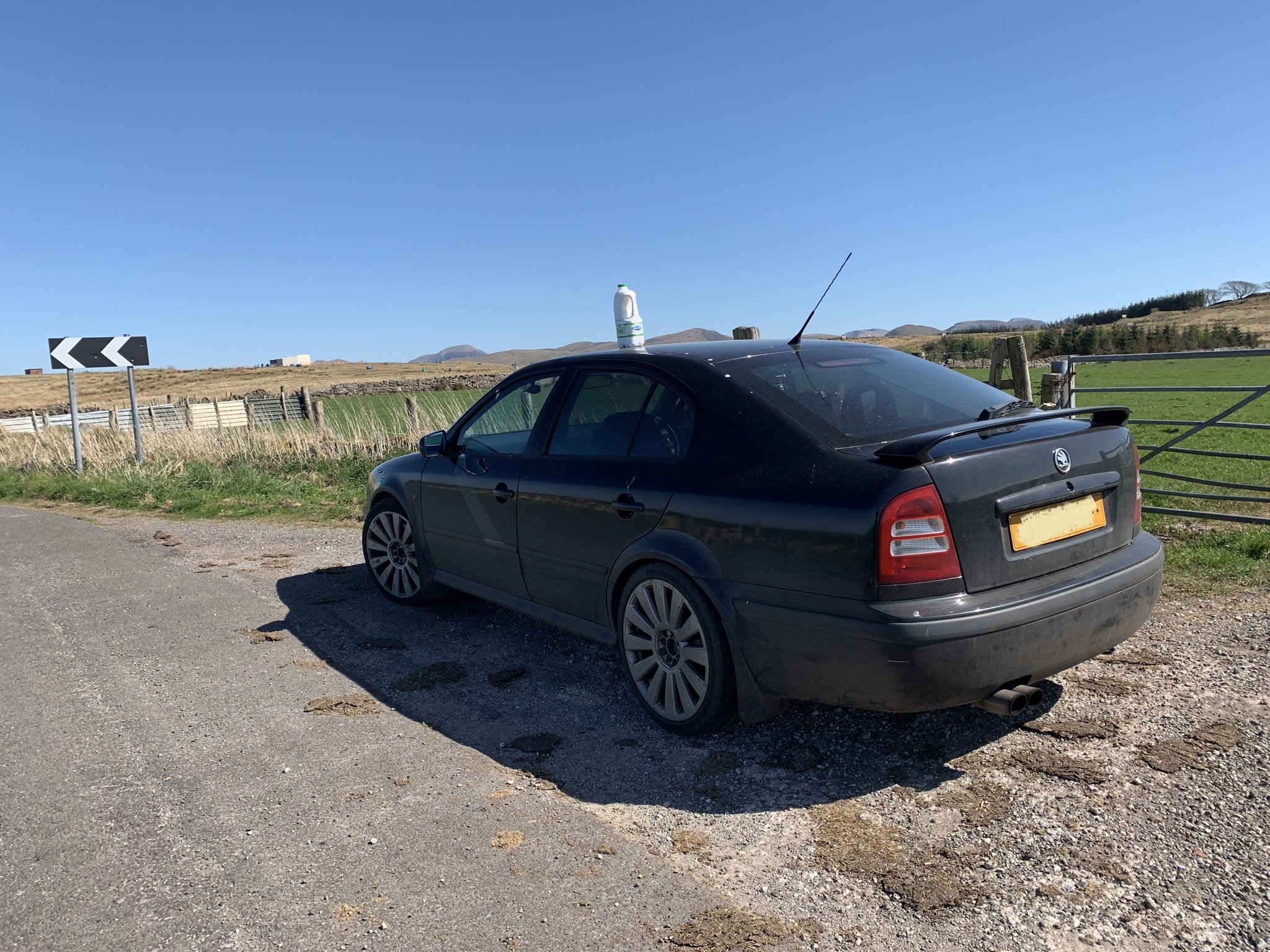

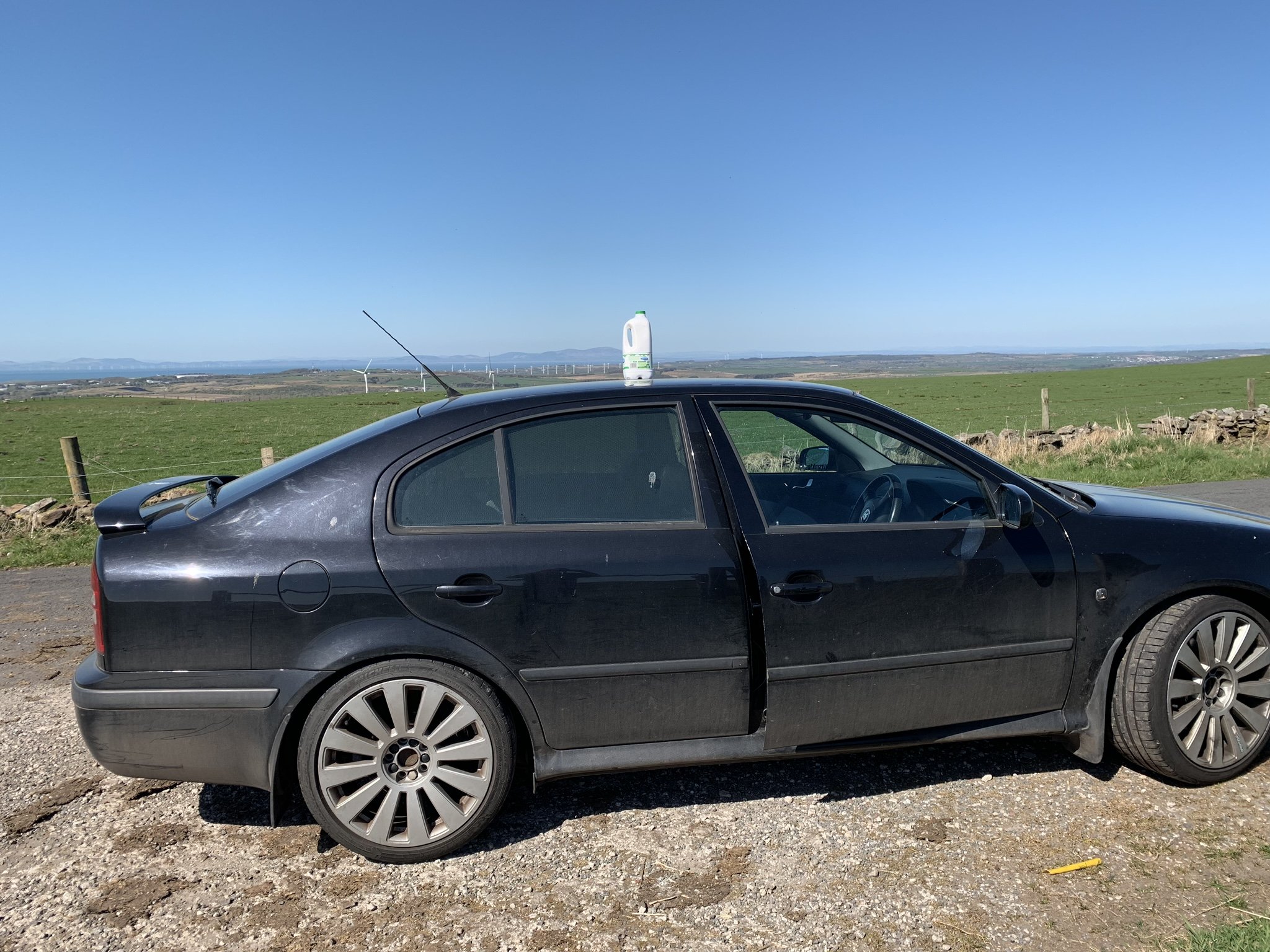

Anyone else manage to get out of prison in their cars?! I was obviously going for essentials, hence the milk :) shame we live in such a nice spot of the world! lol...
No need to milk the cow directly supermarkets will get the farmer to do it for you.:tongueout:

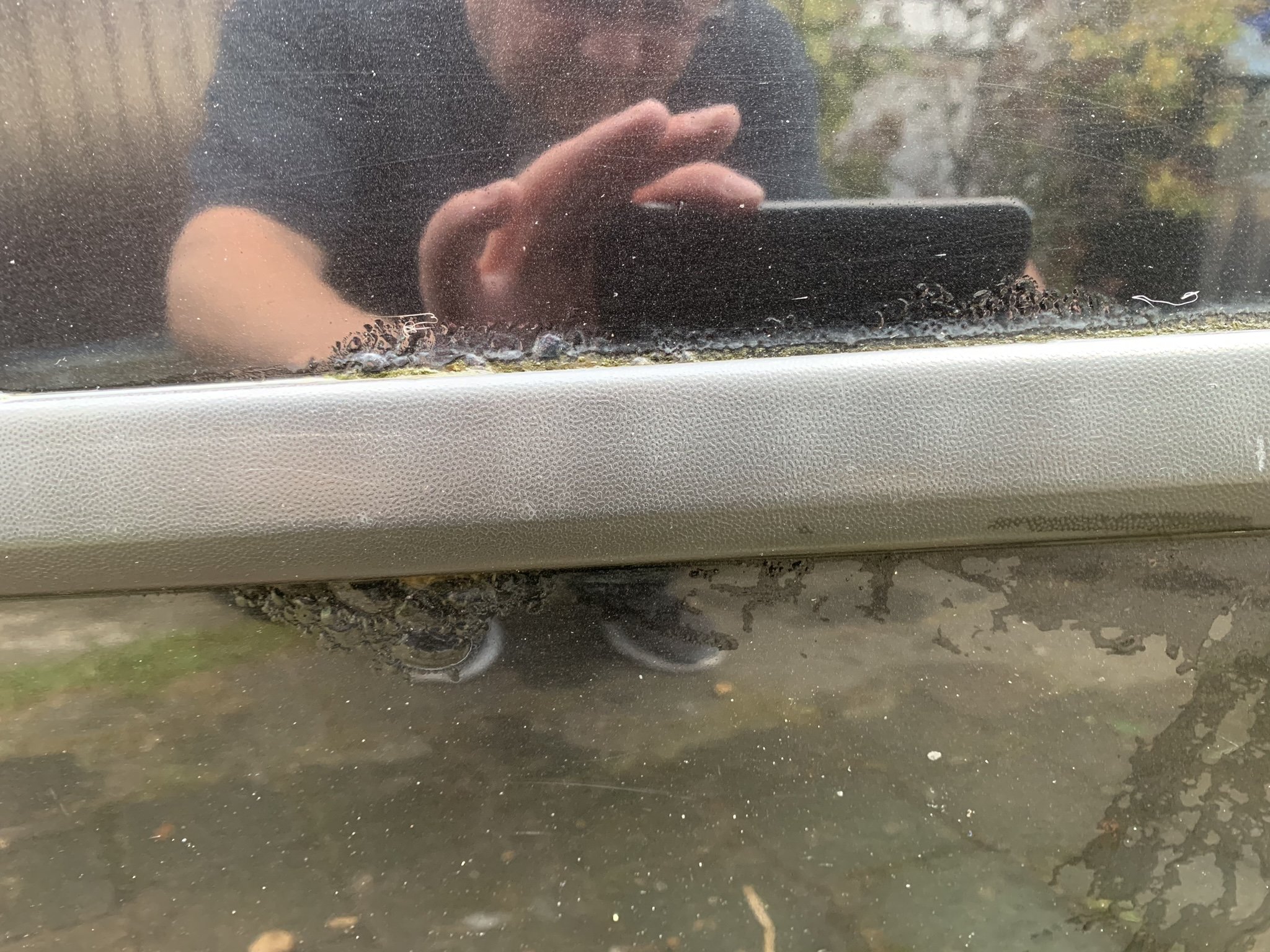

cleaned the octy this morning, cleans up well for an old girl...
unfortunately I found rust! 😮 must have got water stuck behind the strip...

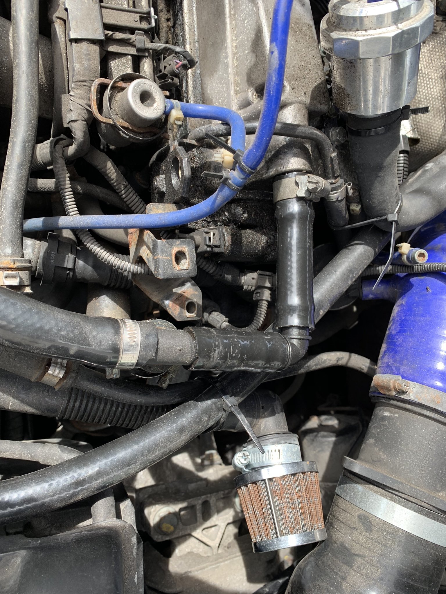

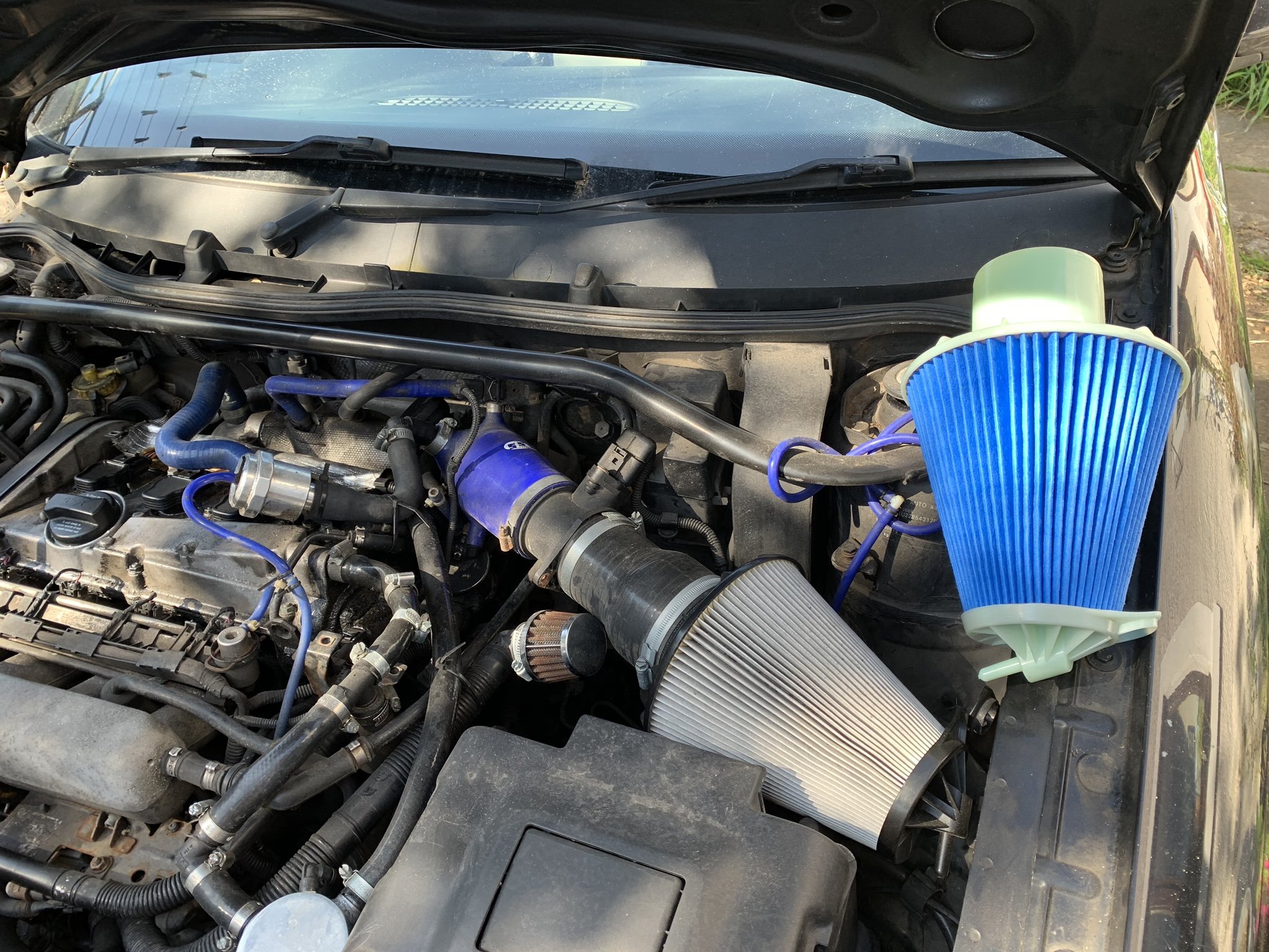

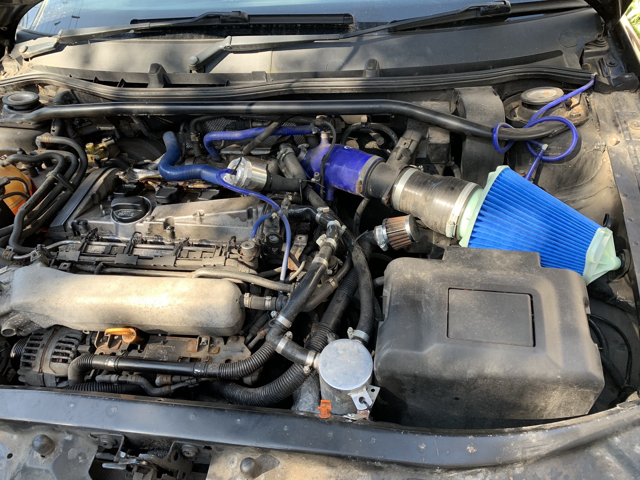

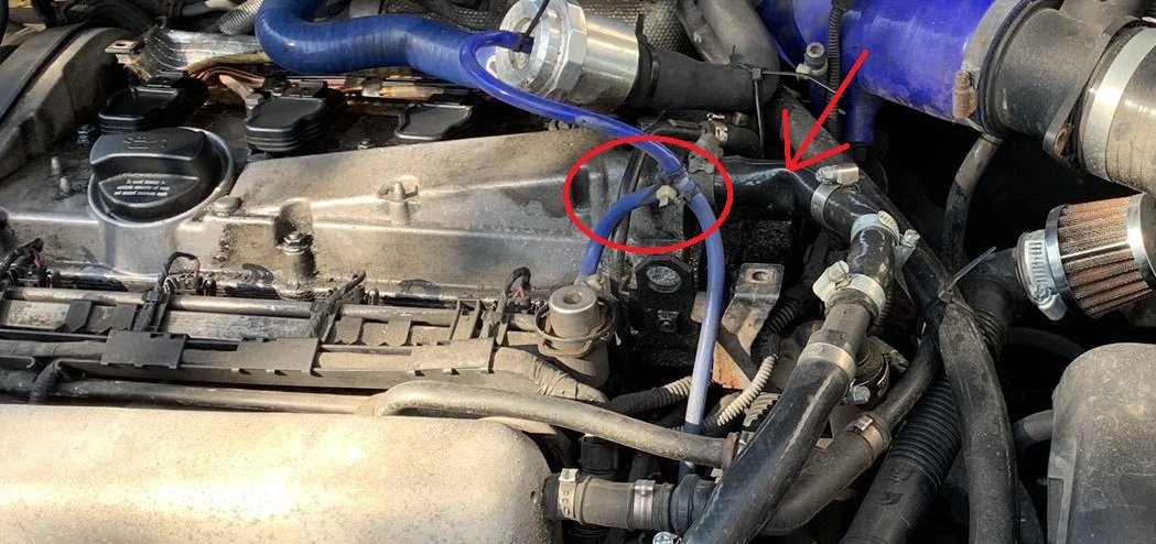

Looks like you could do to sort a couple of things under there mate.
Not ideal having the fuel regulator working off a t from the recirc valve, that could very much interfere with fuel pressure, particularly if the valve ever leaks. Best the reg has it's own pipe.
Also, that kink in the pipe going to your catch can is not favourable. These engines get unhappy with restrictions in the pcv system. When I had my yellow Octavia, I used too narrow diametre pipework for a catch can and it caused to to go through oil very quickly and blow massive clouds of smoke on overrun. Get an appropriately angled joiner on there.
Yes agreed. That was a temp repair when the boost gauge broke in Germany at the ring... I need to redo the boost gauge, also   I need hose thats up to the job for the breather system, so all that catch can set-up needs new hose....  the DV is piped in in a convoluted way because I had to repair the oversize TIP... and I have my secondary air intake mapped out, however I still have the hardware in , and need to remove it all! lol.... its functional and works though, running perfect... but I understand the failings.... I like all the work you've managed to do on yours while off work, unfortunately I can only bend under the bonnet for minutes before my back becomes untolerable 😞  I will get round to it though!!!!! watch this space! ;) Really enjoyed driving it in the hot and dry today, the goodyear supersport tyres are a revelation.

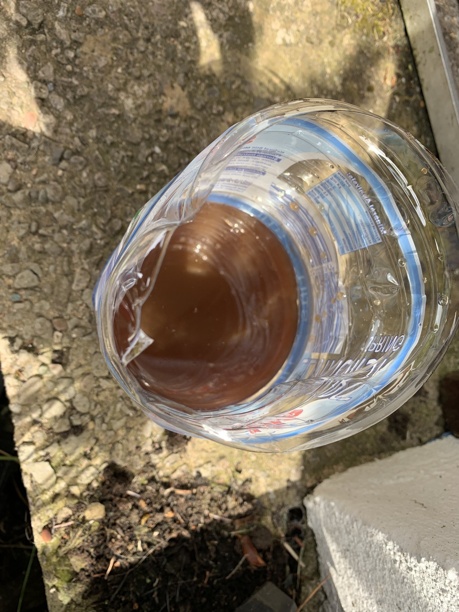

never fails to suprise me what comes out of the catch can! 😮
redone the breather pipe as Haydn suggested.... better flow there now...  for other peoples info too, it used to use a fair bit of oil (about a litre every 3,000 miles or so...) now uses virtually none...
