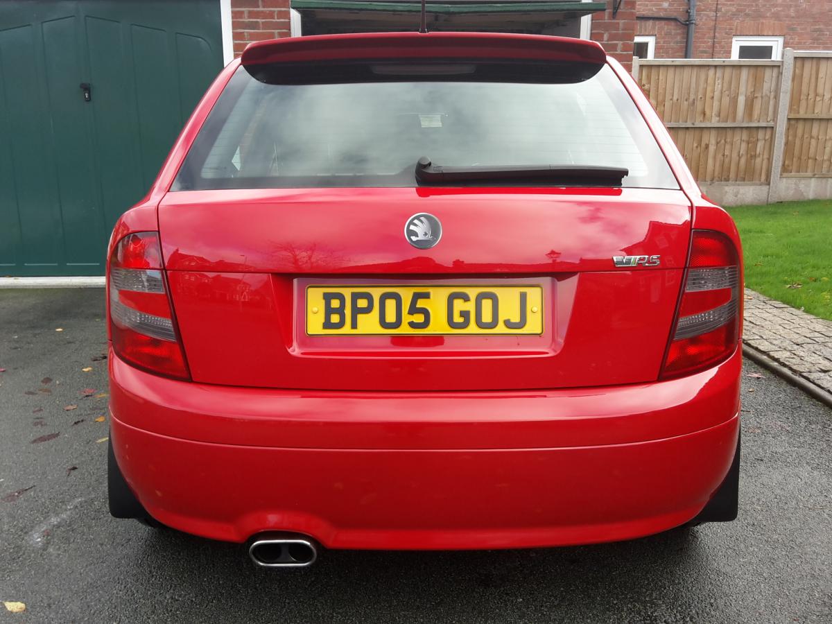

I can recommend a nice cheap mod for you to do now to match your darker alloys ;)
A nice light tint on the now very white looking part of you rear light clusters :)
Look much better imo :)
Cheers mate. Will look into it. Cheap sounds good to me!
What are those lights tinted with Kev?
The lightest tint vinyl I could find on EBAY :)
Just done the clear part of the rear clusters with it.
i think i quite like it, plus i've always had red and tinted rear lights on all my cars - Punto, RST etc. so i might look into getting some.
Was it easy to trim to shape?
I cut a square piece over size for the clear part of lights,put it on then cut around the clear part with a stanley knife blade :)
