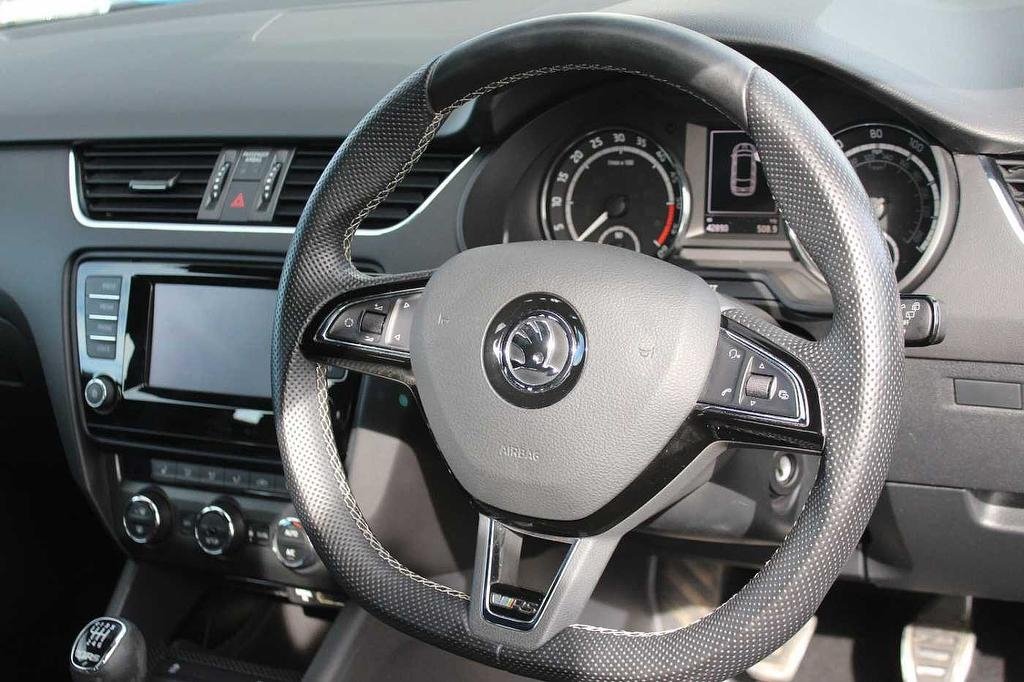

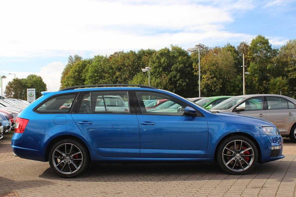

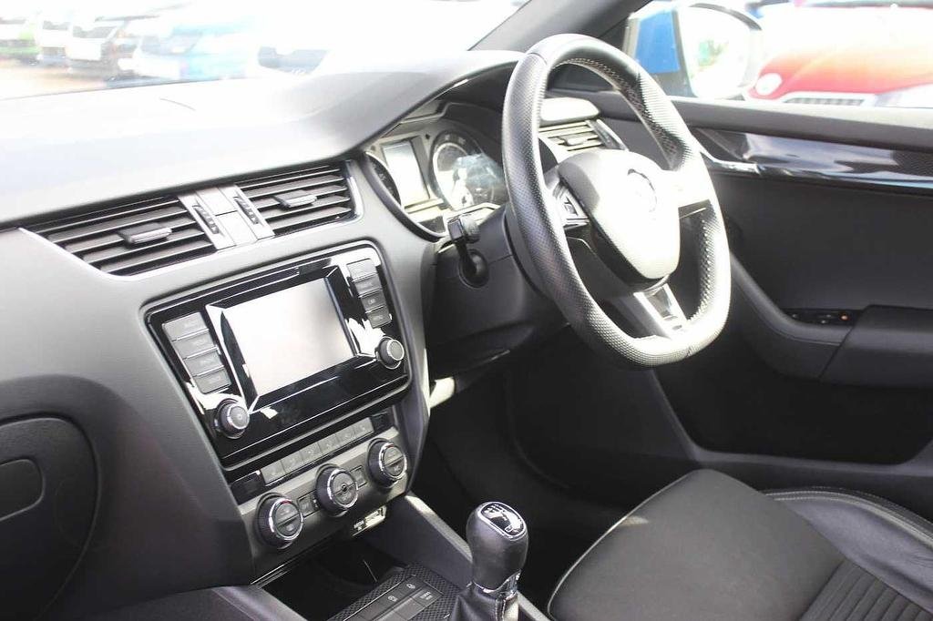

Just a small upgrade to the fabia's bigger brother!
Picking up a 2015 Mk3 Octavia Estate VRS 184 TDI with 42k on the clock on Thursday.  Going to be a hell of a change from the little fab for sure!
