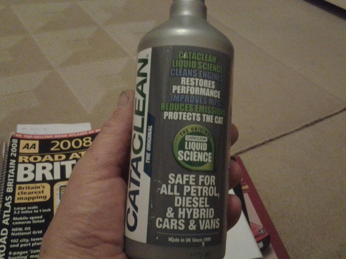

No dizzy cap on the MPI gary......so.what did I buy ?....plugs, oil, oil filter, air filter and a bottle of cat clean...£53in total including £17.50 for the cat clean......nice to know iam not thd only one outside, heavy rain here in south bucks so going to have a lazy afternoon indoors and get out there tomorrow......

Just curious, what does the "cat cleaner" promise to solve, how, and how fast?

"Cataclean" promises to......clean engine, restore performance, improve MPG and protect the cat.
I need to add it to15 litres of fuel.i think iam right in saying my pick up has a 42 litre tank so about 1/3 tank.or about half on the gauge as the second half never lasts as long as the first......or is that just me ?
400 ish mile round trip tomorrow is now happening so a good chance to try this stuff out, I have a infrared temperature device as used in the video, if I can find a battery I will do a before and after test on the cat....dont fully understand why the cat should be hotter on the end furthest from the engine though....

The videos: while I don't endorse any method or product in those videos, I am amazed to what lengths people are capable to go ignoring basic physics and chemistry. All in the name of comodity. Put that magic liquid in there and poof! we don't need any repair. Metal wear is reversed, bad gaskets get magically repaired, cats perform as in day one, bla bla.
About Cataclean: when I read "Liquid Science" I instantly know the product fills in the Marketing Bull$hit category. Other times you read "3D nanoparticles", "ultra", "FX", etc. All are very secret and SF. Oh, and very expensive. To my knowledge the effects are marginal at best, subjective or pure coincidental. You will NEVER see a product advertising saying "The value of X parameter will decrease/increase from value Y to value Z". All is relative, like "up to 100% efficiency". If you don't get the promised result, the customer is to blame because he didn't follow the instructions. Or he didn't buy enough. Yeah... I stop my rant here. But your cat is fine. Probably it meows too.
