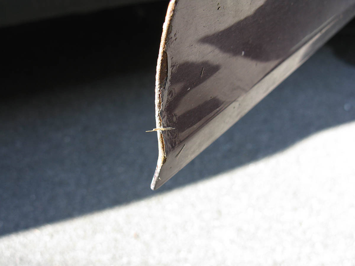

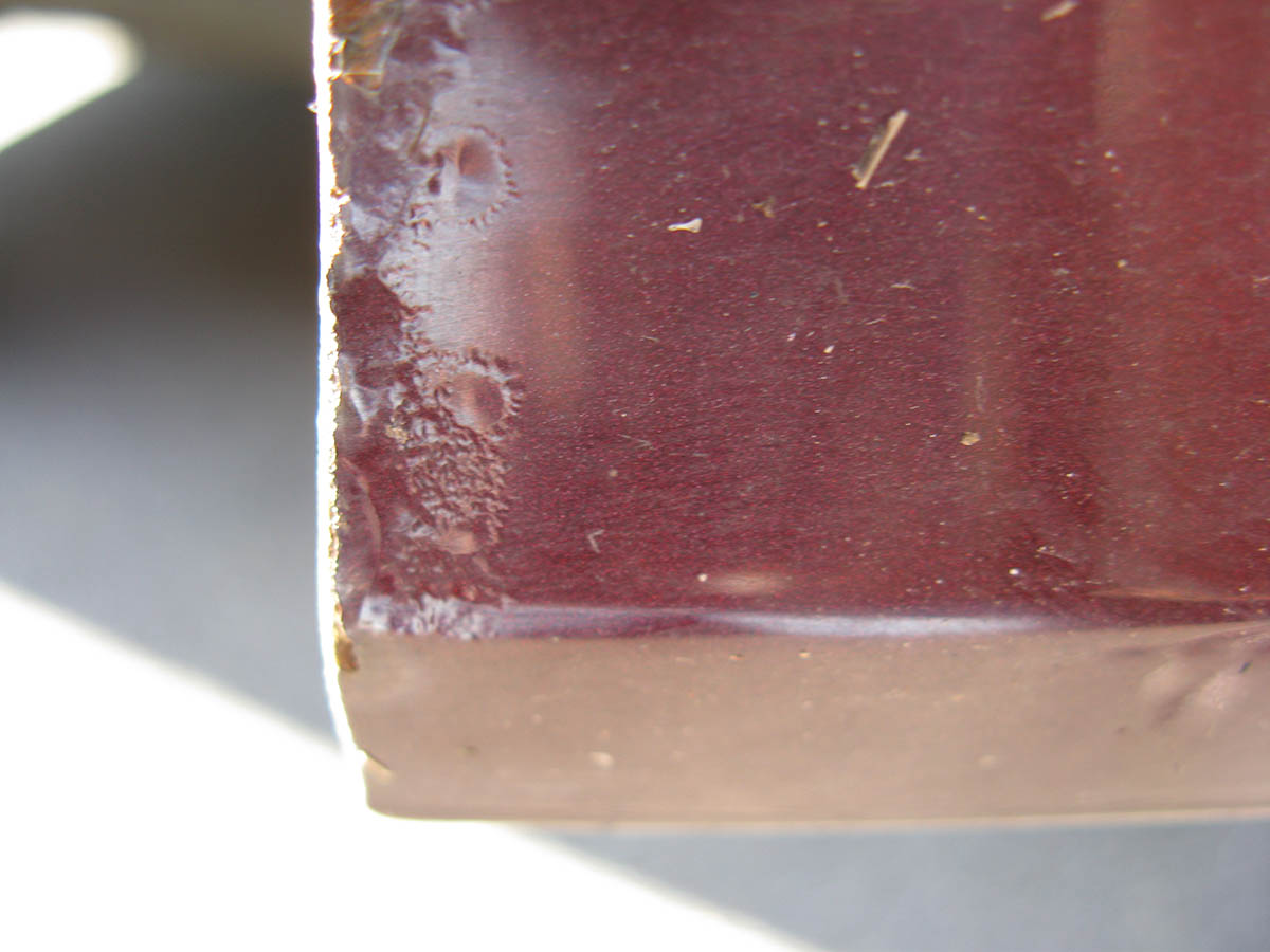

MY12 Yeti was previously owned. When I showed the dealership my rear edge door rot (call it RUST or whatever), they thought the paint had come off opening the door into something! This is the problem trying to get something done about a problem you never had on other cars - too many get outs!
Is this the kind of metal rot (rust) on the rear of the front doors you are talking about? If there is any doubt about whether it is coating, plating or rust, you can clearly see the bubbling bare metal is now brown, which is the ferric compound produced when steel corrodes and commonly known as 'rust'.
No, that is quite distinctly rust caused by the door edges being scuffed and not repaired.
That looks very like an extreme case of the paint being worn away with contact with the vertical rubber seal between the doors. More action is at the bottom as grit gravitates downwards!
I usually wipe the grit away asap, but as I'm weekly running on gravel roads all day, I've had to repair the lower edge before it spreads to the flat door panels. An aerosol and careful masking makes it invisible so far - 60k miles and more grit on yesterday, today and tomorrow!!! :devil:
