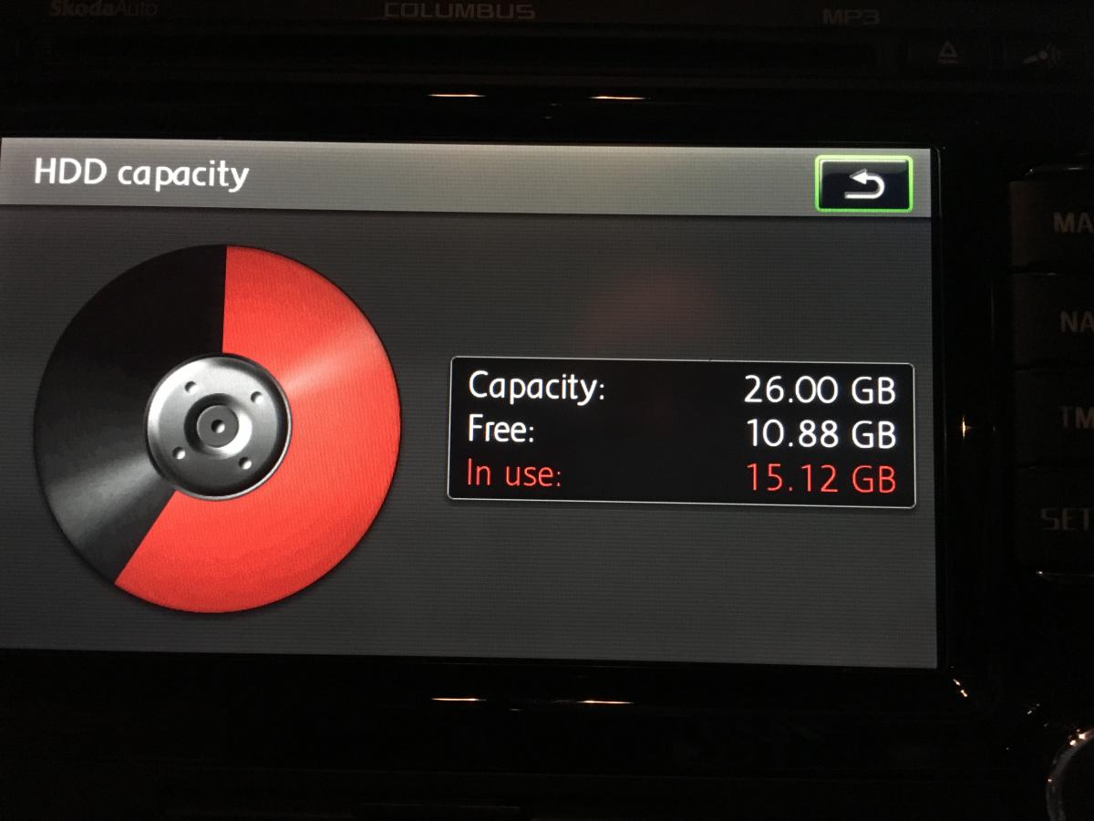

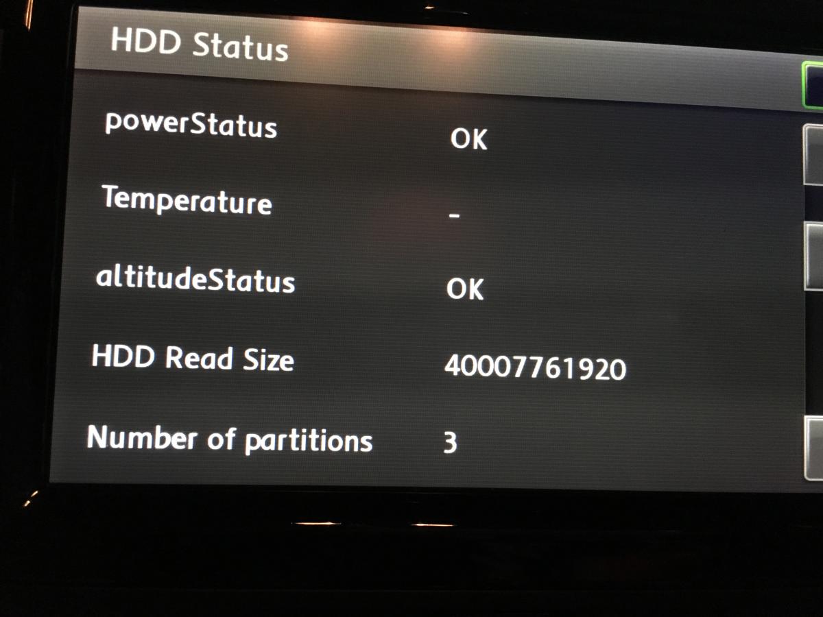

The later ones get more storage don't they?
Mine came with a 40gb HDD rather than the original 30gb and shows that I have 26gb for music when empty.
Well, yes, but it's more complicated than that really. The minimum is 18Gb from a 30Gb drive, then there's the 40Gb drives which give 26Gb, then the later ones again have 19Gb from a 32Gb SSD drive. Then there's the complications of upgraded firmwares, modified firmwares and suchlike which can make all sorts of different partitions. I just quote 18Gb as it's simpler.
