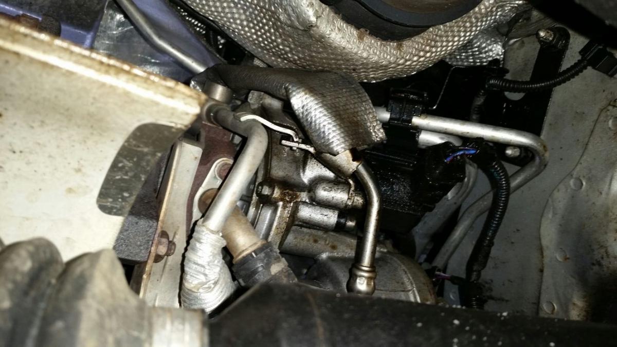

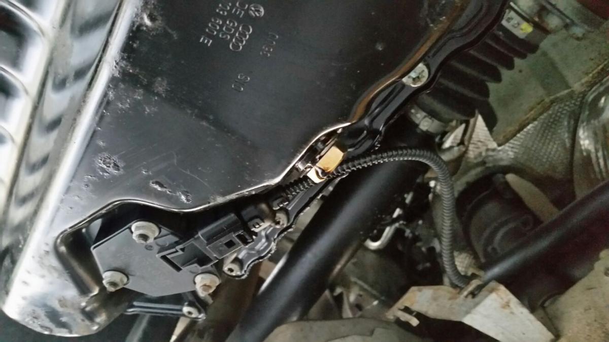

Just had the car up and the under tray off and it appears to be the sump plug bolt as said above.  In the time I was under (about an hour from jacking up, removing the tray and inspecting the engine bay) it dripped a good 5 times or more.  The top of the undertray (engine side) was very gunked up with stones and oil etc.
The bolt however looks very new, so it's either been replaced or they've stripped the threads and used a larger bolt. The oil was changed about 4k miles ago. Shall I just drain the oil, replace the sump bolt and put the oil back in, or just do a full oil change?
Also, out of curiosity, what is the sensor looking thing at the bottom, near the plug? Is it just the temp and level sensor?

If the sump plug hole has been stripped, you'll need to take the sump pan an engineering shop to get the thread repaired, or source a second hand pan from a breaker.  You could try fitting a 'helicoil' at home, but I wouldn't chance it.

That sump bolt looks crooked, so it's  a fair guess the thread is damaged in some way.

OK, it's definitely the oil plug.  It's obviously cross thread, so much so that you can actually see a gap between the sump pan and the washer.  How much would I be looking at to have new threads tapped? Or should I just not bother and get a new pan?
