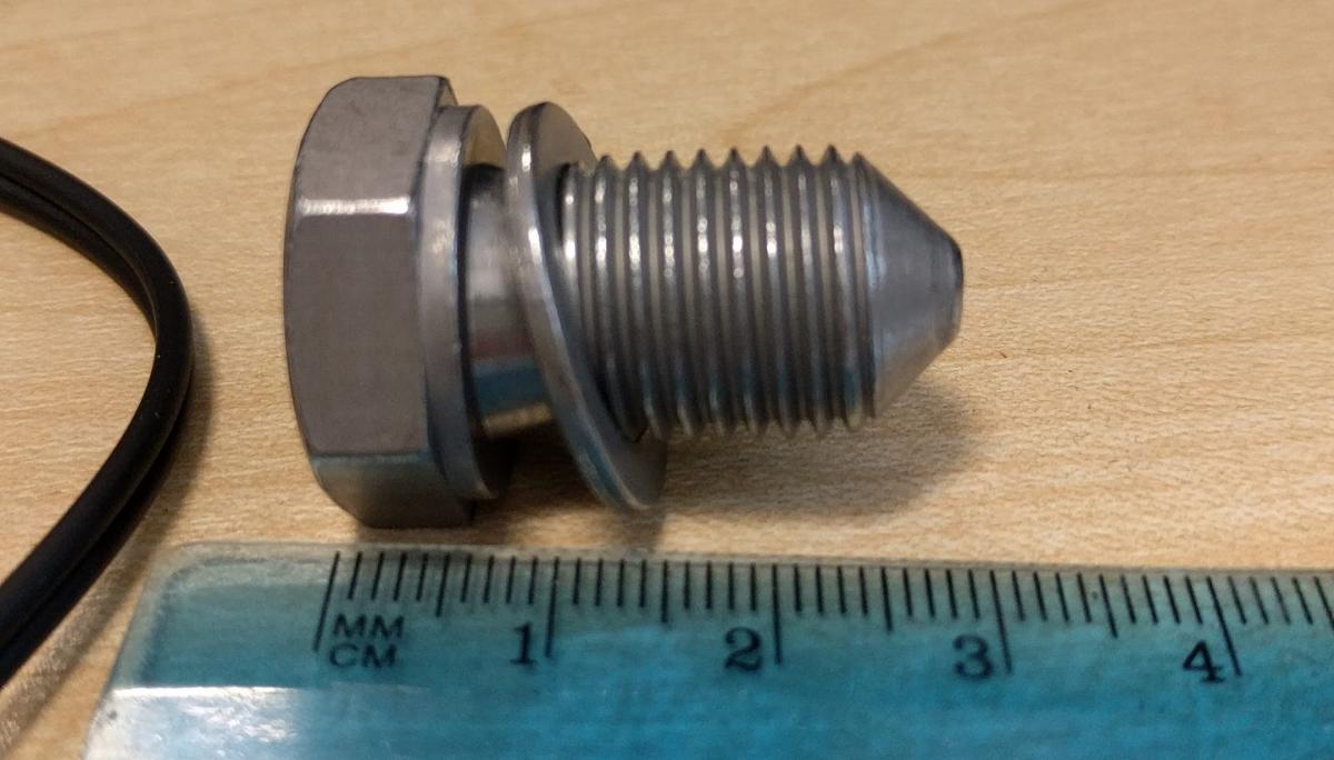

Just double checking this is the right bolt? I went to my local VW dealer for it.
That looks like the one i use on mine,mine is a TFSI though but im sure they are all the same.

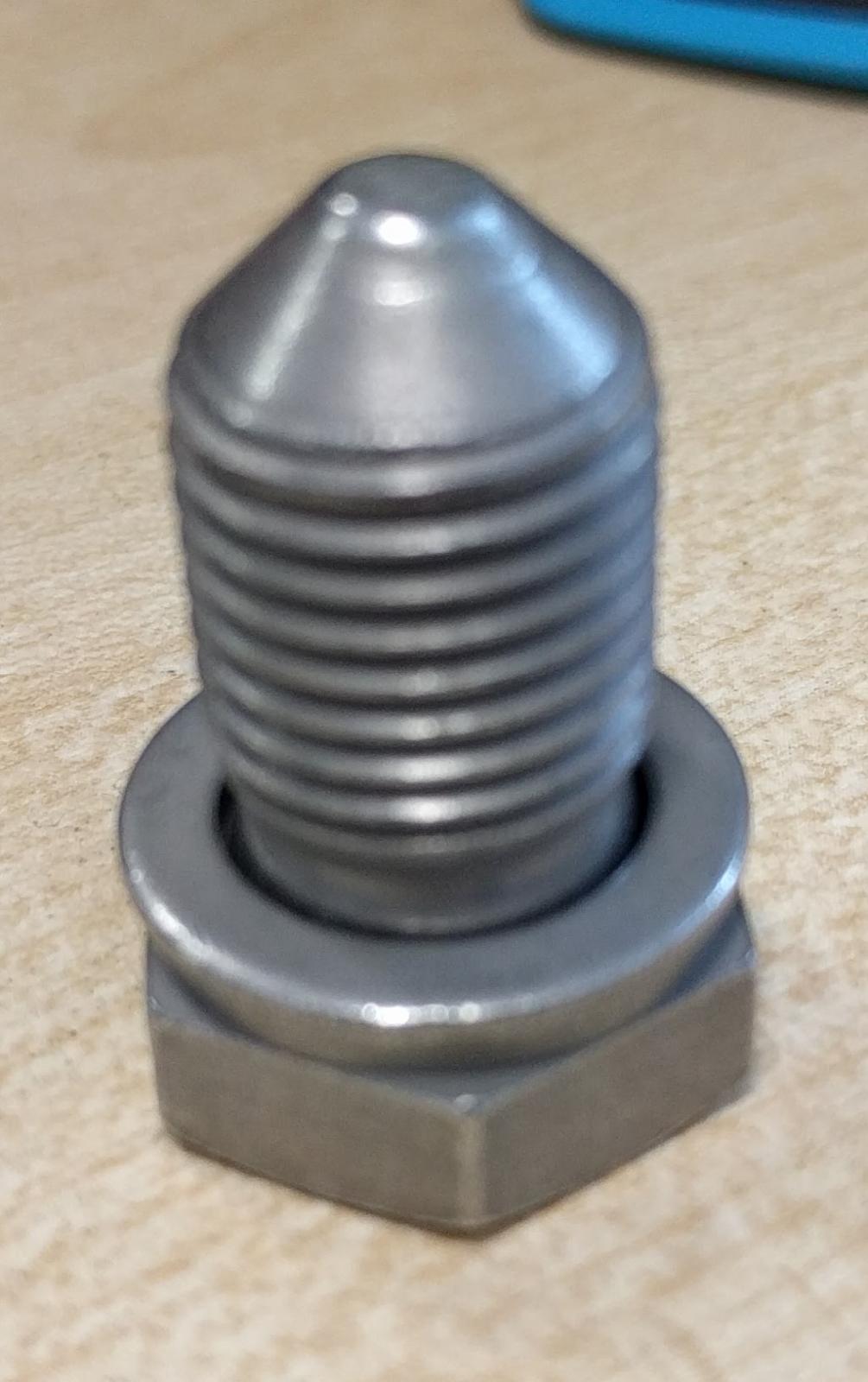

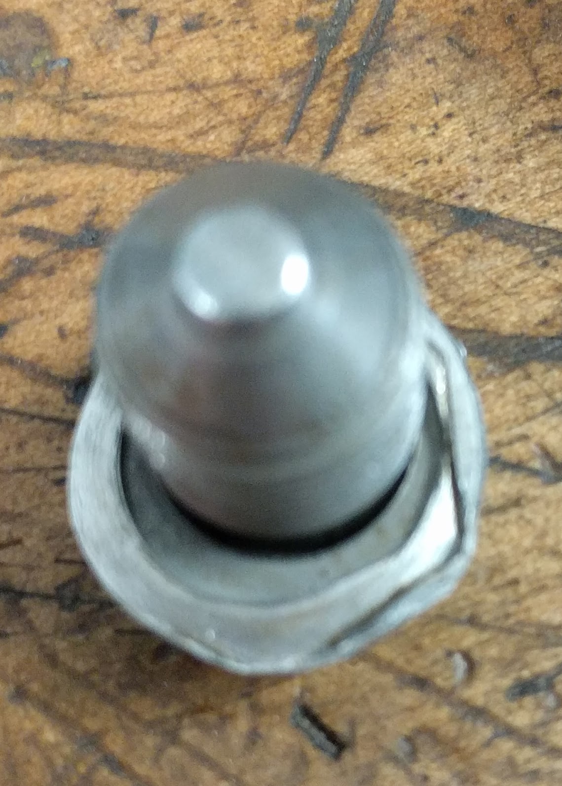

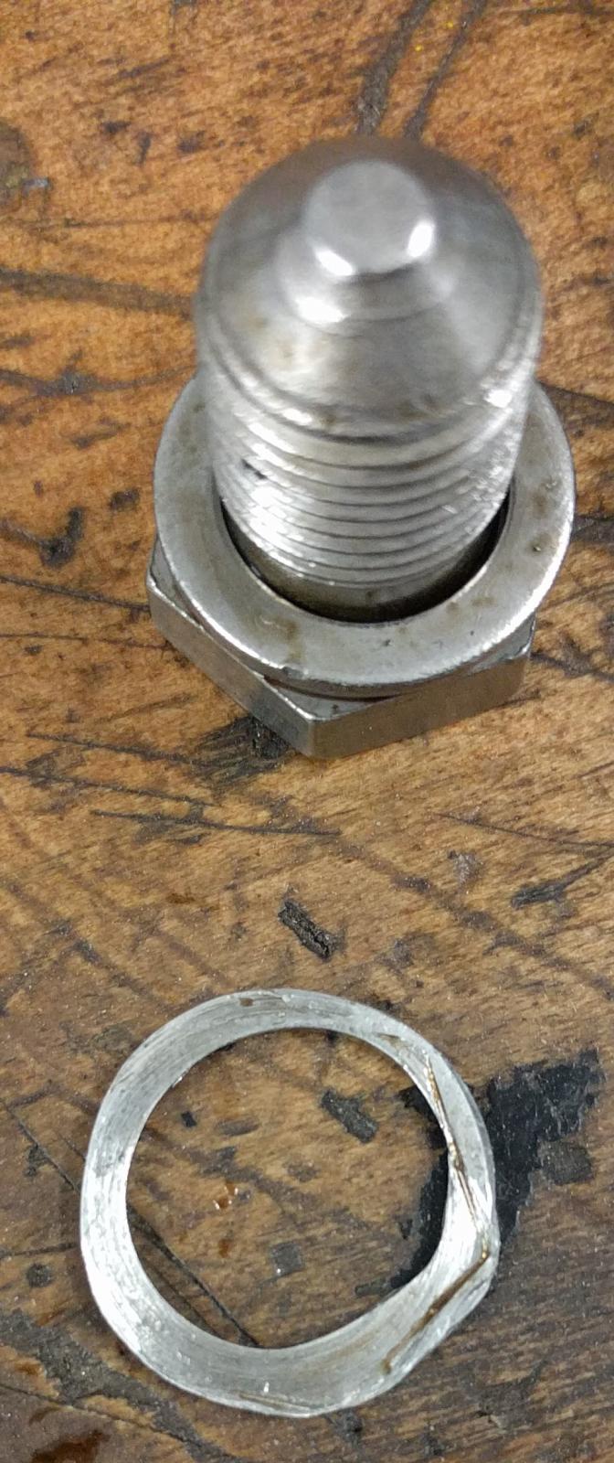

Anyways , update.  The new bolt has been purchased and when we went to fit it, it was clear the threads are damaged in the sump (likelihood is overtightened by a garage) and the one use washer had clearly been reused (see images). The new bolt, although the same thread and width as the old one, was a loose fit. Once the oil was completely drained and we could inspect the threads, it's clear they're damaged.
The two images show the washer on its own and fitted around the new bolt for comparison. I'm well aware these are designed to squish and distort to form a seal but it's clear this is well knackered.  New sump pan it is :(

Wow!! Grossly overtightened, that's a steel washer too iirc. The KKB plug I am holding at the moment has a round shoulder under the hex head, so it looks as if that one in the picture is not an oe part
Unless you think your collegue did that then I really think you should definitely name and shame the garage to protect our members in the area!
