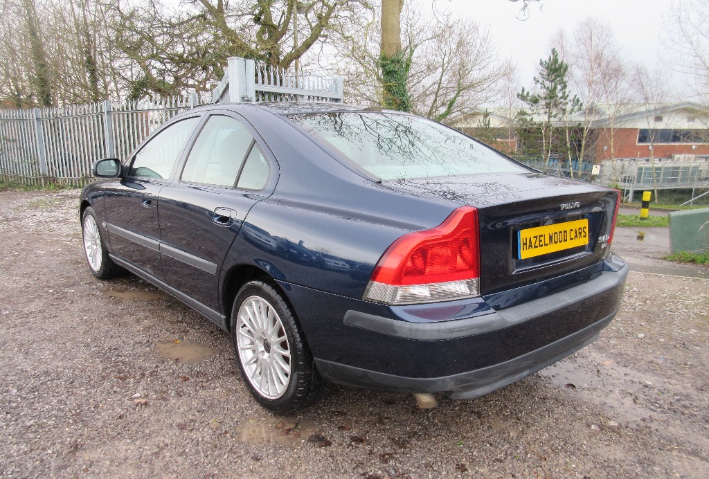

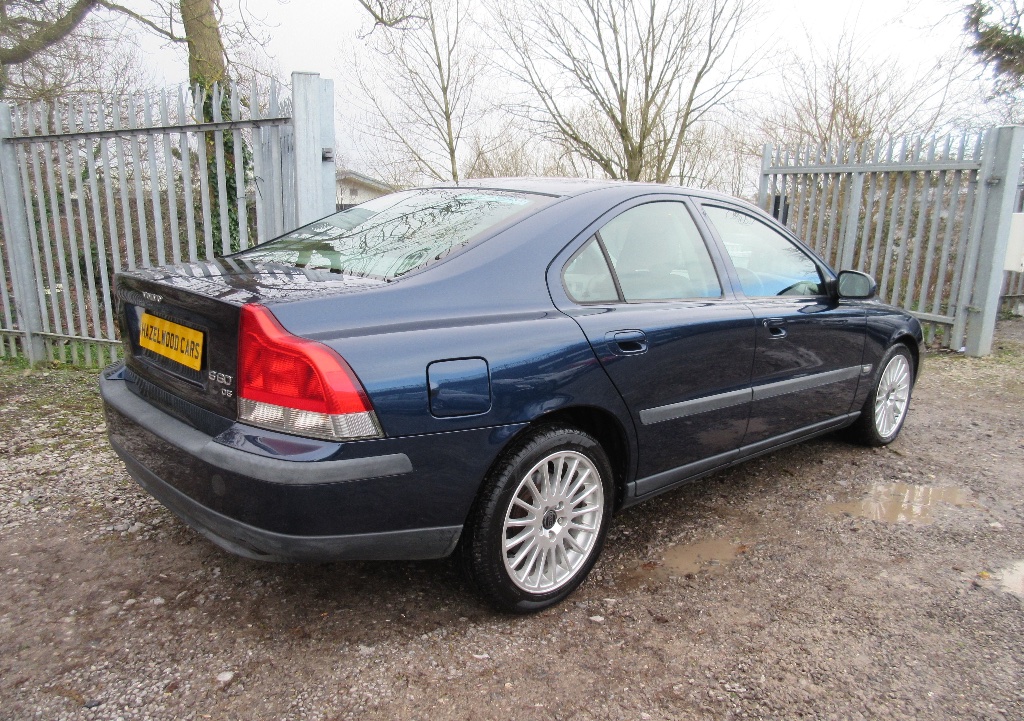

Here are the dealer photos, not got any good ones yet taken by me.
Edited by mannyo
And a few more,

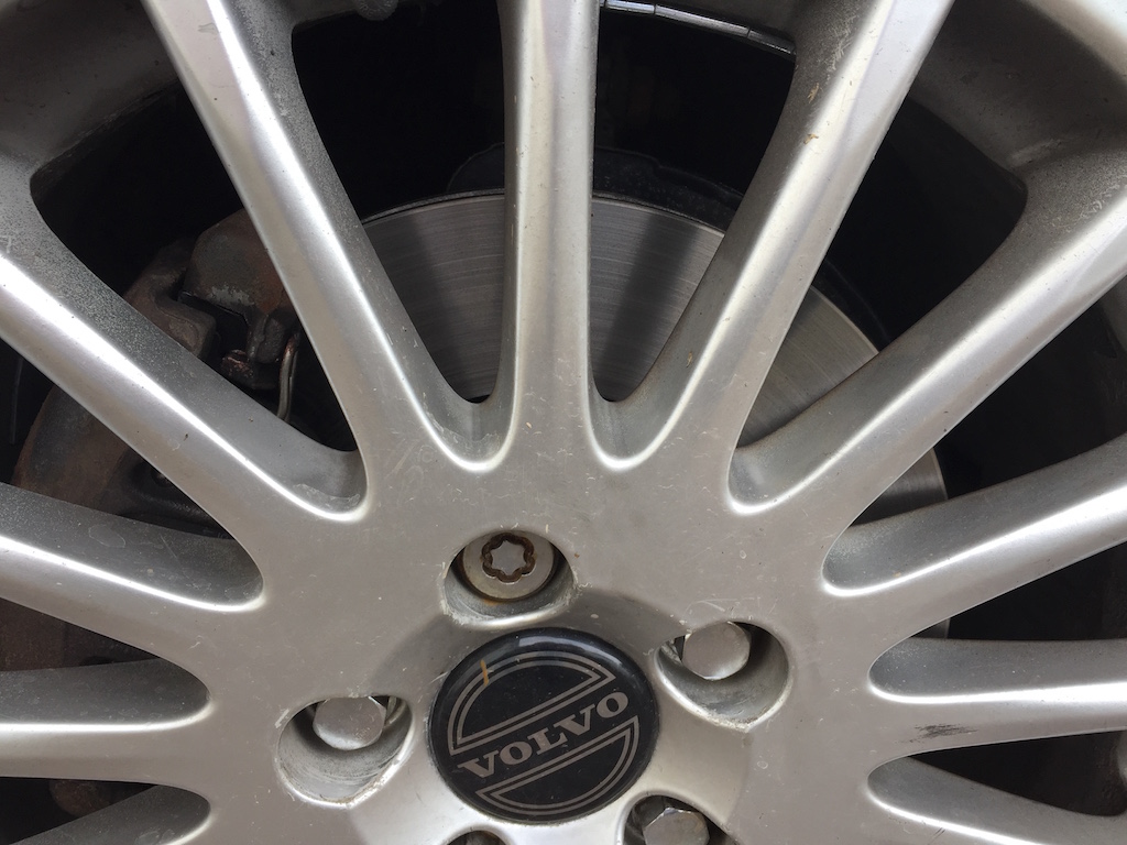

Attempted to change the front discs and pads this evening, the ones currently on there are crusty around the edges and have had uneven pad contact for sometime.
So, new genuine discs and pads sourced direct from Volvo.
However not all went to plan, I got the calliper off and the old pads out but could not budge the carrier retaining bolts using what I have at home. So I've reassembled it all, and will let someone who has the right tools do the job.

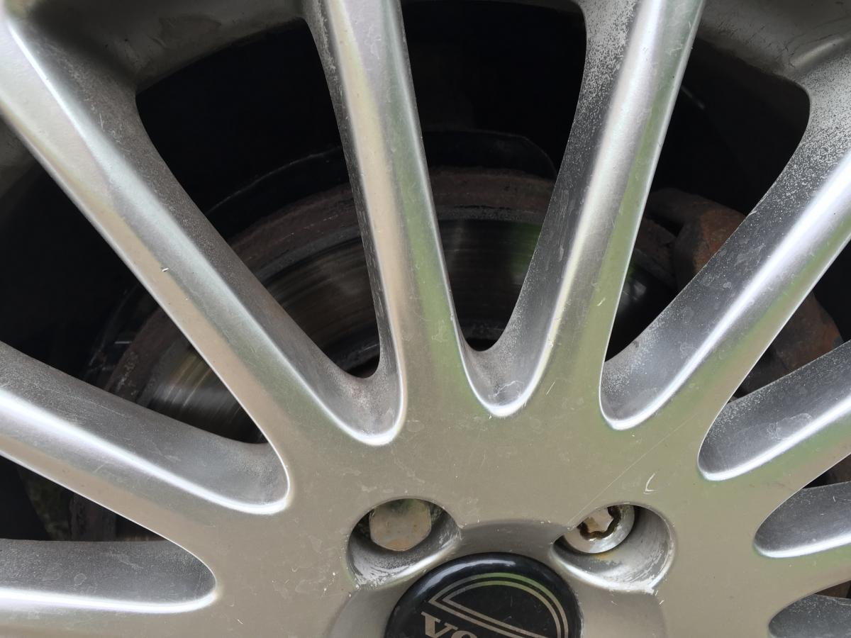

New discs and pads on the front are now fitted, my local Volvo specialist did the work in the end for an hours labour.
I had to trust the work was ok, as it was done the day before I left for a 2 week holiday in France.

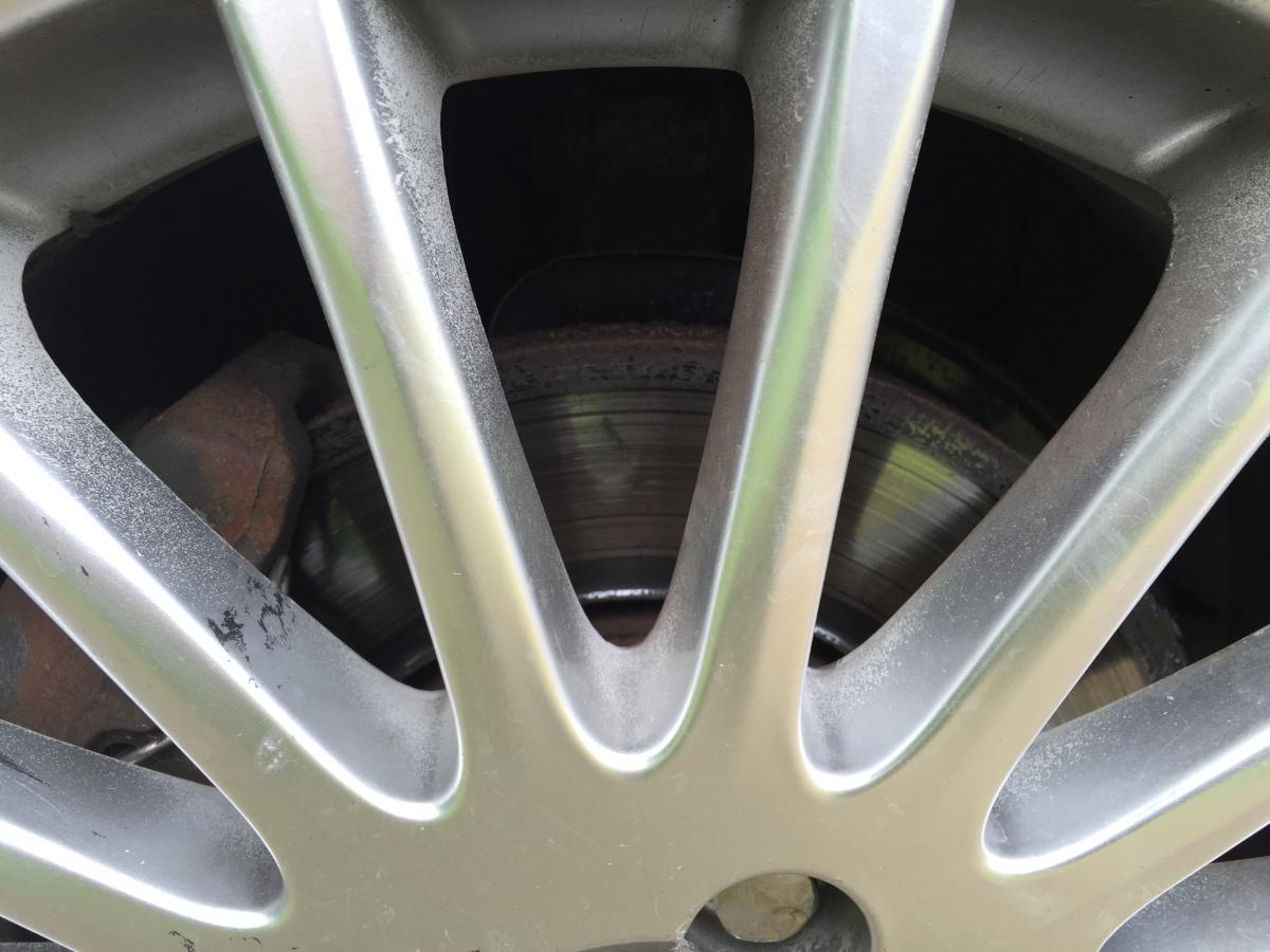

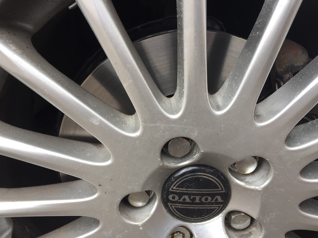

This are the before change discs
These are the new ones, and they are wearing evenly.
I racked up 2500 miles in the Volvo over the 2 week holiday which highlighted no mechanical issues so the car is now going great.
