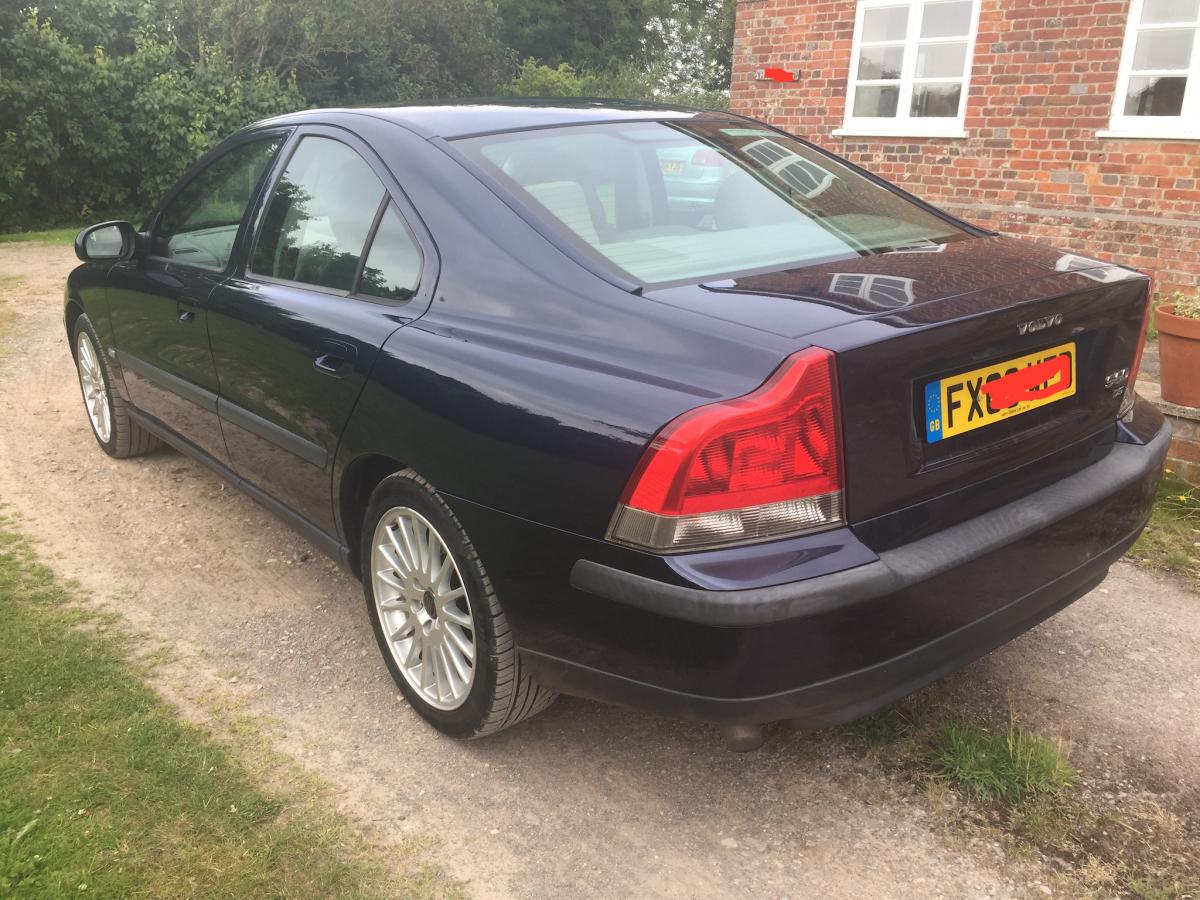

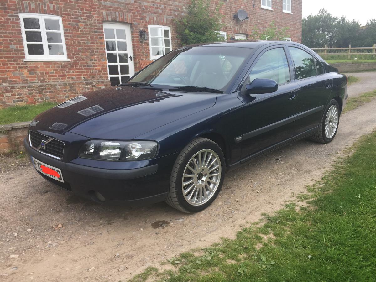

Here are some fresh pictures.

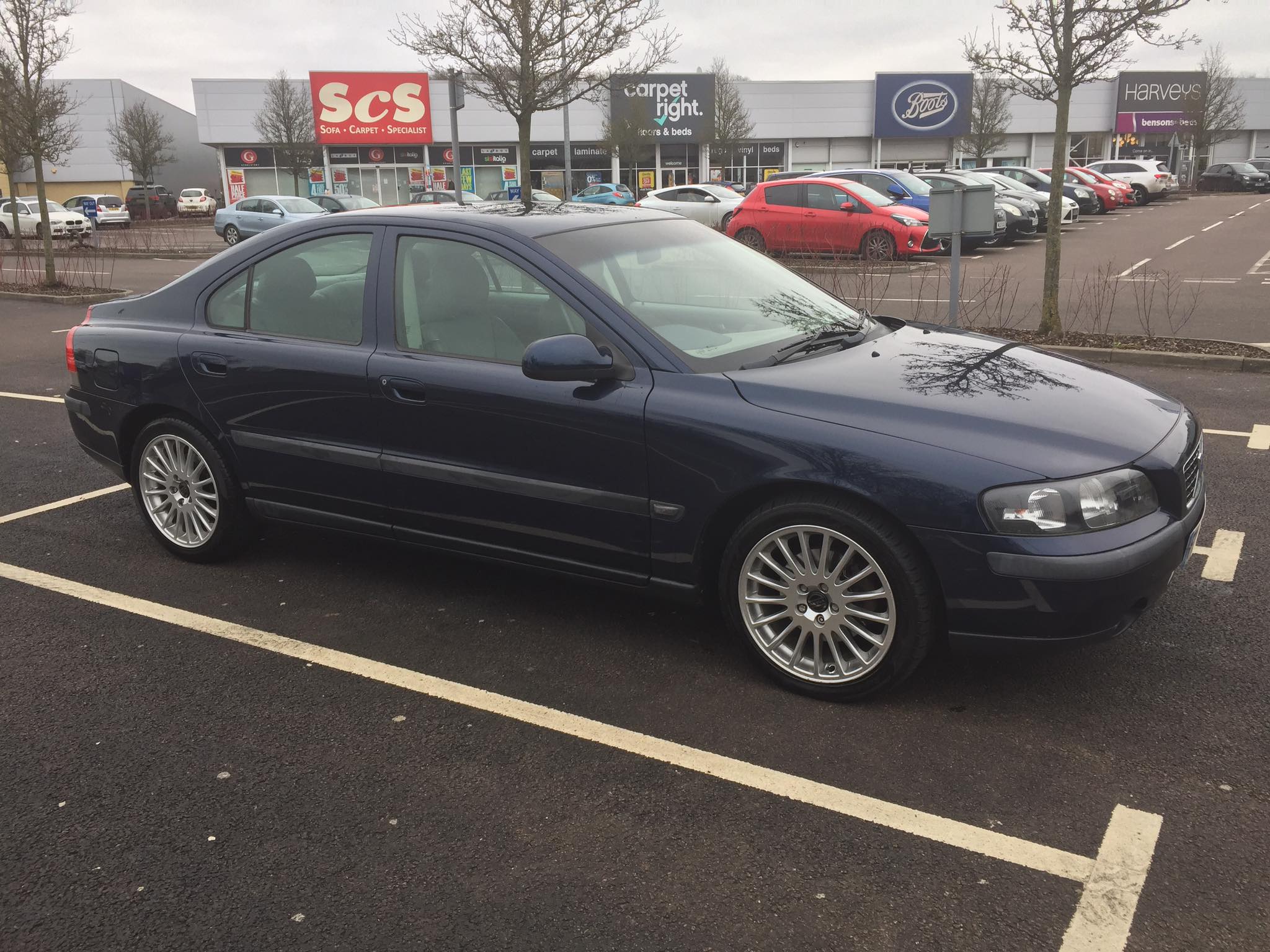

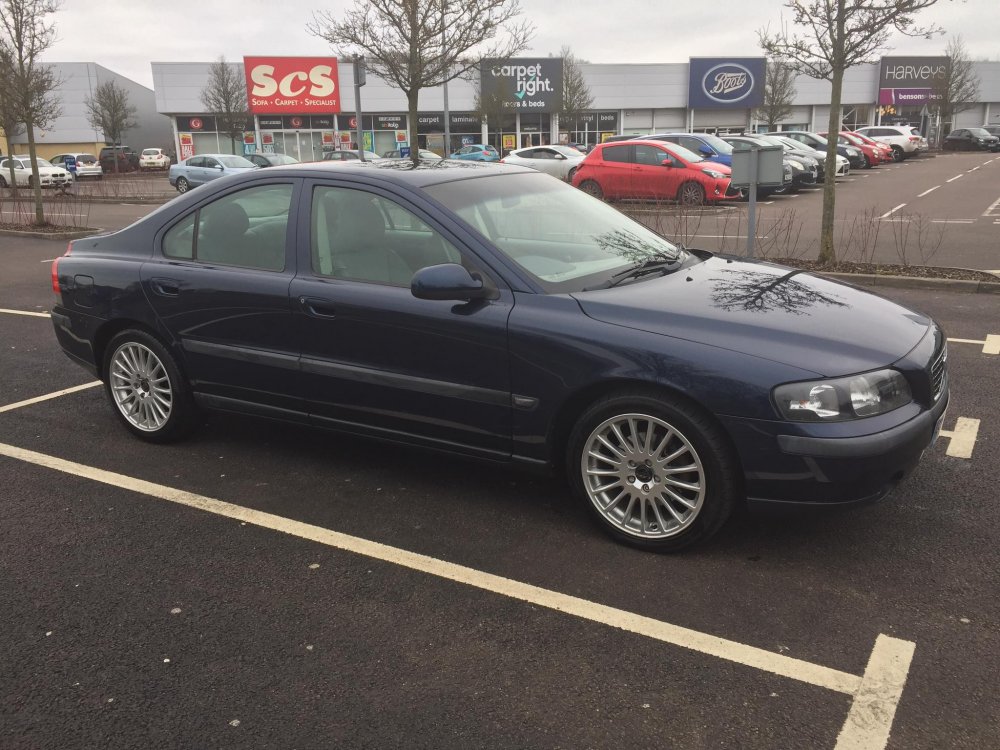

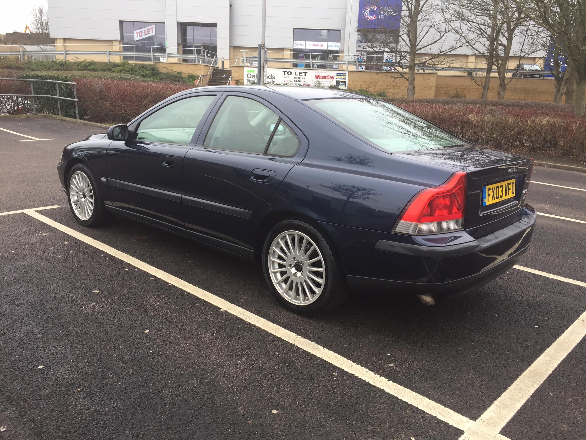

Now on 172K miles, I have attached a couple of pictures from the weekend just gone.
