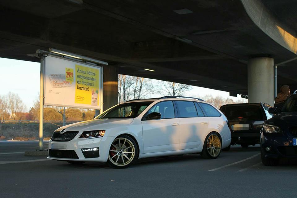

I know this is the superb forums, but I have fitted H&R 40/40 springs to my Octavia Mk3 vRS with DCC, and so far so good! It really transformed the car and the DCC settings make even more of a change now. With the original springs it was a little bit softer in Comfort and a little bit stiffer in sport, but now it feels like a totally different car depending on which setting it is set in!
