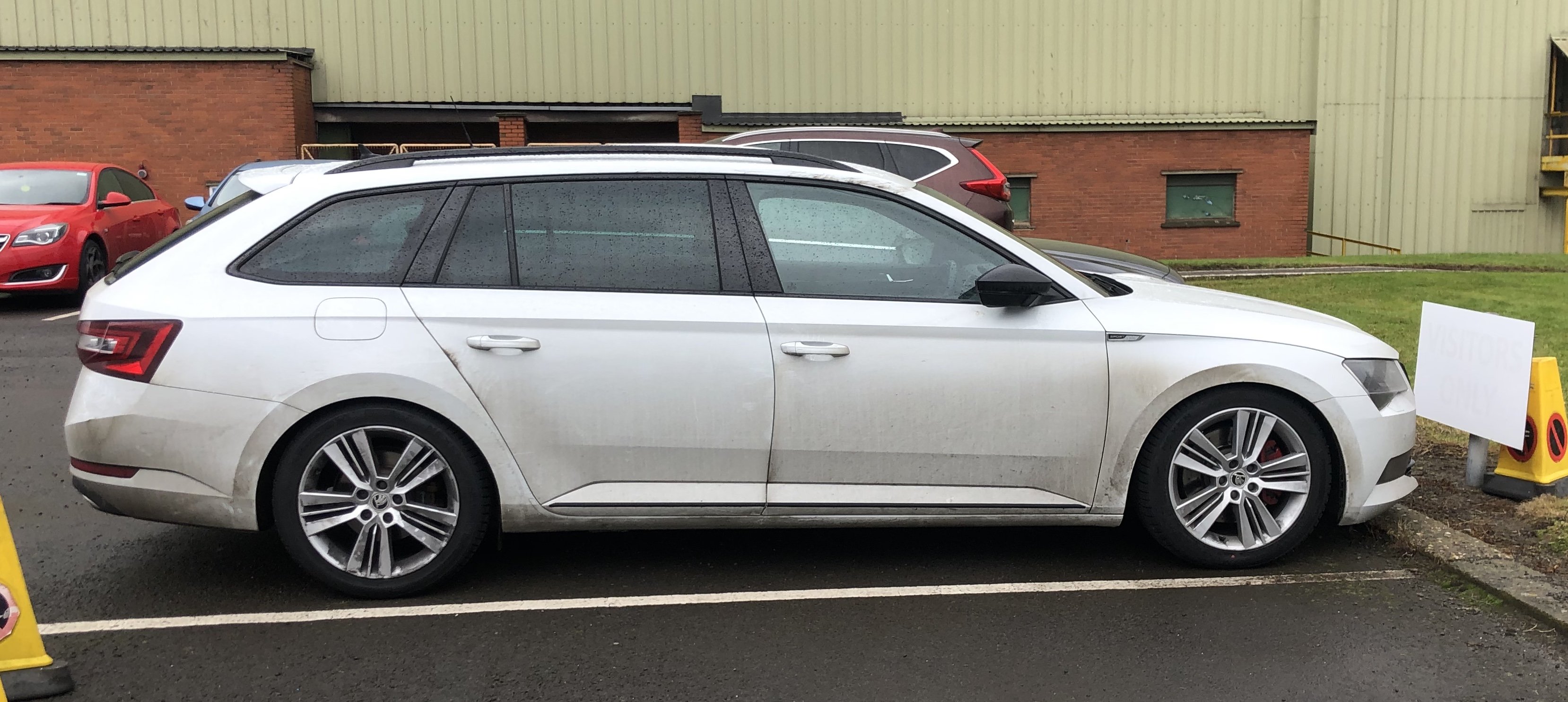

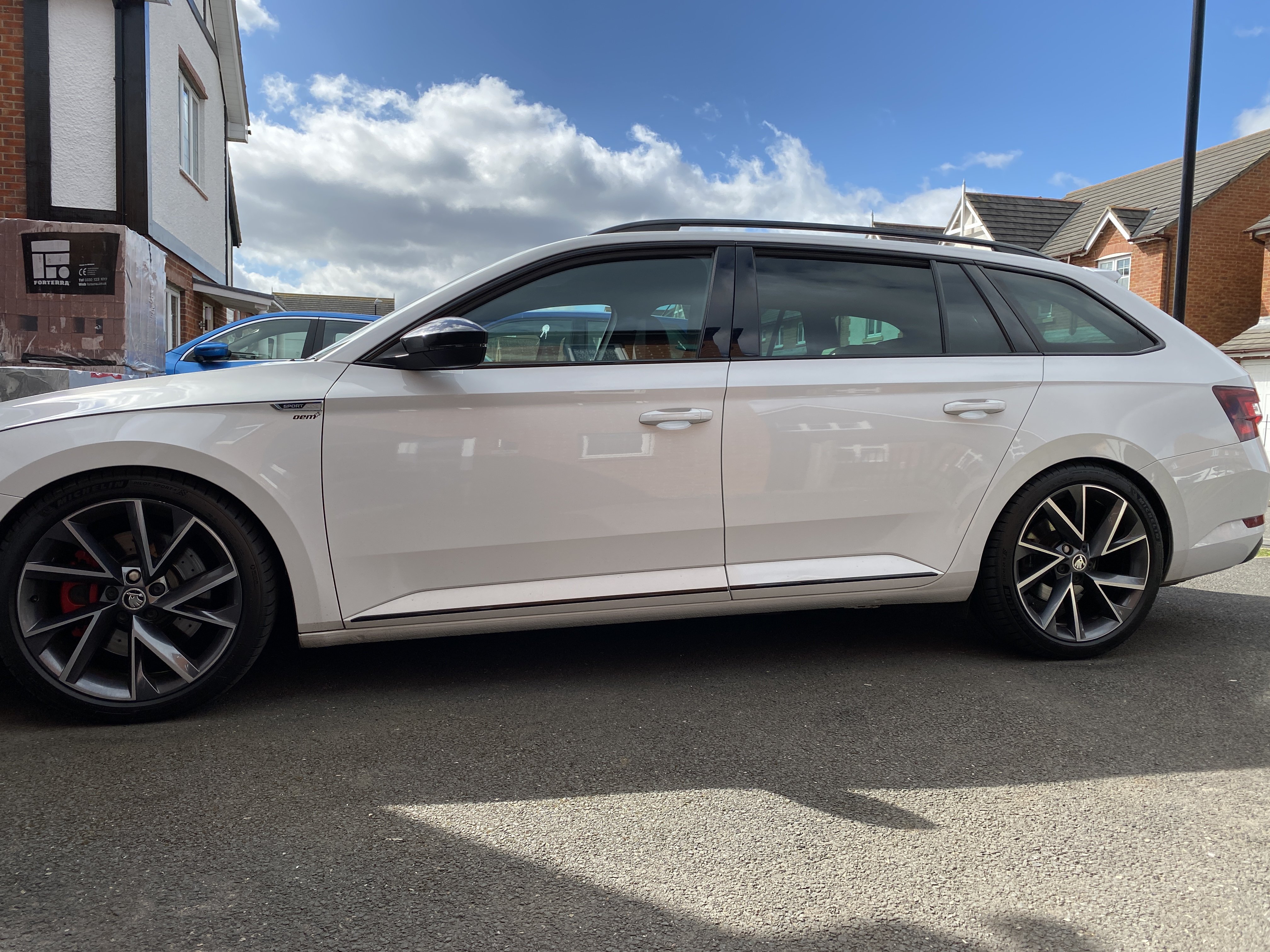

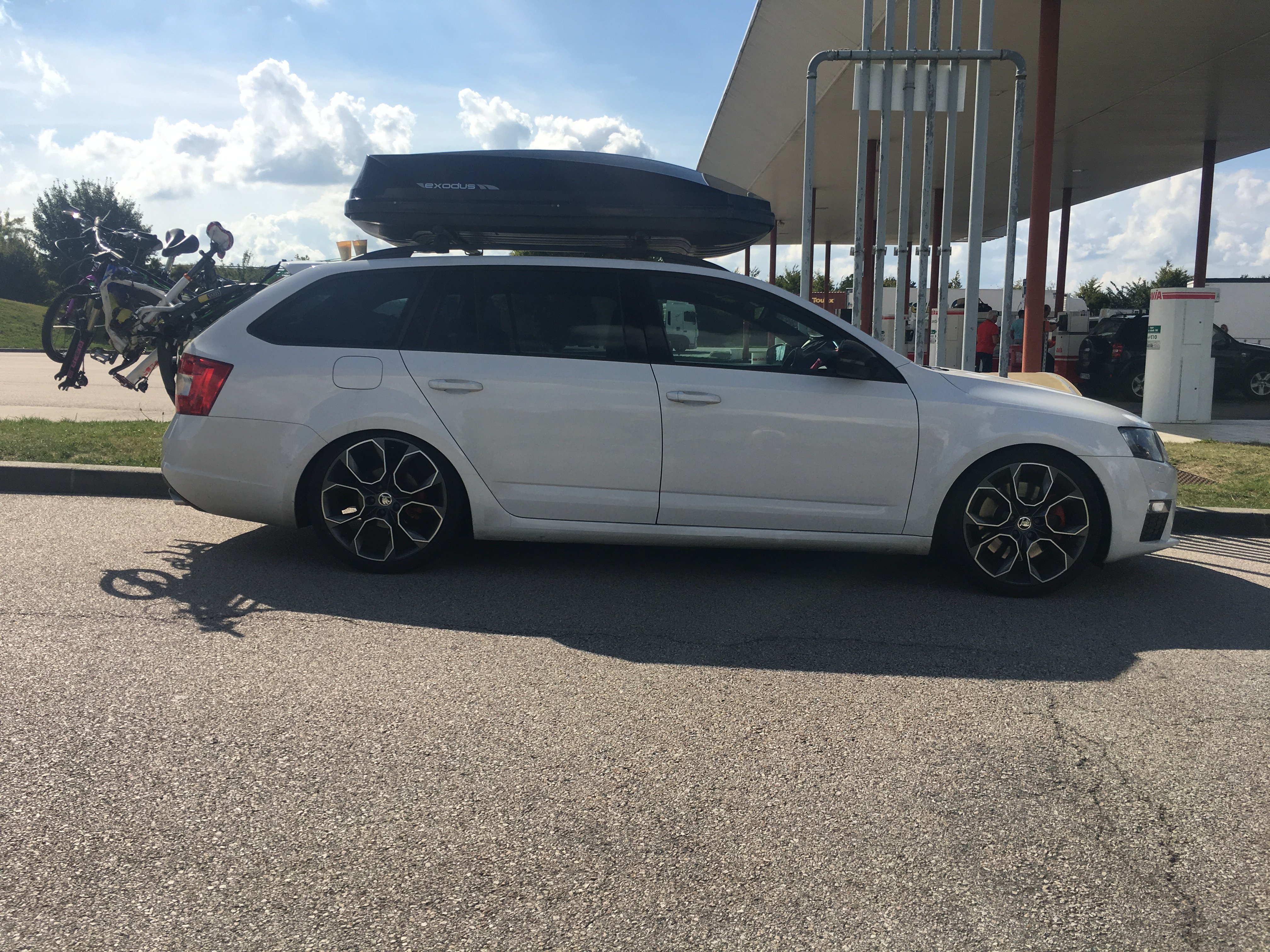

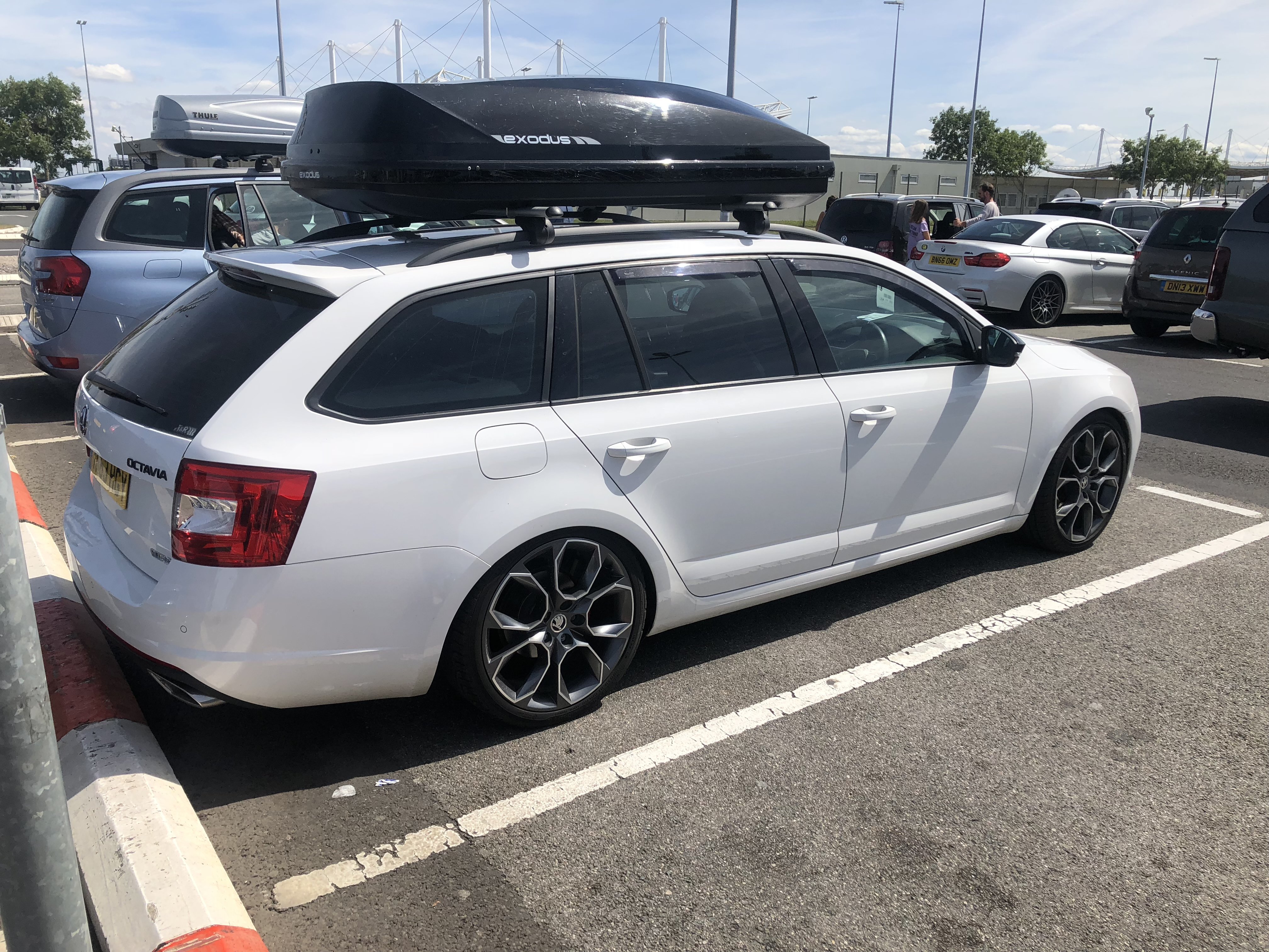

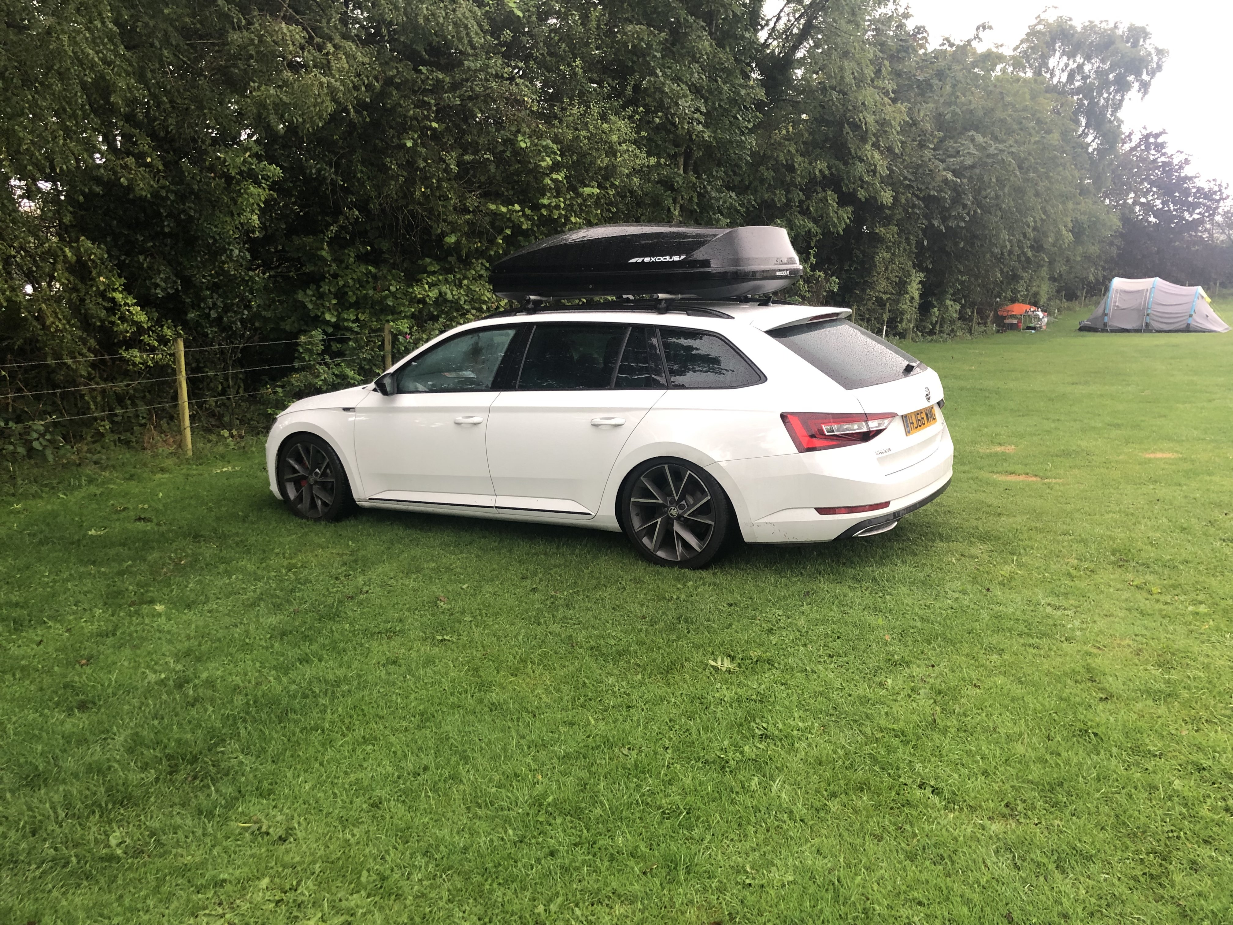

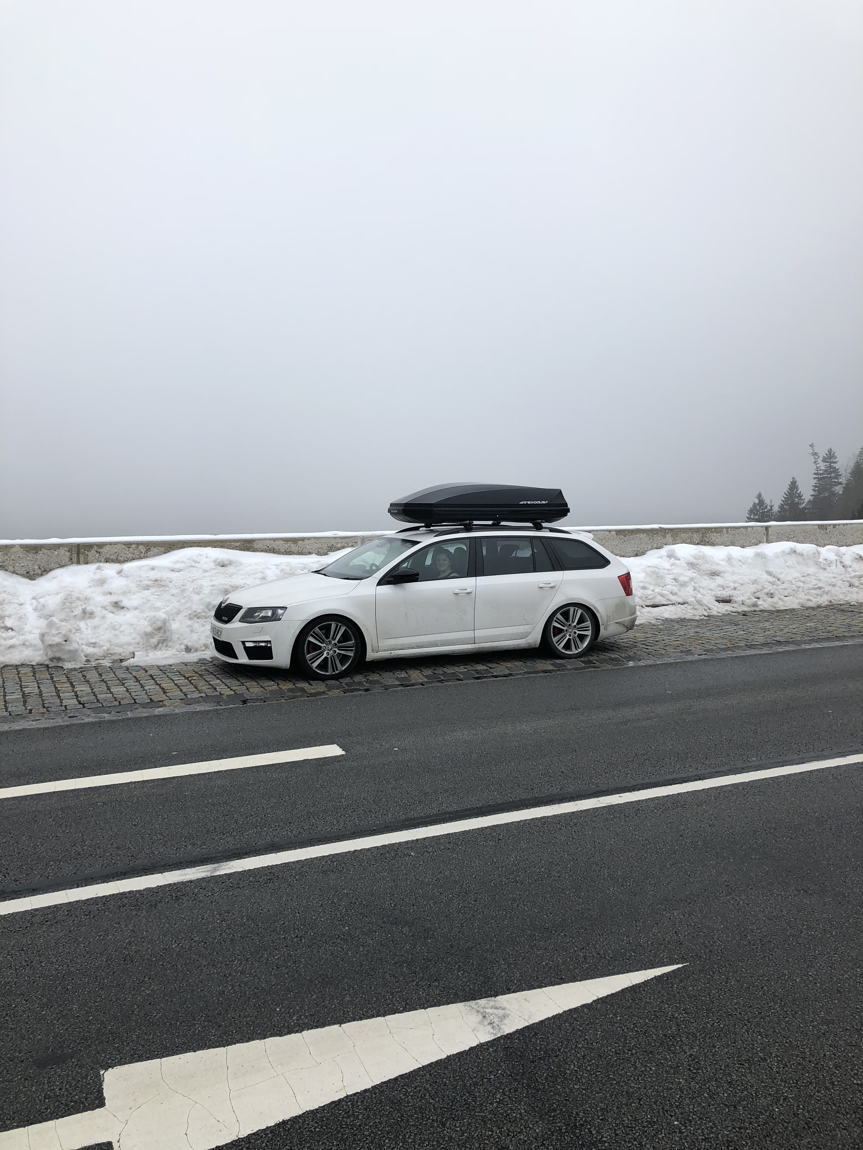

Some loaded and unloaded. Of the octy and now the superb... all on H&R 40mm
1 minute ago, Esseesse200 said:
Are you running spacers there?
Yea 12mm all round mate
The superb looks horny as **** with the tints done and roof box on mate 😍👌🏻
Hahaha sexy innit. Bit of roof box p0rn lol. Cheers mate
Hi Esseesse200,
Sorry to dig up an old thread here guys, but I just wanted to confirm you said you were running 12mm spacers front & rear in these pics - So when you have the 19inch Xtreme alloys on the Octavia, they can be up in the arches like that when fully loaded without the tyres rubbing at all? That gives me great peace of mind if that's the case as that's what I plan to do :)
11 hours ago, simonds3135 said:
Hi Esseesse200,
Yes mate that’s absolutely spot on.. H&R springs and 12mm H&R spacers. That’s on a pre facelift car as the facelift ones have a wider rear track 👍🏻
