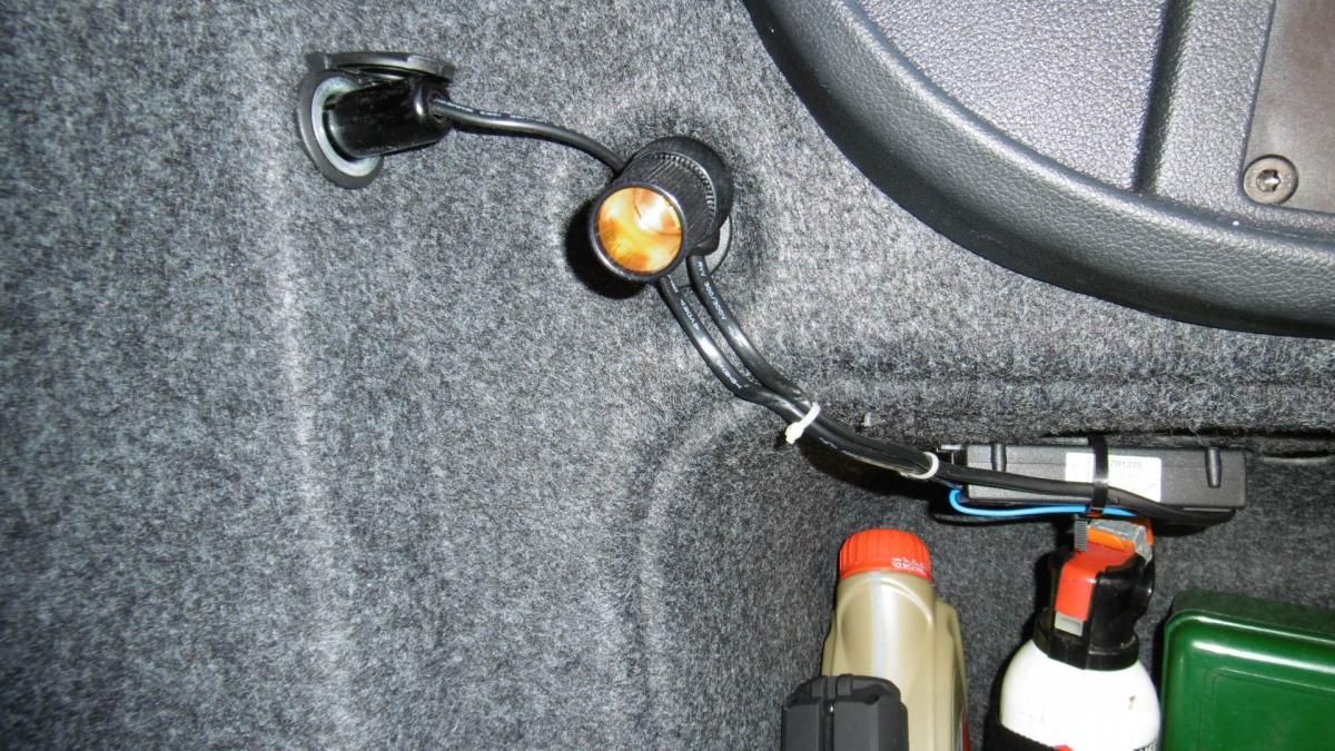

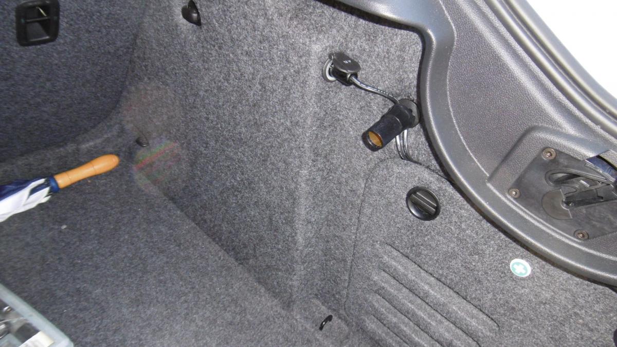

In the boot of my Superb II twindoor I've combined it with a Volton ZR1220 split relay to power it down when engine turned off and power it up when engine on (photos attached)
Has been great when touring Europe. Coolbox fits great allongside two collapsible boxes between the wheel arches leaving room for luggage
