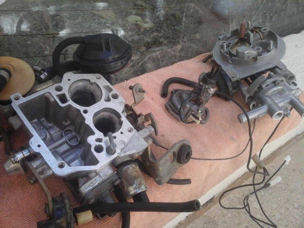

i recently rebuilt a used carburator, cleaned it all thoroughly, split it and replaced all gaskets and diaphragms.
post-114994-0-01500400-1464166335_thumb.jpgpost-114994-0-24090900-1464166338_thumb.jpg

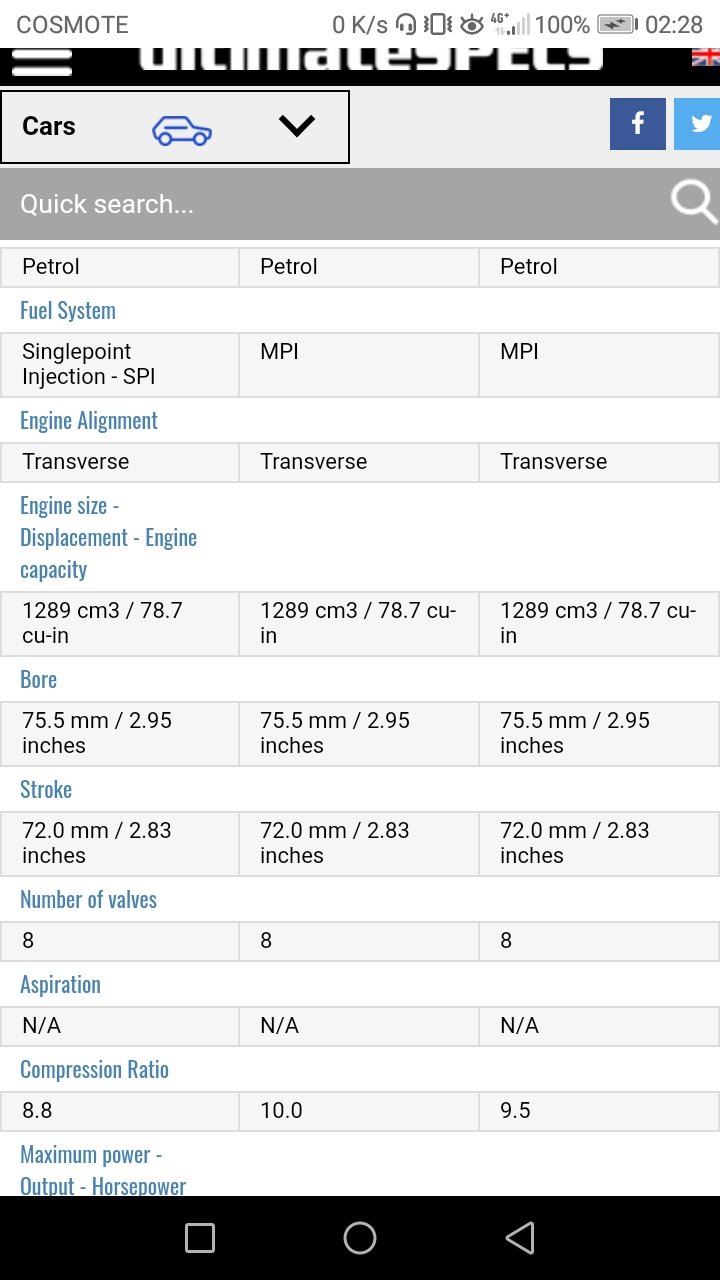

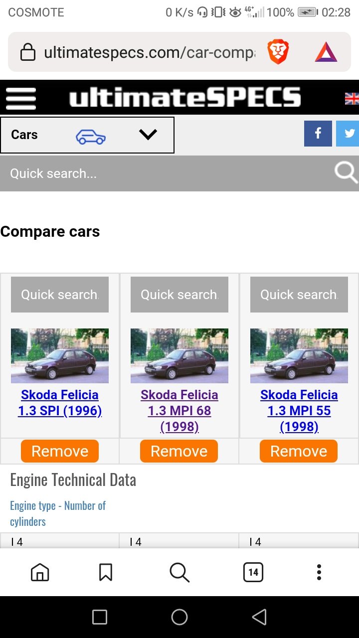

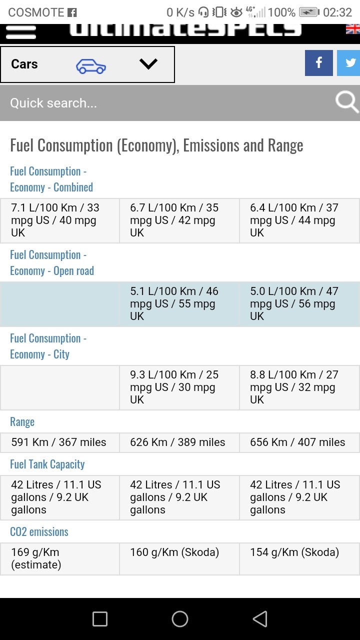

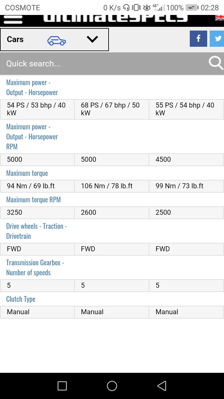

Hi all. I was searching at Google for skoda felicia high fuel  consumption and here i am. My Felicia with a full tank had 410km of range. I have made so many things, like change lambda sensor, cleaning the injectors  with a very specific machine at Skoda's official service, and many many more. Recently i have changed the wiring from ECU to the sensors, injectors, etc. As a result now i make 530km with a full tank, but still far enough from range of 600+km that i have see at many sites with technical details and data. 1.3 50kw mpi 2000'. What is an average km range of???  I will upload a video with the engine idling, and if anybody can understand anything from this i will be very happy! 😁
ECE 15 standard tests?
Screenshot_20211105-022823.thumb.jpg.1c67e09dfe614cd33b454e2cb27aeef5.jpgScreenshot_20211105-022838.thumb.jpg.4412f1d9558ca251b1b0de8ff0a7d95e.jpgScreenshot_20211105-022859.thumb.jpg.1b3baeaec581428253dbff1be760dd64.jpgScreenshot_20211105-023204.thumb.jpg.40b6f4ce673f60834127b6aecec18fb0.jpg
