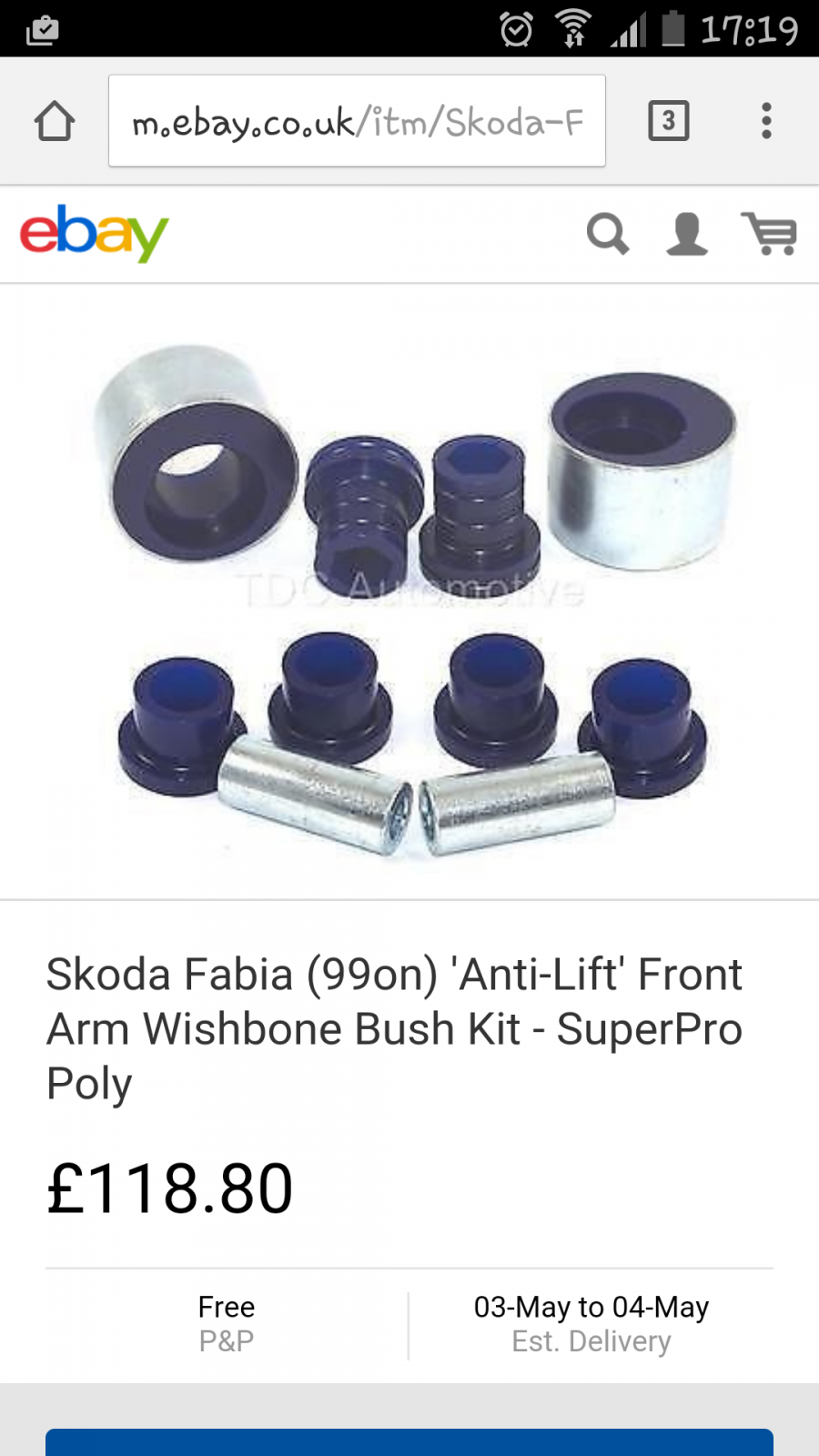

Are these bushes any good
Should i get these
will be a right pain to fit and set the camber up :D

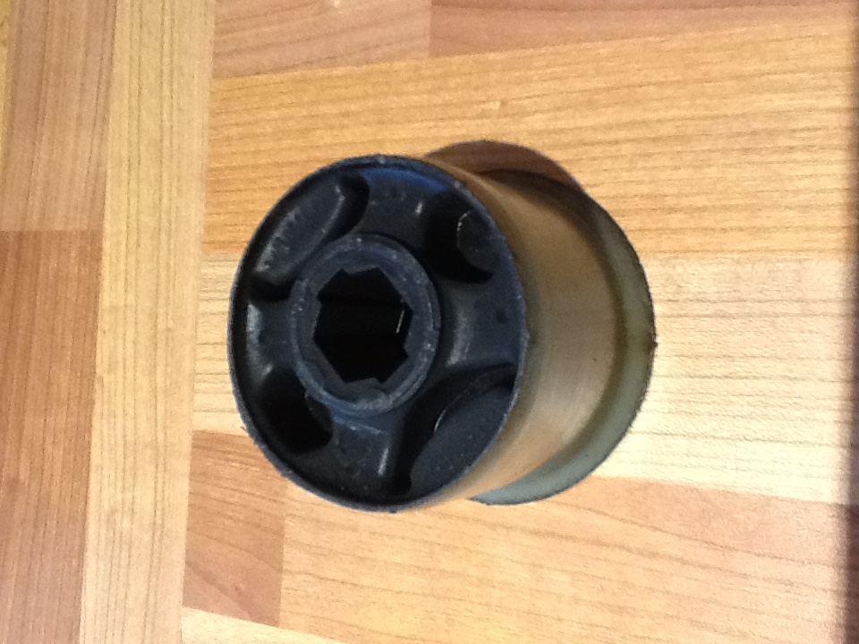

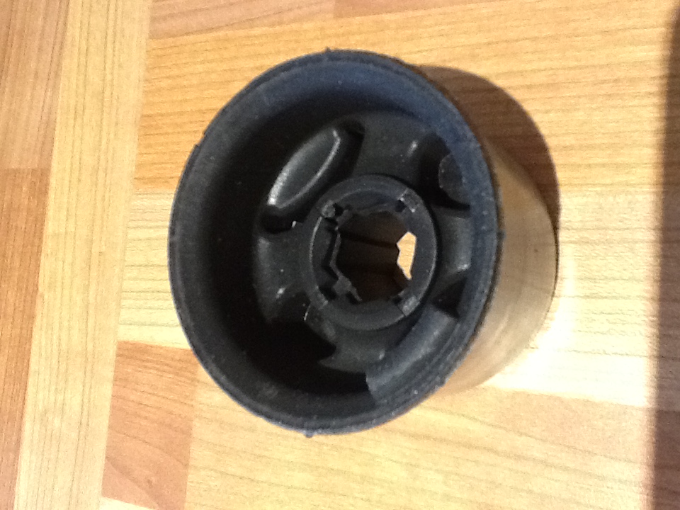

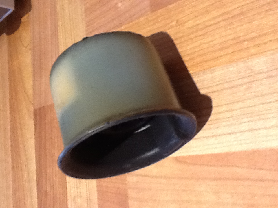

I have a similar question on bushes for my fabia vrs. I purchased the below on ECP, they are for an Ibiza tdi FR however they are in a plastic casing as oppose to metal. I am getting them fitted at the weekend however could do with confirmation if they are correct or not.
I have the oem part references however wanted to buy from ECP.
If they are a poor choice I don't mind returning for oem quality
^ Those are pretty much the same design as the oem ones. Most people upgrade to poly ones or the solid Cupra bushes.

Sometime they can make sound, because they slip in the metal holder.
The stiffness is good enough, may be better than ordinary rubber.
