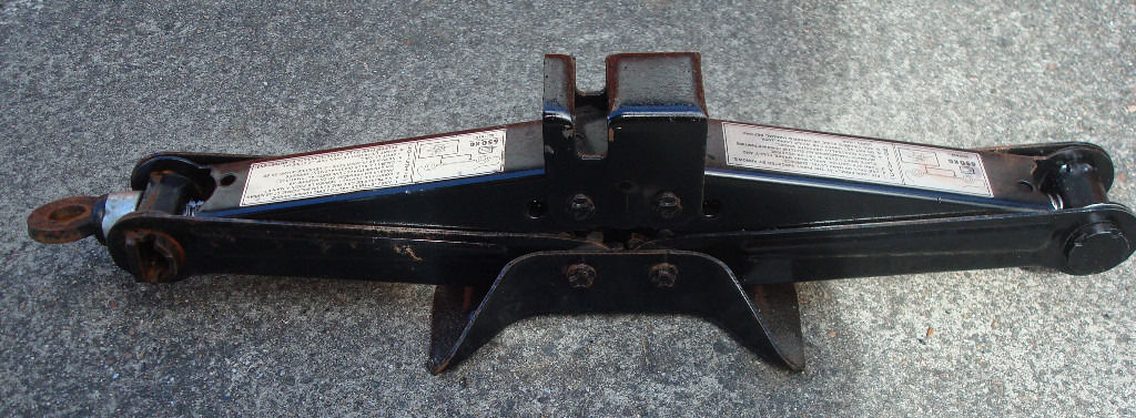

Am I able to use this kind of jack for the Octavia 3? It is taken from a car with a kerb weight of 1280Kg.
