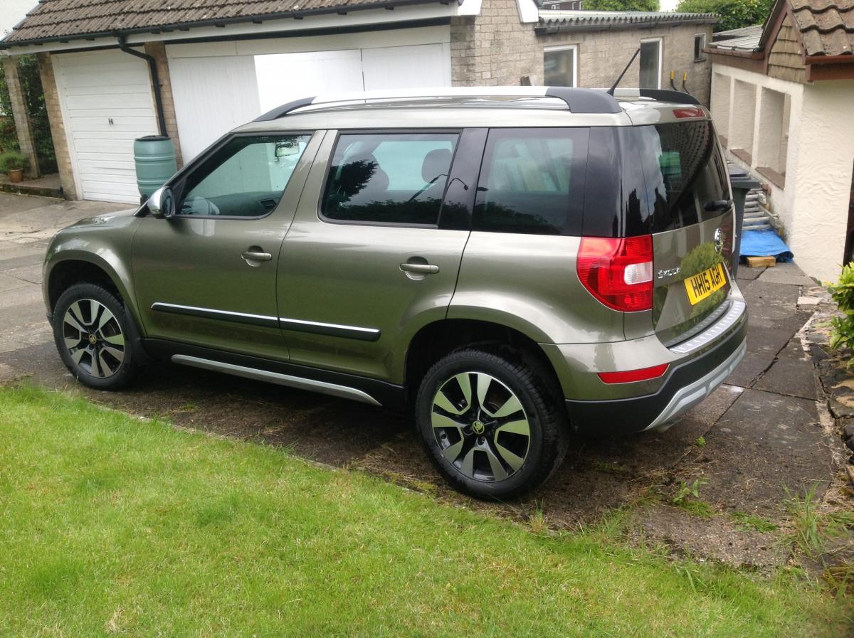

Here my update WOW what an improvement in noise
I've taken my Micheln 205 55 16 energy X off my greenline
And replaced with origami Michelin 225 50 17 cross climate
and can honestly say it's like riding in an Audi it is now so quiet and smooth
I wouldn't have believed it Totally differant car
No need for sound proofing just fit these tyres and see for your self
And as a bonus the speedo is bang on 40 is 40 60 is 60 etc where as 40 was 36 and 60 was 55
Have to see on mpg now was 55mpg so I'll report back

When changing the wheels over I did notice the new 17" are apx 1" bigger than the old 16" they do look big in the wheel arches
