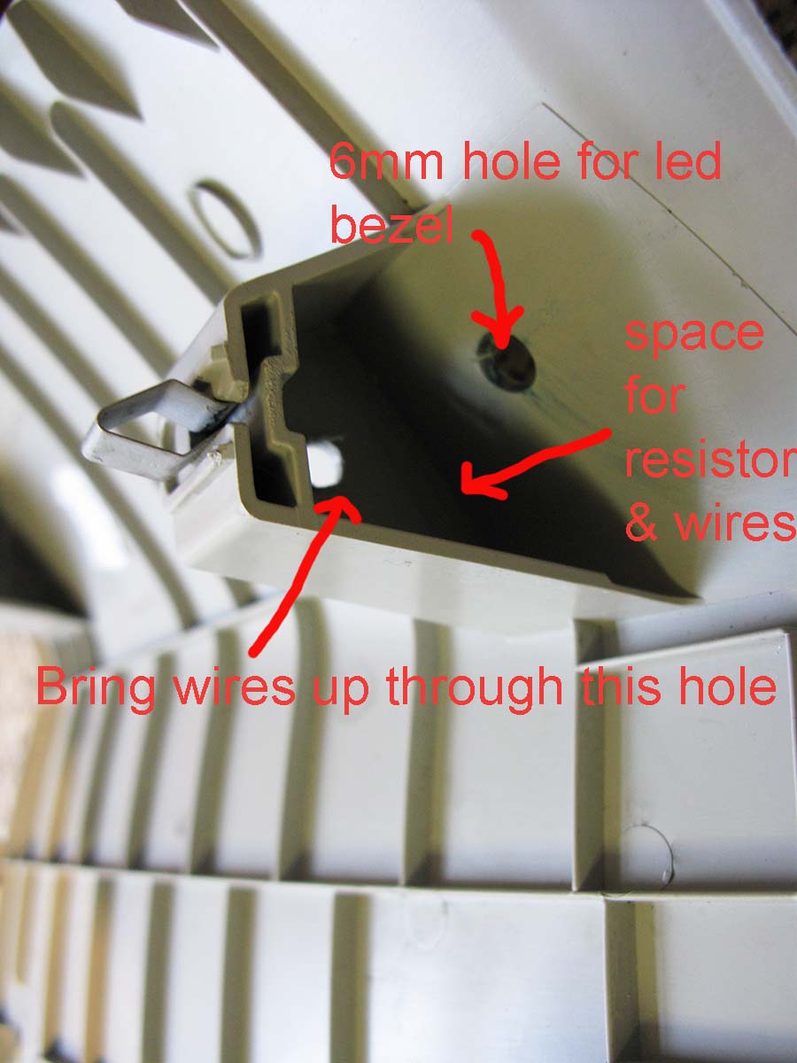

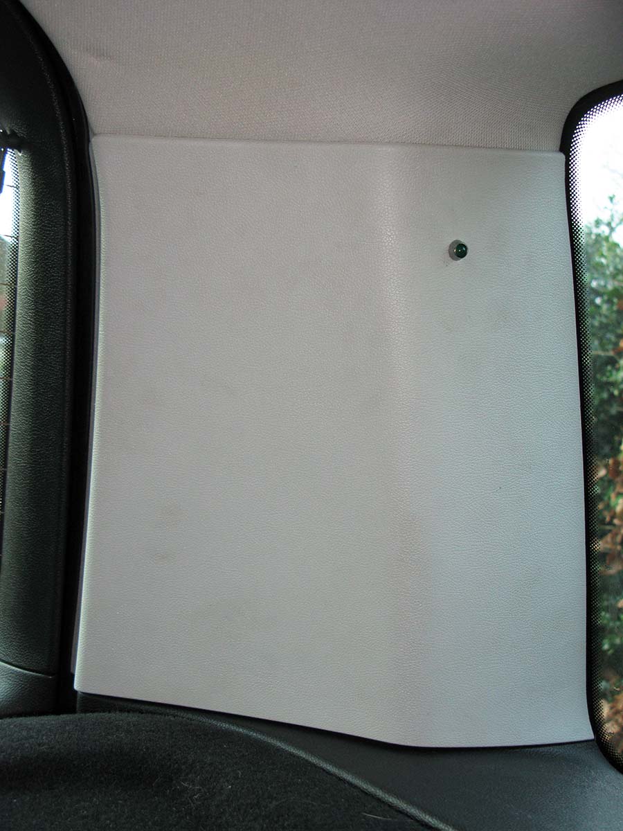

I just finished fitting a green 5mm led and bezel to the lift off interior panel nearside rear. With  some patience you can remove the rear lock cover trim and get a wire down the side, without removing the lining. The led is not over conspicuous and annoying (at night) and can 'disappear' with a slight shift of the interior mirror to the offside. I used a green led and 560 ohm resistor. A 12V led would work fine, but you can't control the brightness if it is too bright. Anybody who tries this needs to know that +12V is on the yellow pump wire and 0V is on the black wire. I can see the pump come on for low speed acceleration, stay on longer when in off road mode, go out when on the flat cruise and come on when decelerating and when cornering which all sounds normal behaviour. It also goes off a couple of seconds after using the hand brake.

Just what Skoda should have fitted in the dash display ! Any chance of a couple of photo's on the LED installed ?
Was the LED a 5v with the 560 ohm or a 12v with 560 ohm.

Ordinary leds (diodes) need a series resistor. I don't run green more than about 15mA otherwise you get short life. Therefore 5mm green led + 560 Ohm is about right and not too bright. If you want it in your face, or rather the rear mirror, go for high bright clear red and a 470 ohm resistor. Otherwise use a 12 volt led which has a resistor built in. If you don't want to drill a 6mm hole in the rear corner trim cover, you could just poke the led out from the edge of the cover. It comes off easy, unlike the long cover over the lock keep which is a pain in the but to get back without breaking the 5 spring clips along the top underside.
To get this simple led up in the cockpit with wiring would need a lot of messing about. I could have used a cheap Fleabay wireless single channel garage door opener, but you need to do some work on the fob to permanently enable the button and provide a step down voltage from the pump.  Then you mount the receiver 'module' up front under the console to activate your led. These things are only about £4 and I've used them before.
Simplest was to remove the rear top plastic cover, run a wire down behind the left lining, down through a bung in the boot floor then across the back side of the heat shield to the Haldex unit. The back side of the heat shield shouldn't get too hot being cooled by the air space above, but I did use some silicone wire. Glass fibre sheathed cooker wire would be high temperature also. I'm sure 105 deg C would be o.k, but I already had the silicone wire. I fitted a 2 pin faston connector on the end and its female spliced to a a pair of wires soldered to the Haldex motor wire. I did extend the motor wire my about 100mm which makes it easier to remove the connectors on the controller. I'm not sure you can turn the motor around, the pump section has to stay aligned for its filter to align with the port in the body(?).
Attaching my 2 pin faston connector to the pump wires now means I would have to cut and solder splice the connector and wires on to a new pump if it was replaced.  The really smart mod. would be to identify the Skoda OE 2 pin connector and wire up a break out adaptor using a male and female plug/socket.  Will post up a photo.  Seeing the led come on, go off, or dim whilst driving gives some insight into what the 4WD is doing and when it is most active.
Photos uploaded. Sorry, Yeti off the ramps now so no wiring photo, but everything is neat and tidy, soldered splices with heatshrink sleeve over. resistor and solder junctions all fit inside the moulded space for the cover retaining clip.

Looks good, a led closer to normal view would be time consuming, but not impossible - well done.
