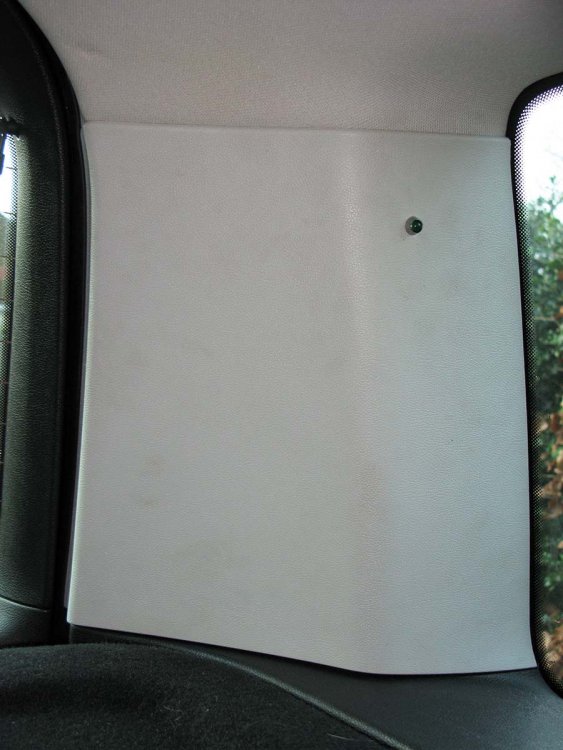

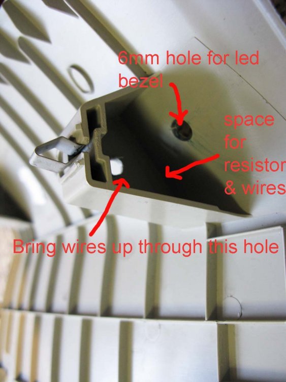

  • I just finished fitting a green 5mm led and bezel to the lift off interior panel nearside rear. With  some patience you can remove the rear lock cover trim and get a wire down the side, without removi
