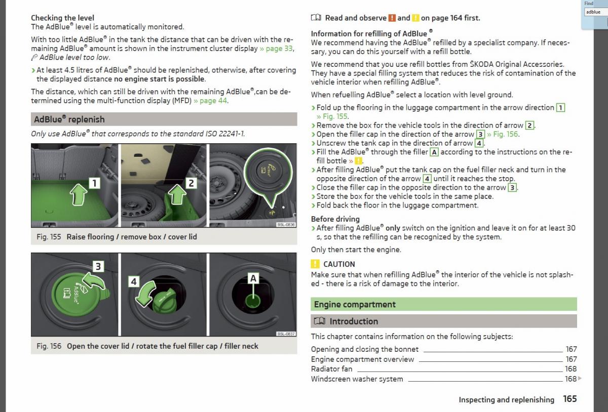

Many of the Euro6 engines (including the Yeti) need adblue, those that need it the filler is under the carpet in the boot
IF it does have it then by the spare wheel

If the Yeti was built pre May 2105 it will not have Adblue.

Checked the yeti -
No filler in the boot by the spare wheel, so looks like it doesn't need adblue.

My ad blue filler is to the right of the spare wheel and pinches
some of the previously useful space.
I have just checked the skoda site and found that only yeti models from 2016 use adblue.
Mystery solved.
Mystery solved.
And the 2016 models are anything built May 2015 onwards.
Mystery solved.
It’s actually MY16 cars, so anything built from week 22 in 2015.
My MY16, built in May 2015, has an Adblue sticker on the inside of the diesel filler cap, showing that Adblue is put into a tank accessed through the boot area.

Mines hidden in the boot on the right of the spare wheel, something tells me it was an after thought!!
Yes, it is an afterthought as the Yeti was not designed for the Adblue system and it had to be fitted into a convenient space i.e. the underfloor storage space in the boot.
In the new Superb, designed for Adblue, the filler is simply next to the fuel filler and the tank underneath somewhere.
Adblue system is needed to get the TDI engines to comply with Euro 6 emissions regs, hence fitted as part of MY2016 specification.
