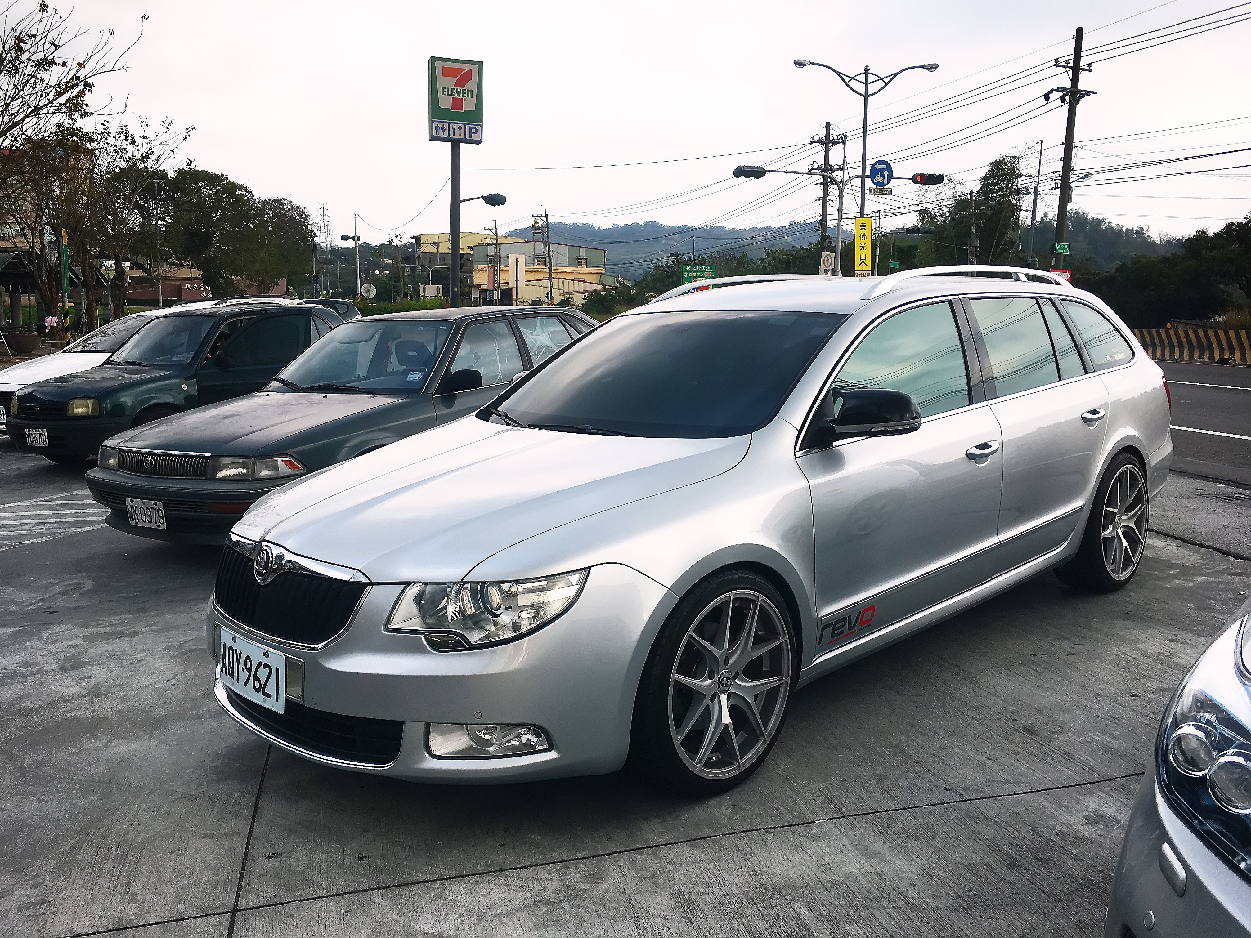

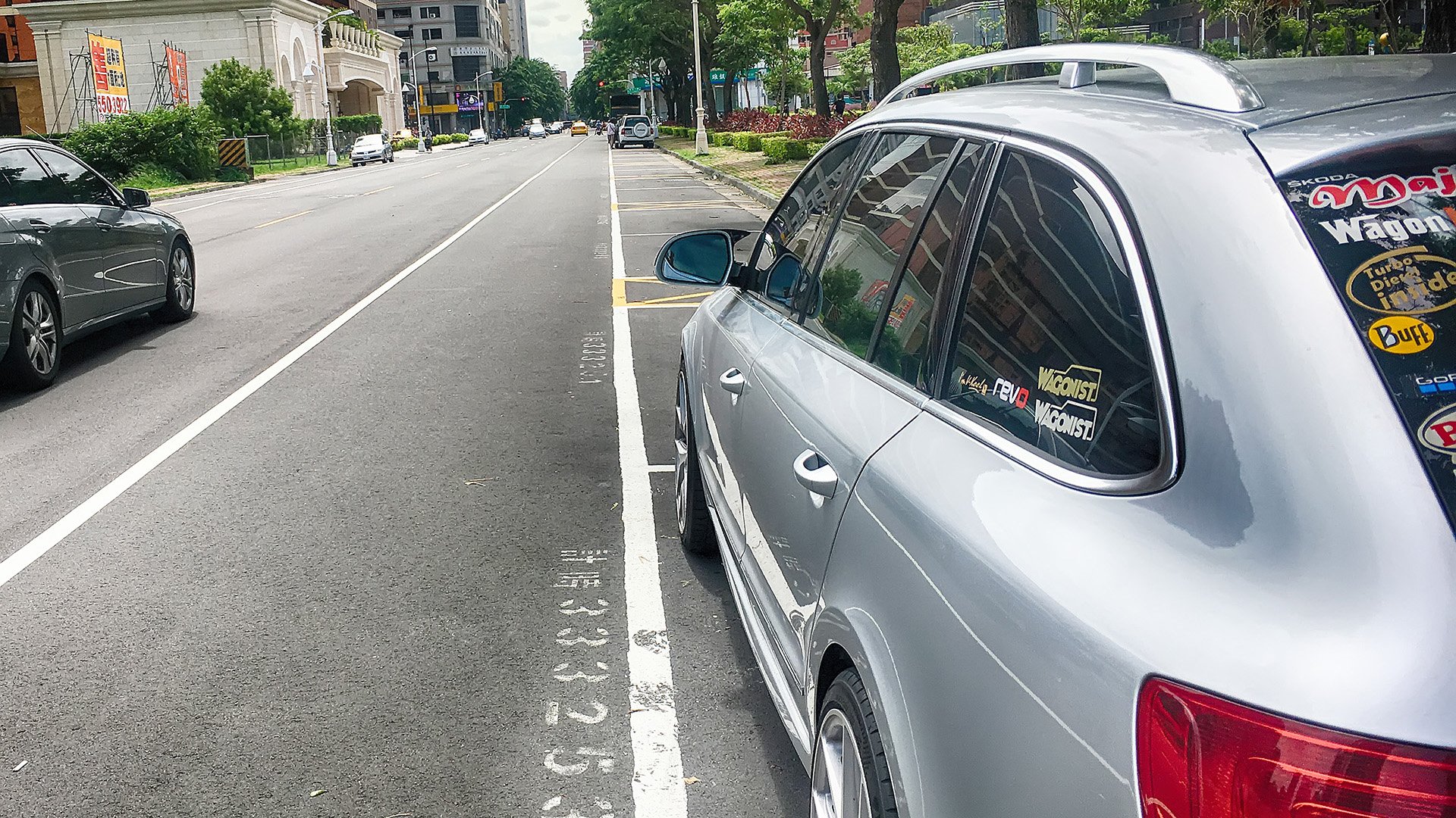

Yes it fits. This is mine 19' Et35 8.5J with 235/35/19 tyres.
