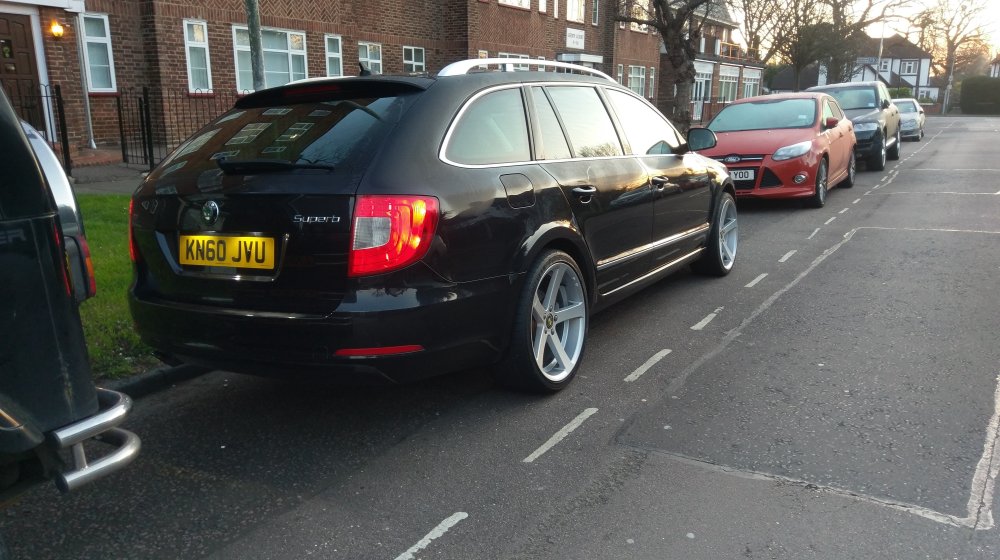

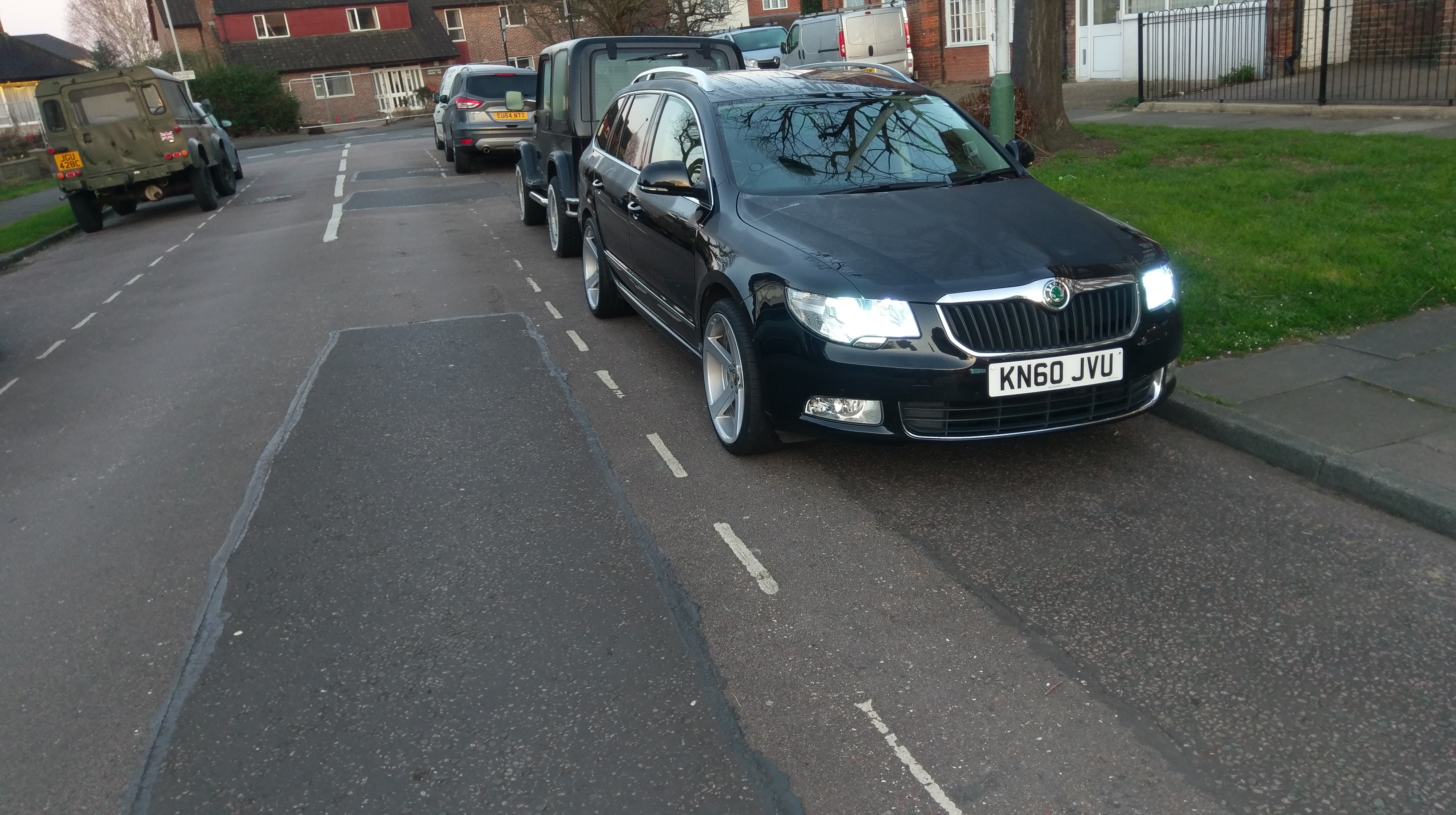

ET35 fits, but it might poke out a bit in the front, especially with 8,5" rims. I have ET40 and 8", and they are pretty spot on. I might add 5mm spacers to the rear.
kewl, got any pics? :)
Here's a few.
I'm going to lower it more with H&R springs. The -30mm Eibachs are not enough IMO.
http://imgur.com/UhJJ2k4
http://imgur.com/uod1mYG
Ah, is it lowered on 30mm springs all around? Maybe coils would be the way to go? Could you maybe do a sideshot of the rims so we can see how it aligns with the body of the car. From the included pics it looks like ET35 actually is a pretty good fit and would open up for more rim alternatives since the market is pretty limited with ET45 rims :(

It's the Bilstein B12 kit. Bilstein B8 shocks and Eibach springs. Coilovers would be great, but I just bought these Bilsteins. I can take some shots from the fender clearance later today.
