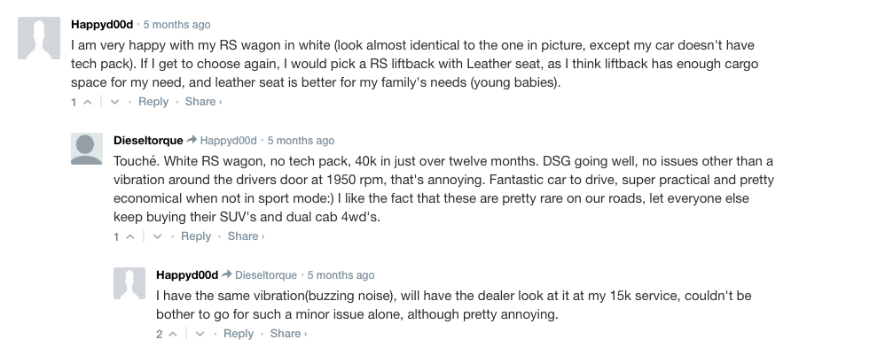

I saw someone else had a rattle (I have a rattle too on mine and it's only done 2,000 kms, it sounds like it's coming from the drivers door). He took his to his dealer and they said they fixed it by tightening the door trim?

This stupid rattle also exist in our 2 brand new company cars and sounds like it is coming from the door.

Drivers door - trim was tightened up by dealer.
