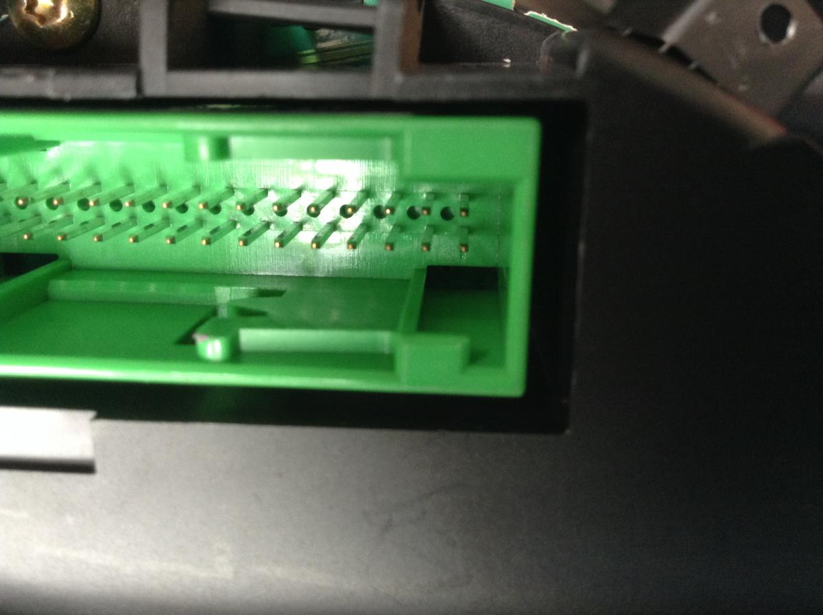

I mentioned this because may be some of the pins went wrong. to be more precise: Pin number 2 on Green 32-pin Connector is for reading coil for immobilizer 1 (from 05.99 prod.), and  pin number 17 reading coil for immobilizer 2 (from 05.99 prod.). might be worth checking.

Thanks for the info Arminator will disconnect and check it out visually ,cheers.

Sorry forgot post-122552-0-08210600-1471535109_thumb.jpegpretty all ok to me
connector seems fine. did you get a sticker with scratch able part that comes with you spare key? this sticker contains 4-letter pin code you can use for pairing your keys with cluster using vcds.

Hey!! She's running after giving the green socket/connection a lot of sweat and after many warning lights appearing I'm left with the seat belt and low brake fluid lights on. I'm just off on a quick test run ,not far down our lane.
Went ok except brake fluid went out then came back on when did a test restart ,by the way the seat belt light was the airbag light ,my mistake.l have lost faith in the socket connection after this episode,as l thought that it was a 'sorted' design.ls it a case of Father Time?

Yes Arminator ,reluctant as I was but the flexing of the plug partially solved the problem .l'm now left wth the airbag light on continuously , but does momentarily go out on start up .Hopefully my stepson will be able to extinguish on his Vag com/VCDS as mentioned by pauldazzle.Thanks very much to all you guys who responded to my plight.Cheers Vince
