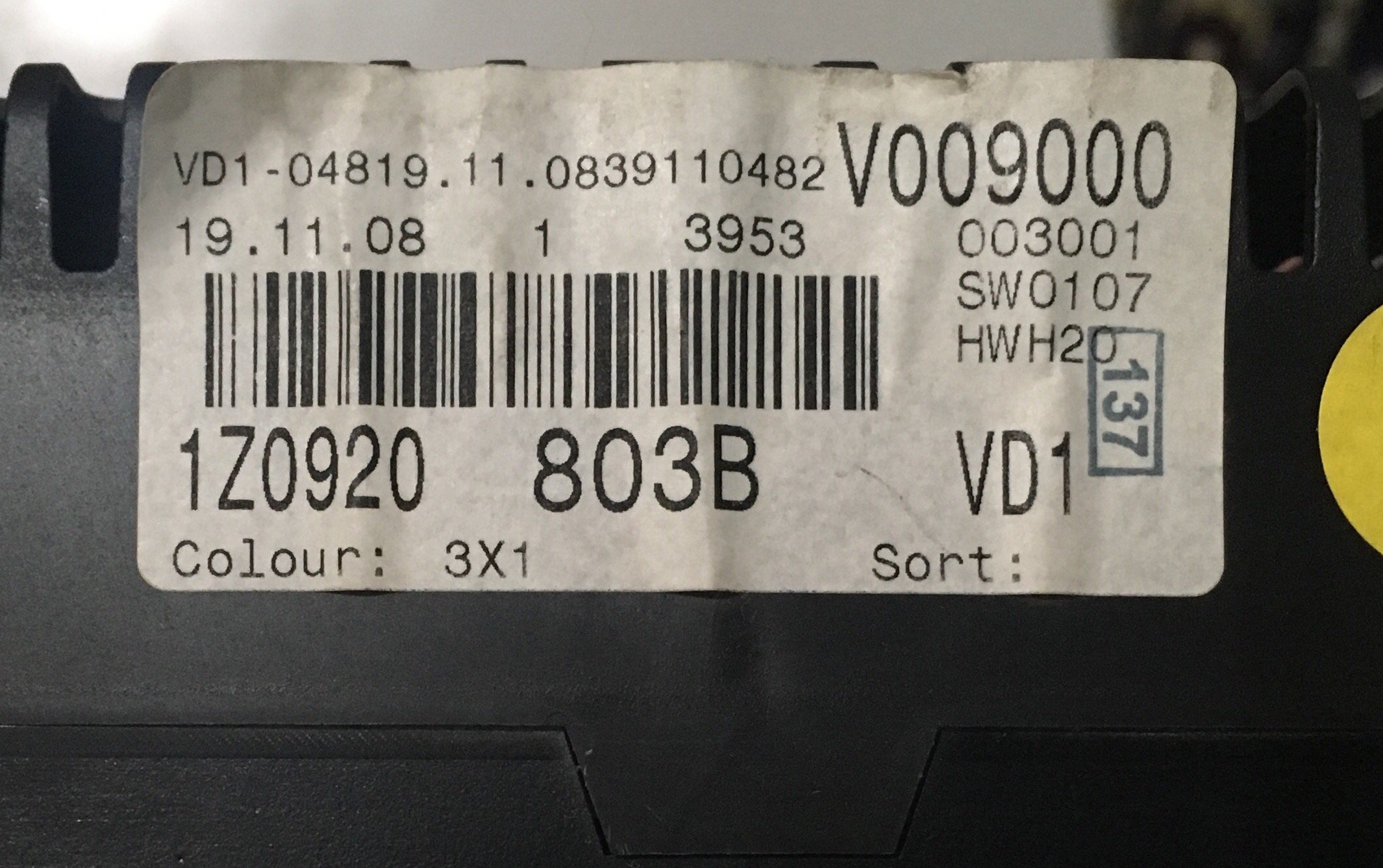

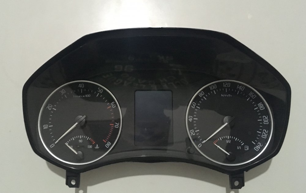

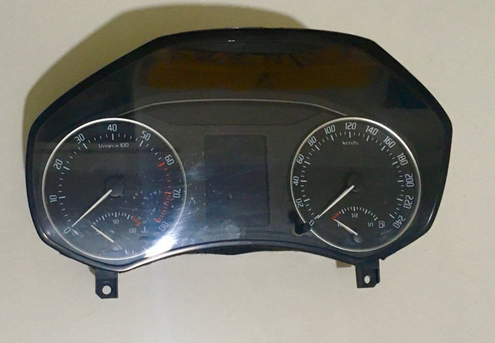

I wonder if the attached one has a maxi dot display and could work with MFSW?
That's not a maxidot.
You need a part ending 843 rather than 803.
