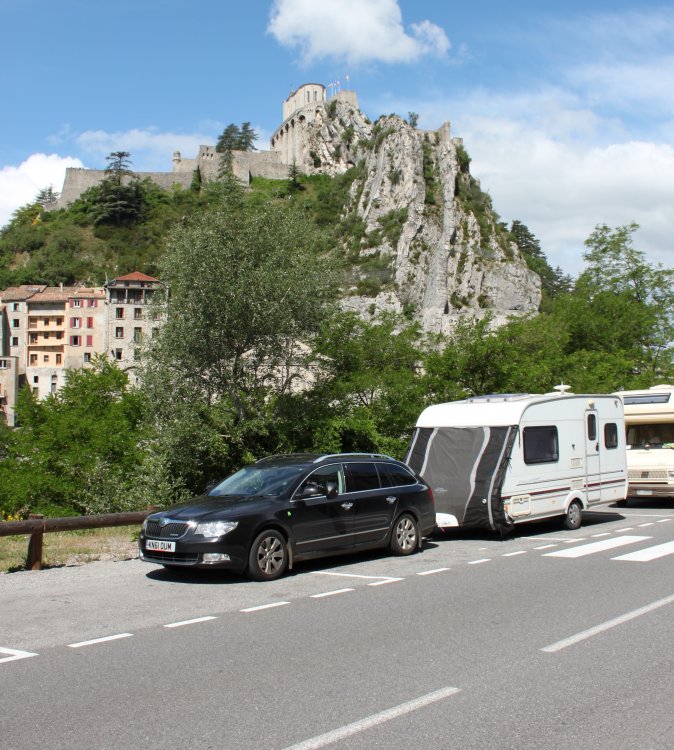

As a caravan puller with a superb, I can say even the 1.6TDi is powerful enough to pull a caravan over the alps!
How much weight are you pulling with your superb ?
1200kg when full of Belgium beer
What a great photo ! That's brill
1200kg is a good weight but you forgot the wine !
Thanks bf
