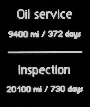

my 2016 1.2 TSi has just had the oil change message come on at 18,300 yet the inspection still had another 600 miles to go
so I decided yo get them both done together as was silly to pay for 2 separate garage visits.
also as there was only 4 months left on warranty, decided to simply visit my local village garage as they've a good reputation and I can simply walk home after leaving the car.
here's the maxdot after reset
oil change in 13 months or 9400 miles time
full service 24 months or 20,100 miles time
oh and the full service at my local cost me £148 incl oil and filter

No 1 year and 1 week fixed service (372 days) or 9,400 miles, which ever comes first.
So basically they never knew how to set it.
& if they have put in Long Life Oil  VW504 00  5w 30 FS, it can go 18,5000 miles if they had set it on Variable / Flexible.
But they have not set it to Flexible, just a mess up.
What oil shows on the invoice, is it 5w 30 FS LL3 ?

you simply reset the service after completed and it sets itself automatically to the next requirement (as shown in the image above)
agree with you that it makes no sense - the skoda service setup and lack of service book,
