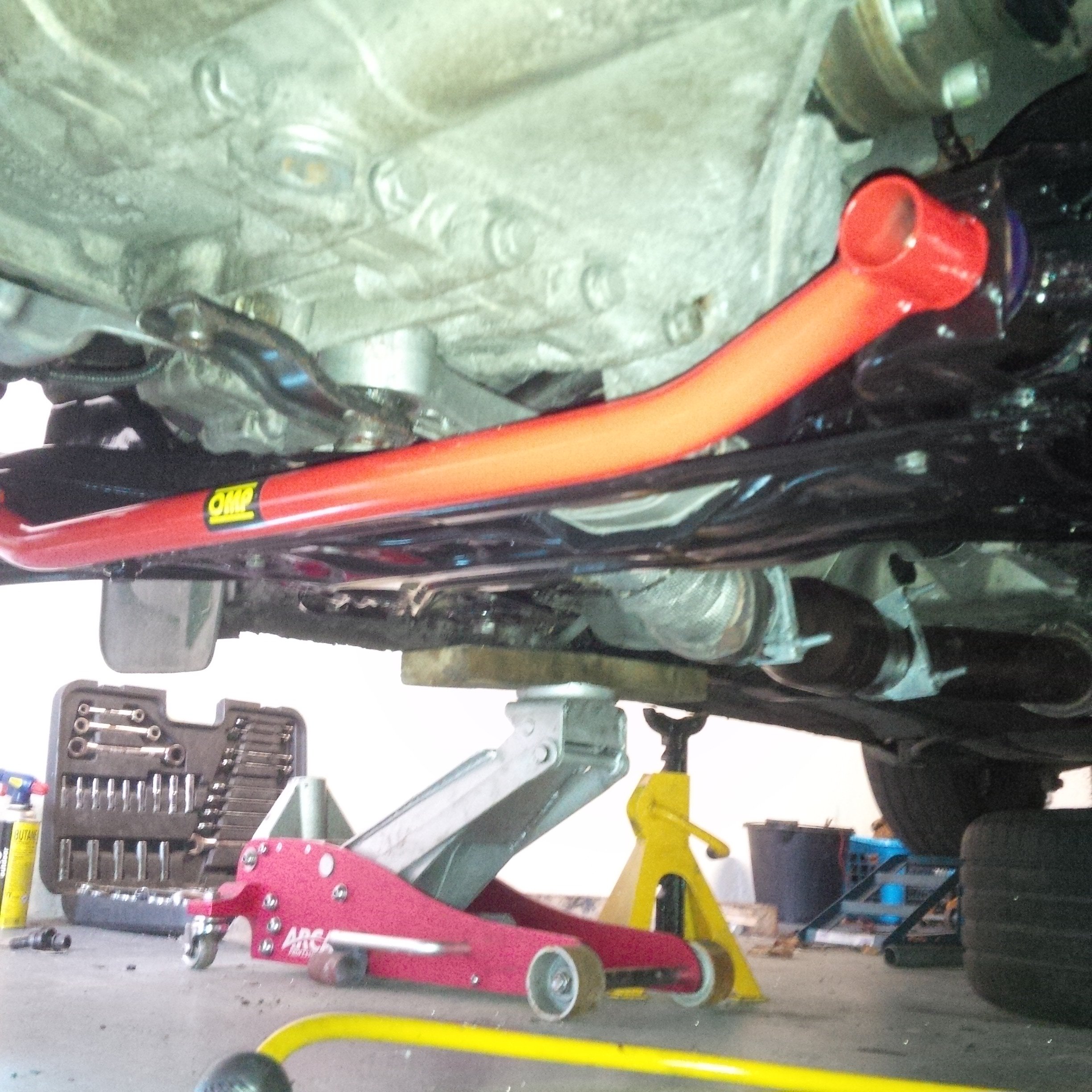

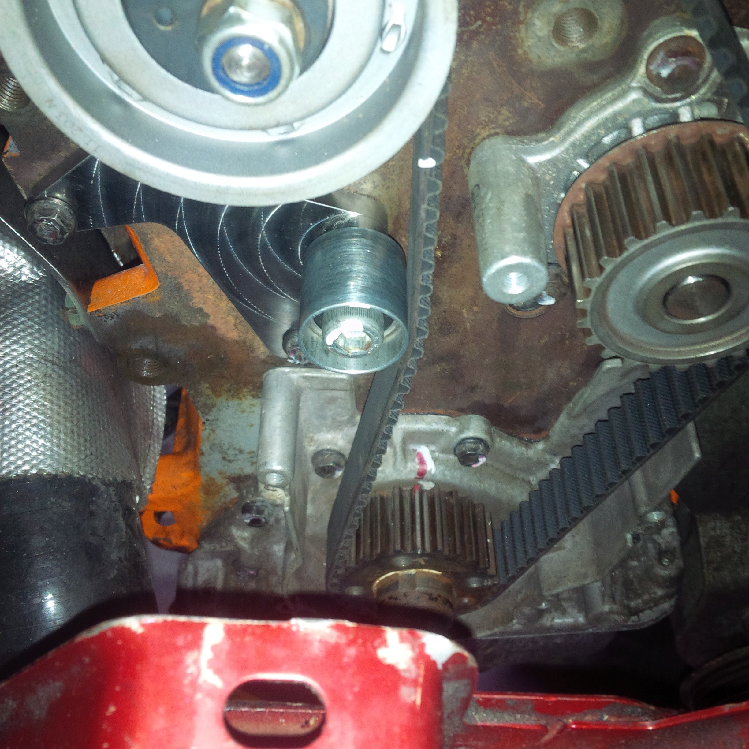

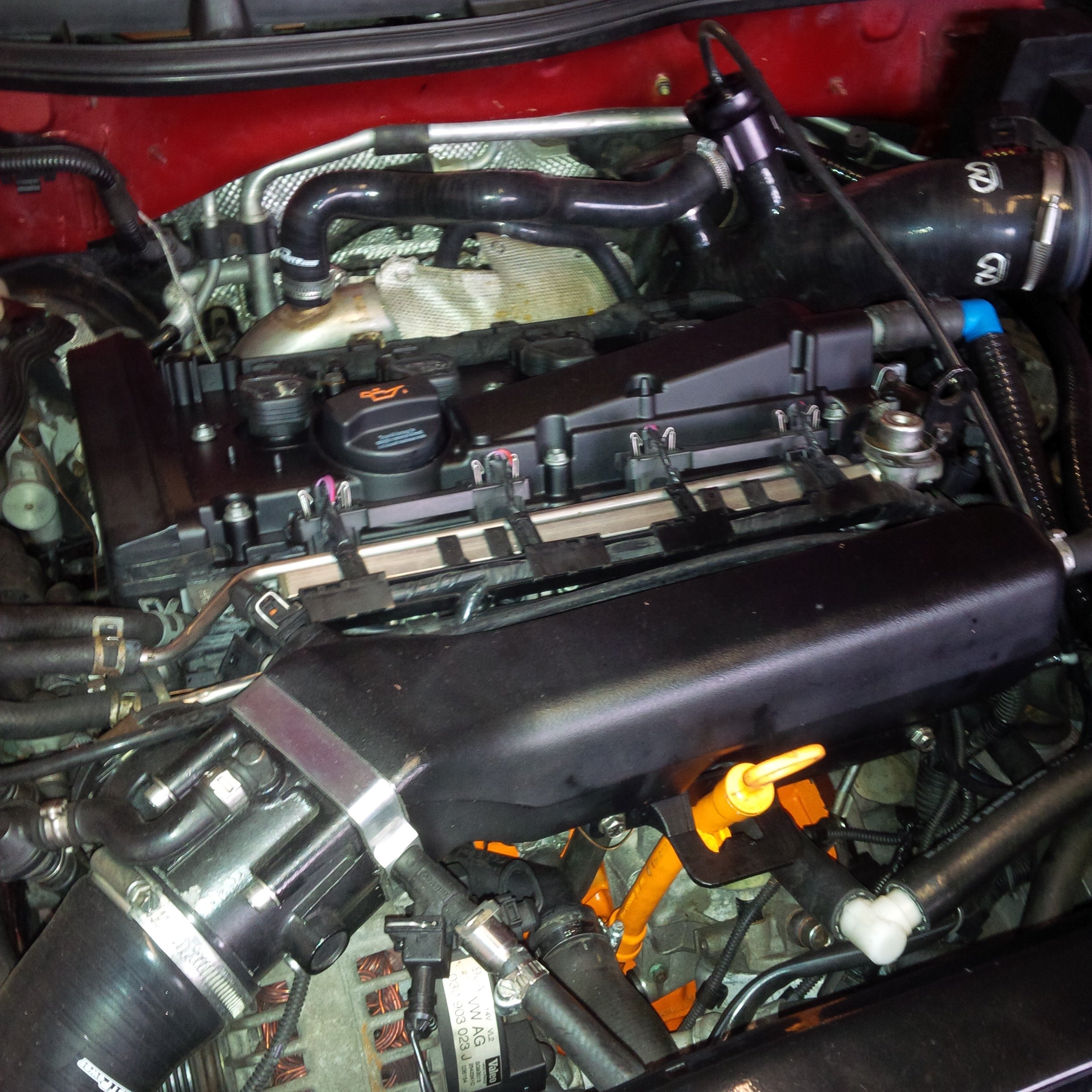

thats it inplace i 3d printed the face. working on another design but works dropped egt by 150deg

mine has lower compression ratio of 8-1 so it wont run so hot. normally 17-20 times the CR is your cylinder pressure
if yours is 9.5 to 1 then it will be much higher but then you run hotter and also you cant run such high ignition timing, 9.5-1 is for street cars to not be so sluggish off boost

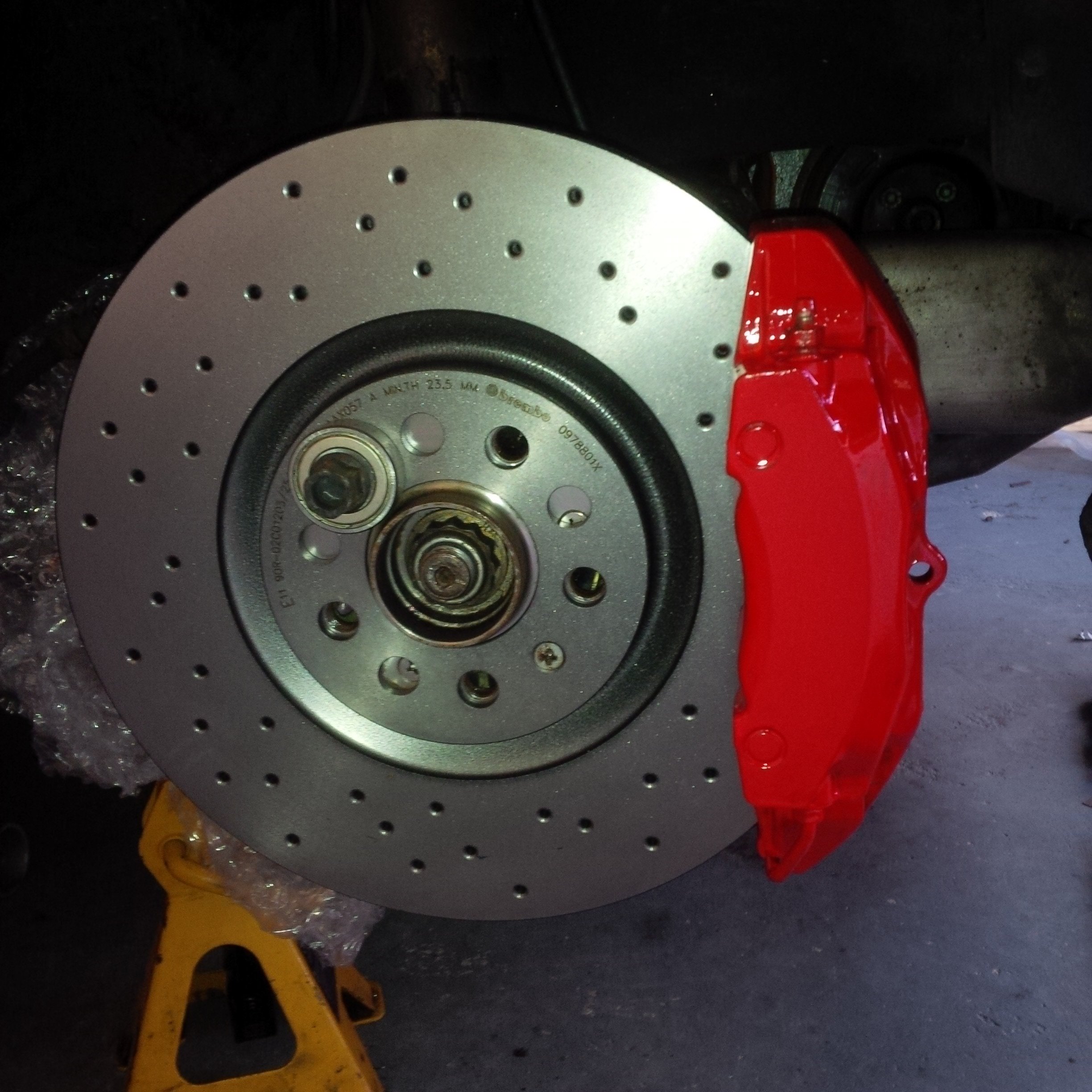

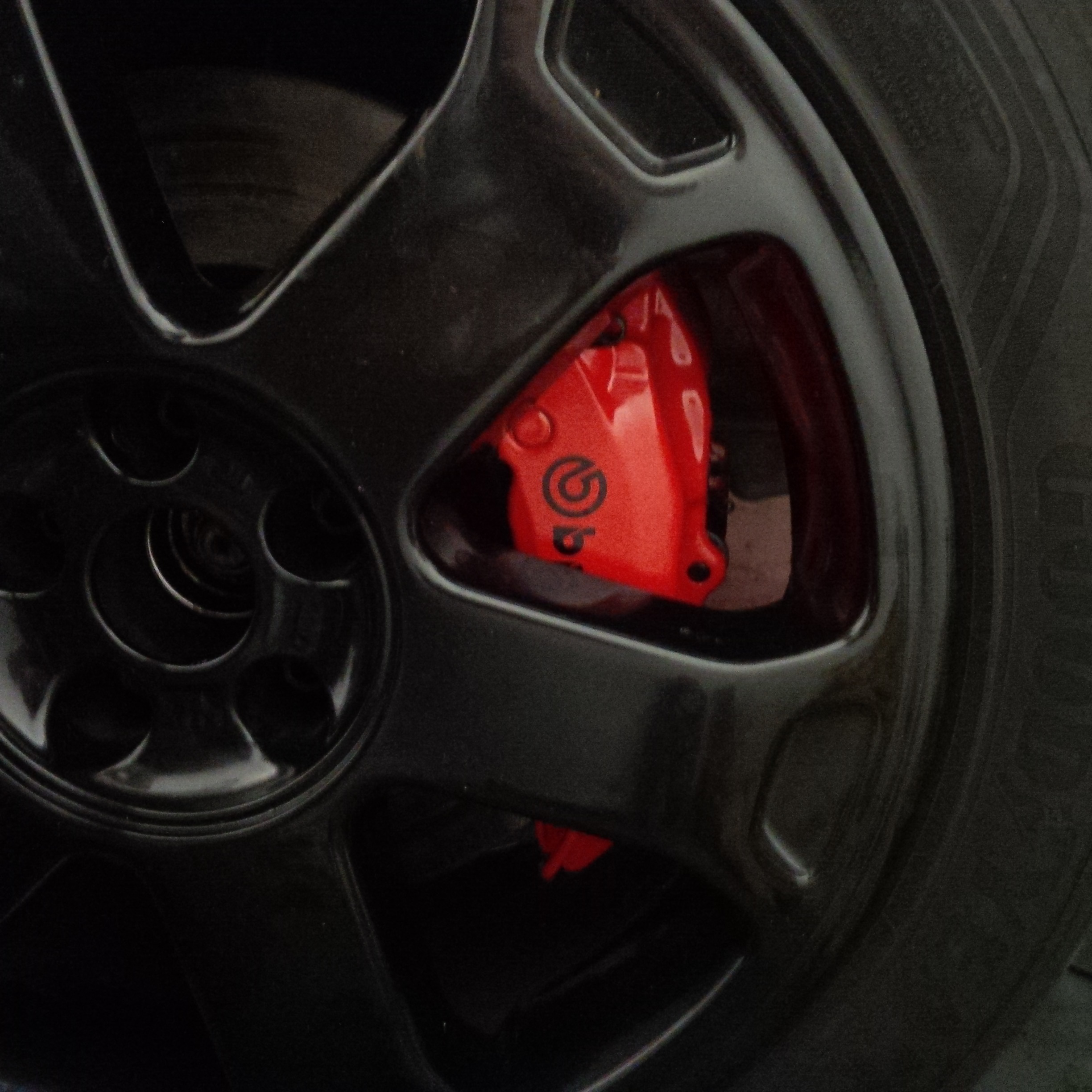

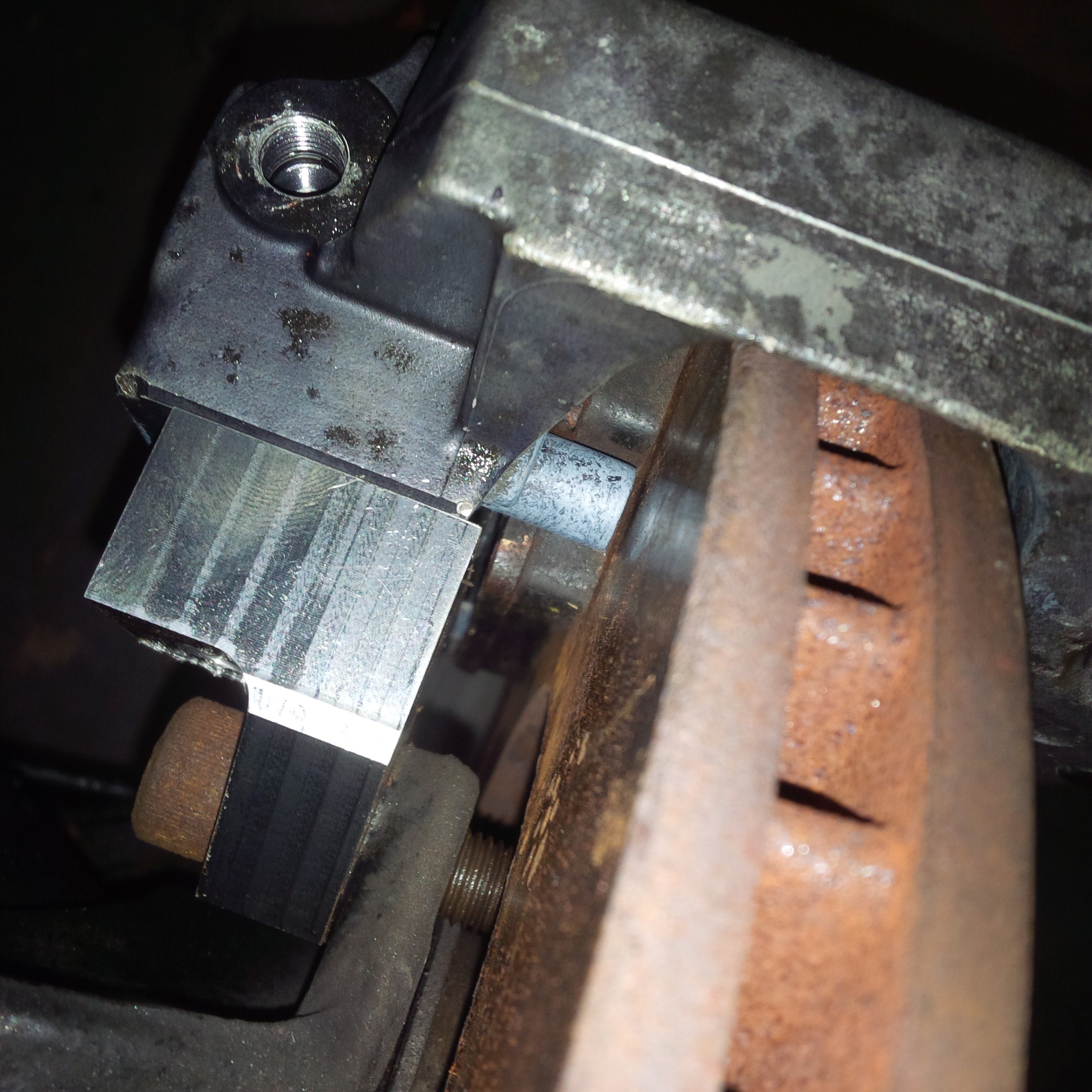

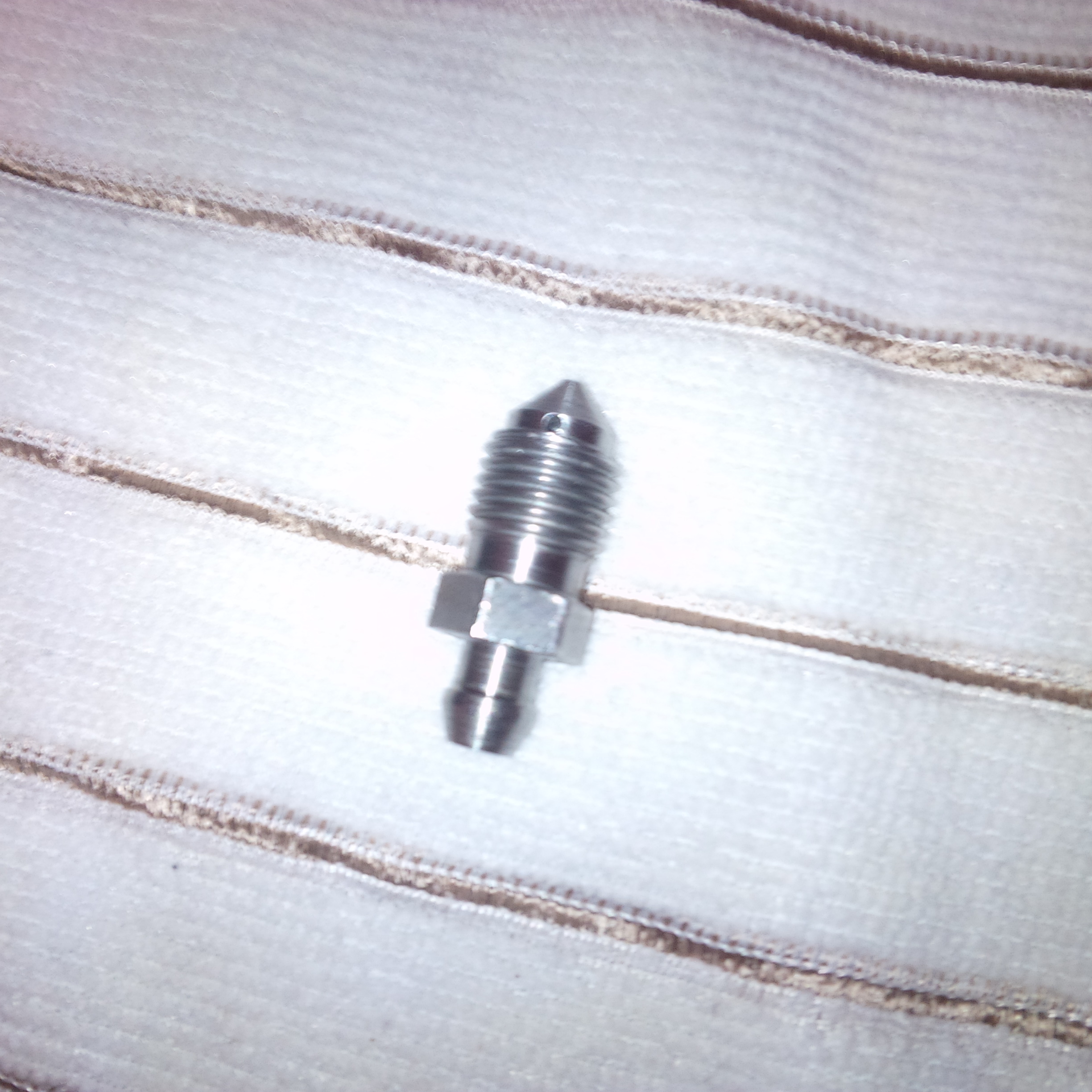

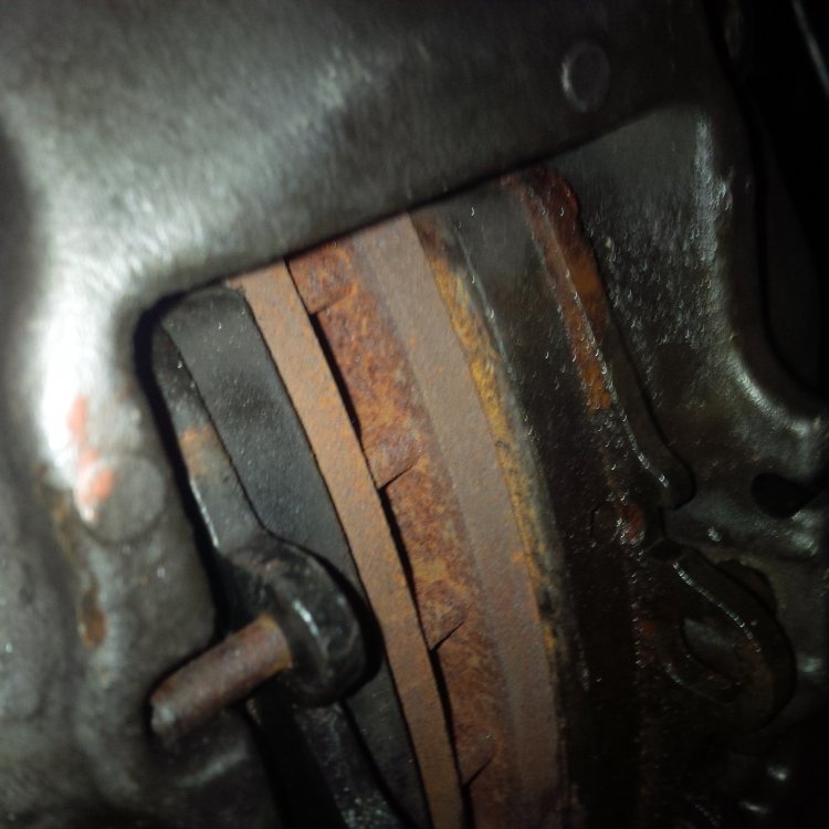

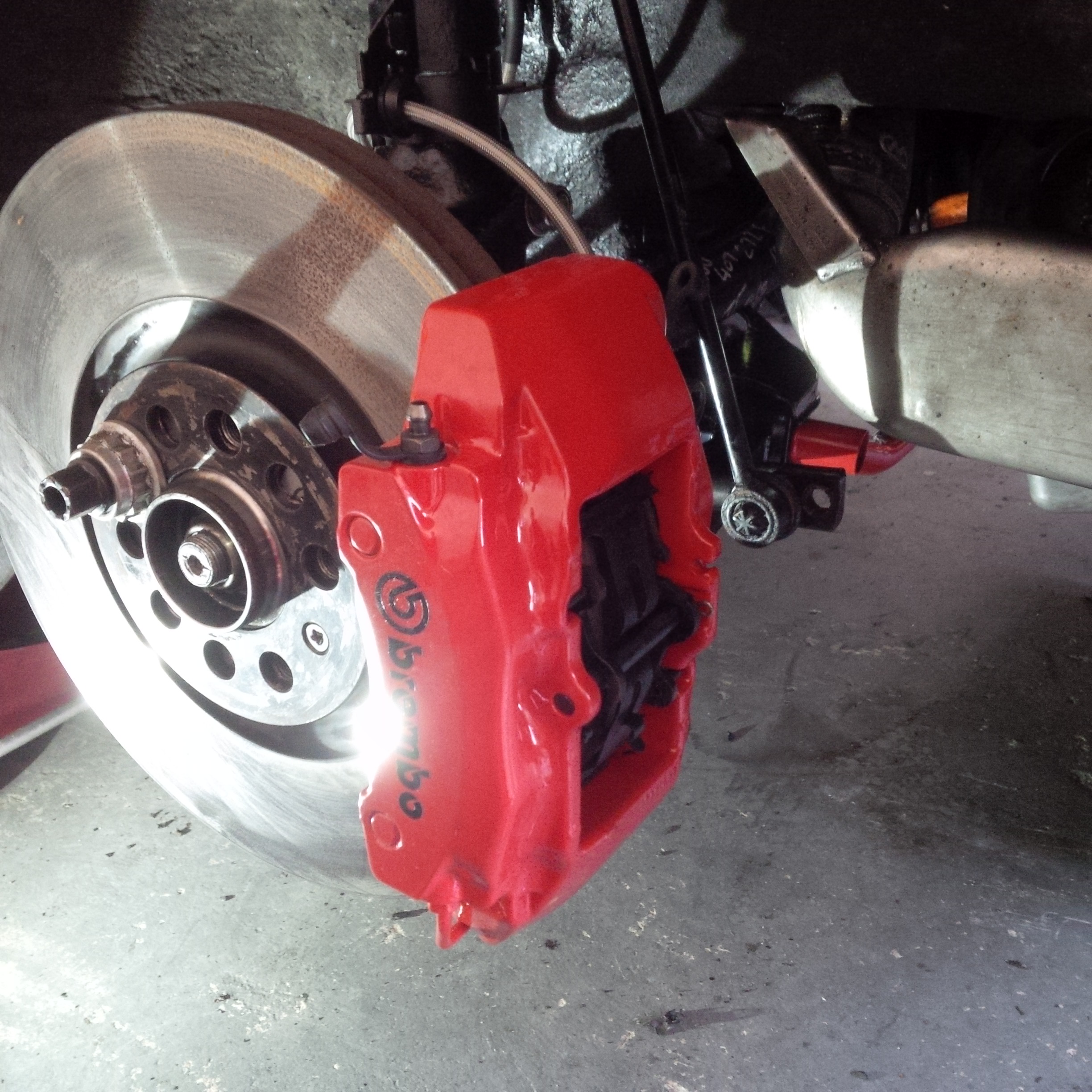

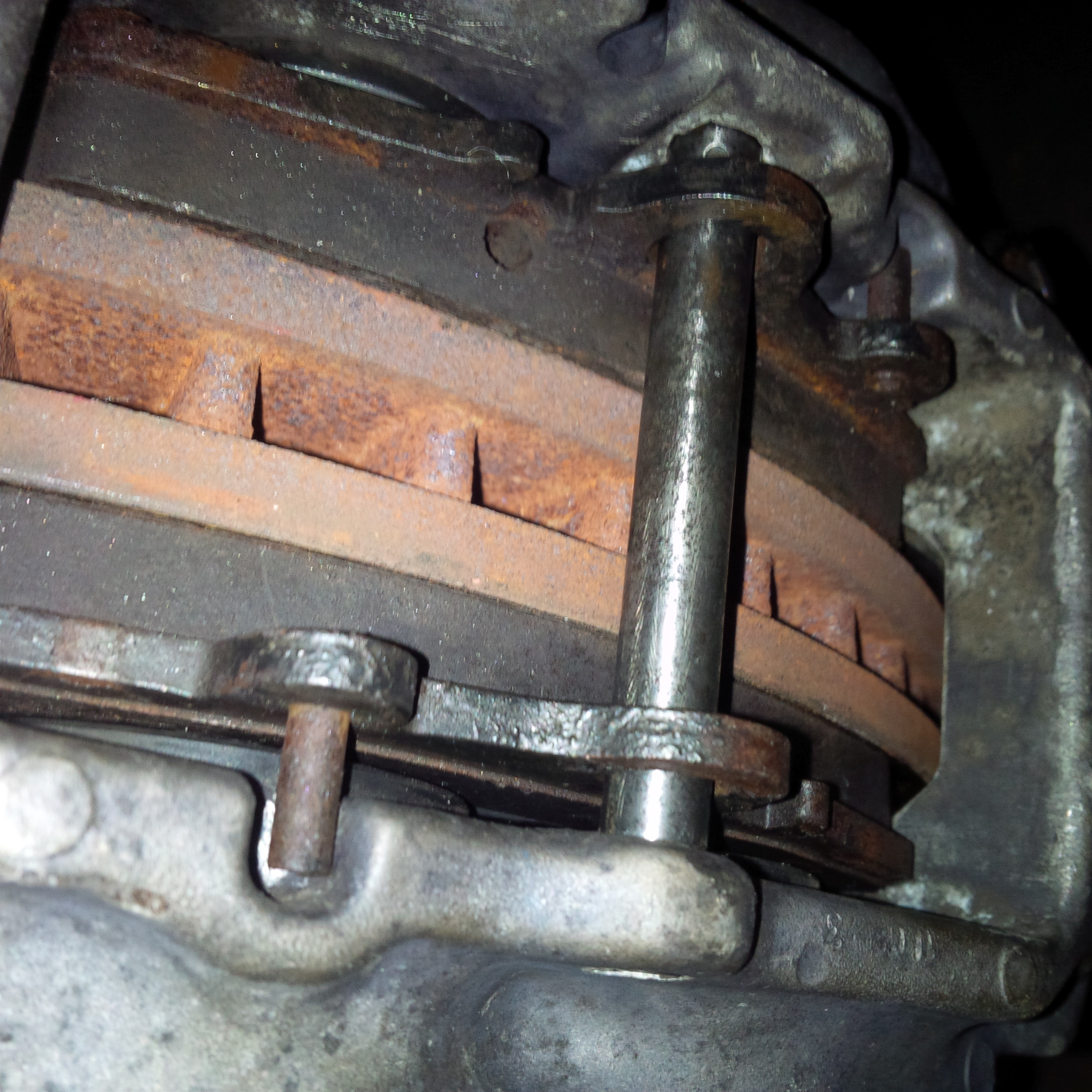

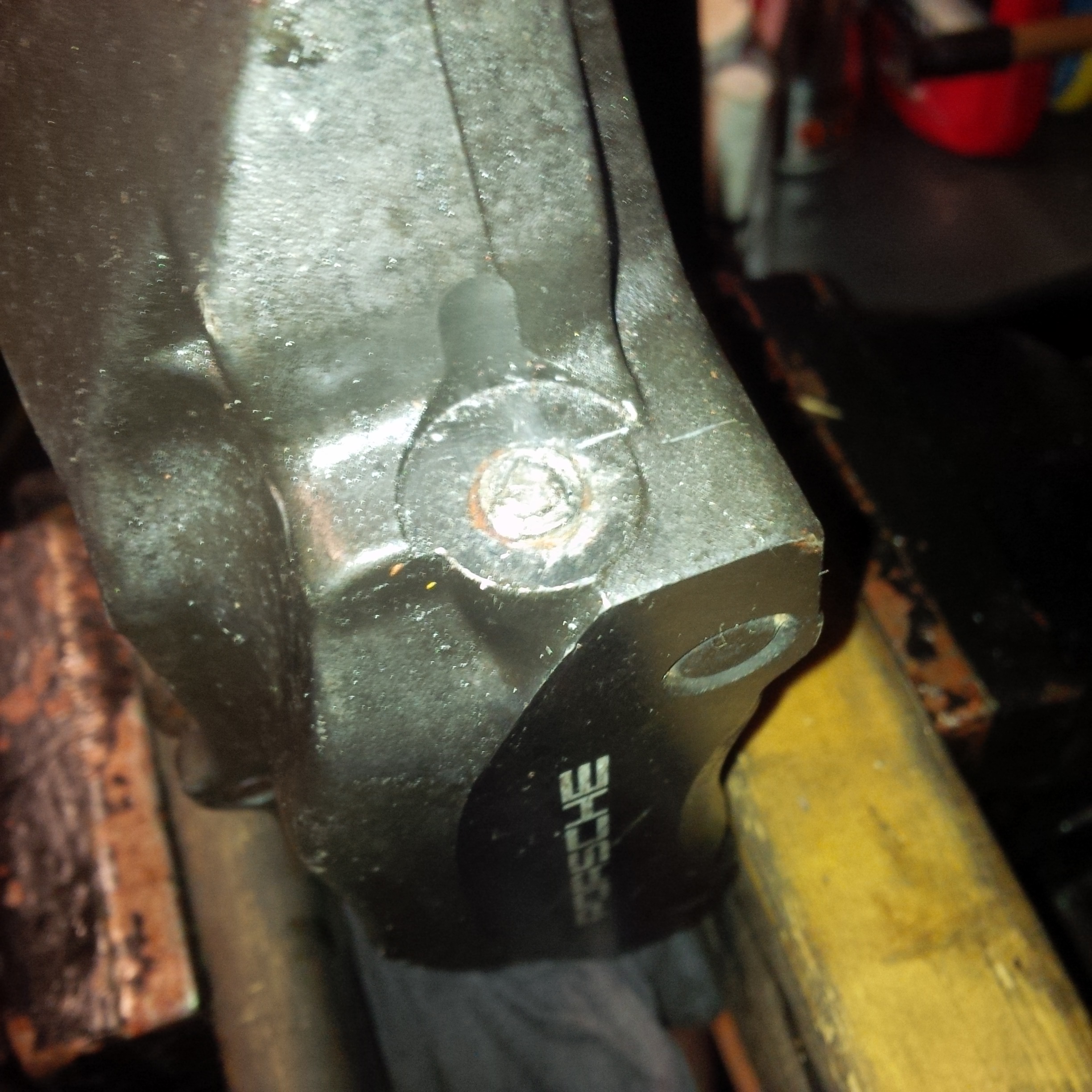

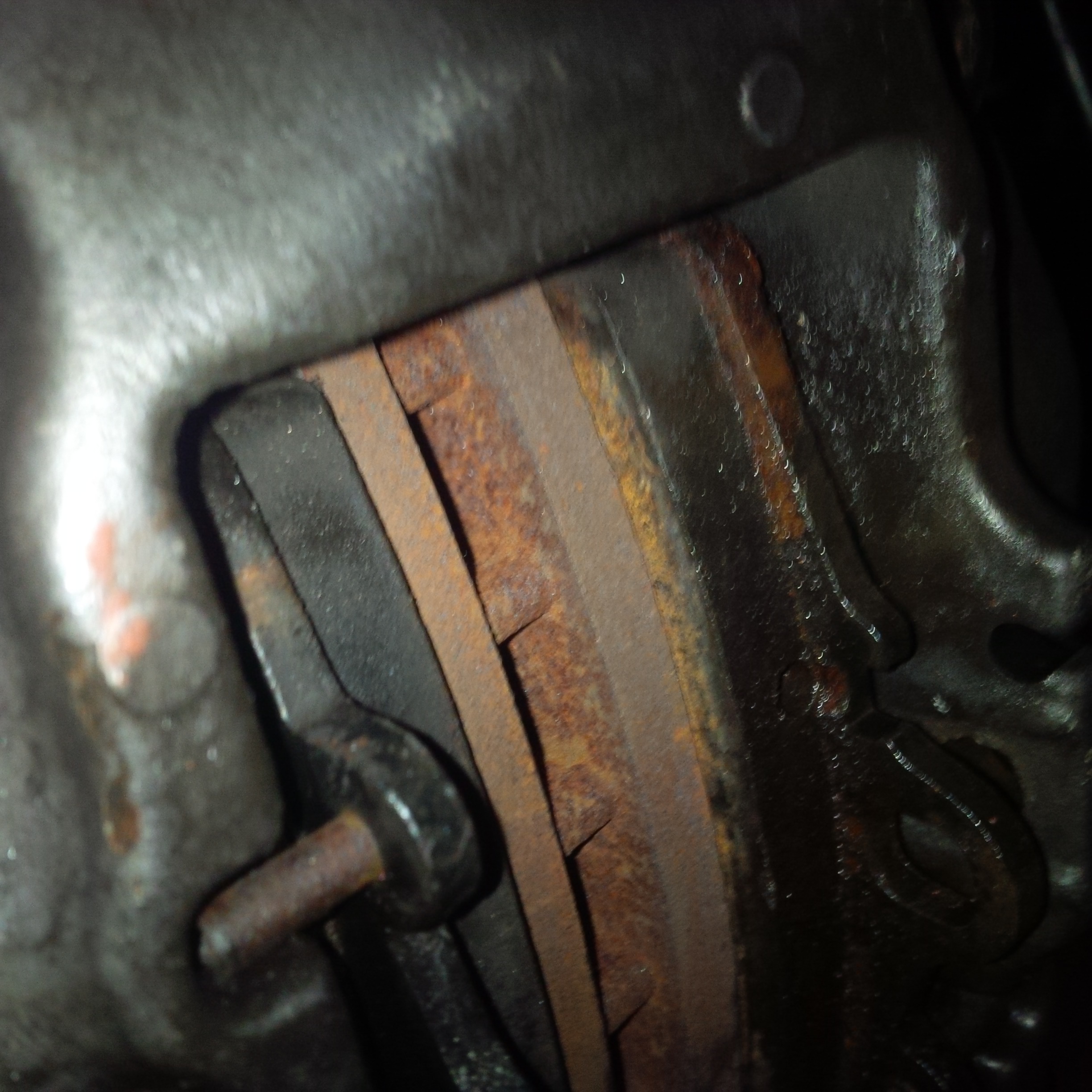

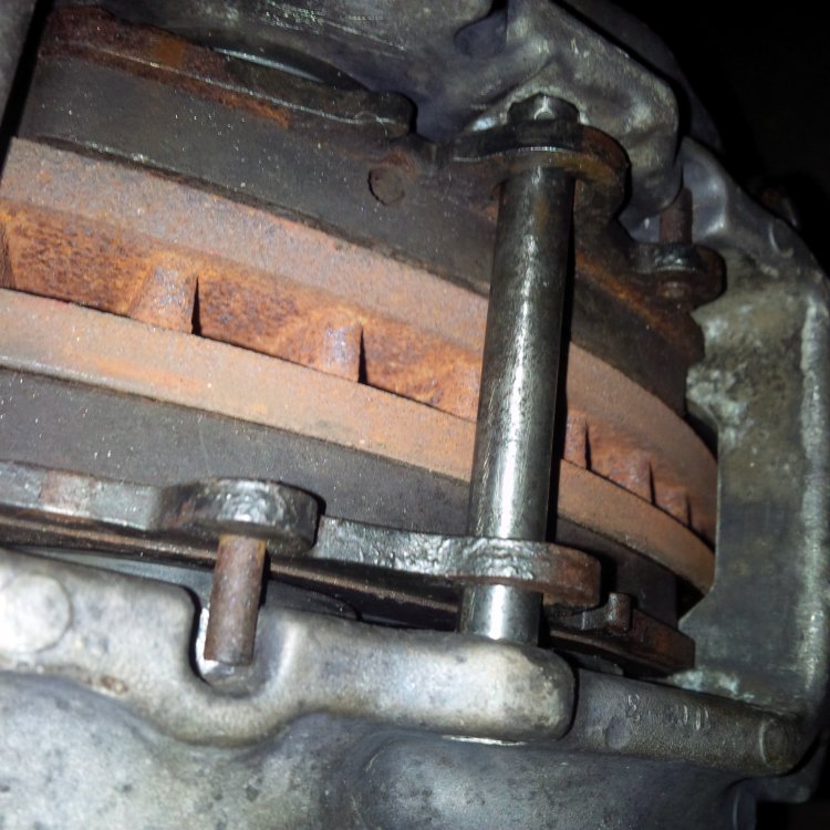

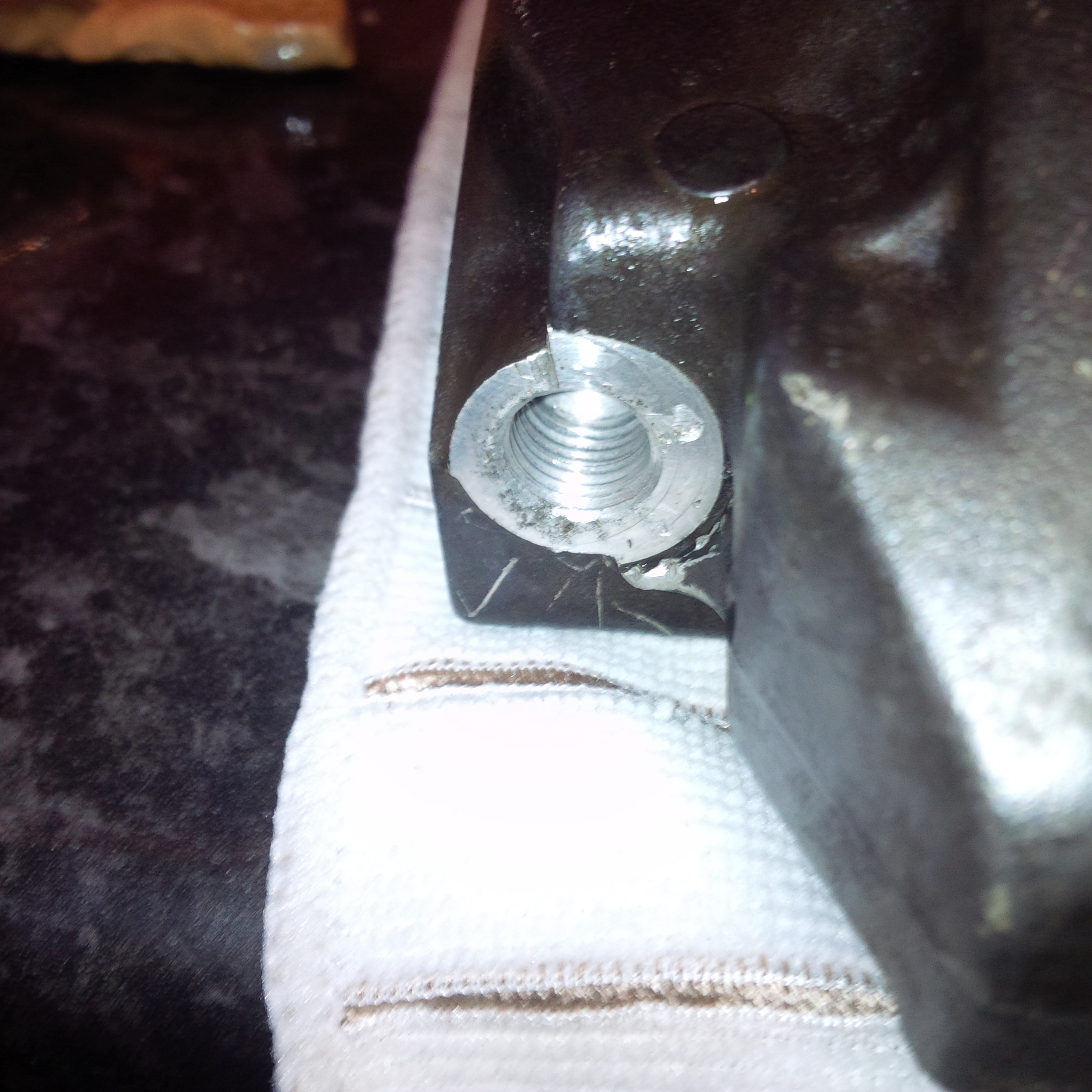

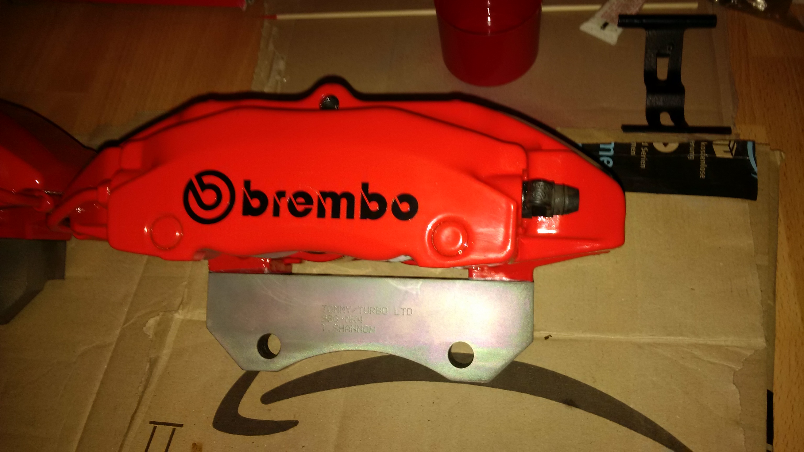

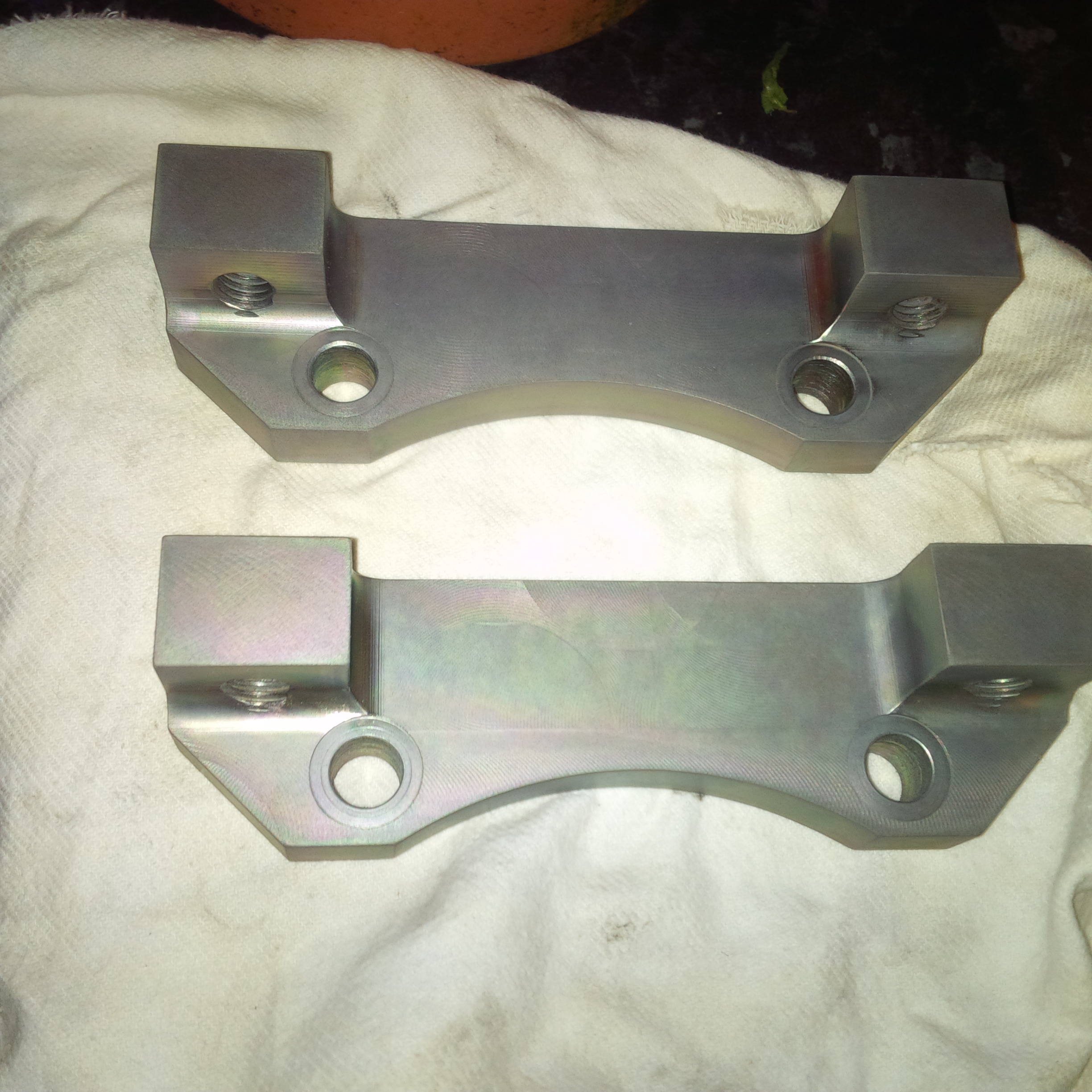

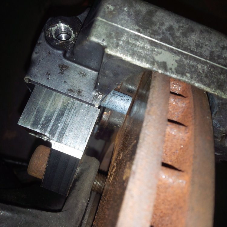

986 front brakes and custom made carriers. Thankfully my old man's got a machine shop. 312mm brembo extra discs. Notice the pad overhangs no more, before and after picture, the cms brackets were junk. Notice the broken bleed nipple and the broken ezy out. I machined it out and made an oversized nipple again at my old man's. Offset is spot on also no grinding pins!

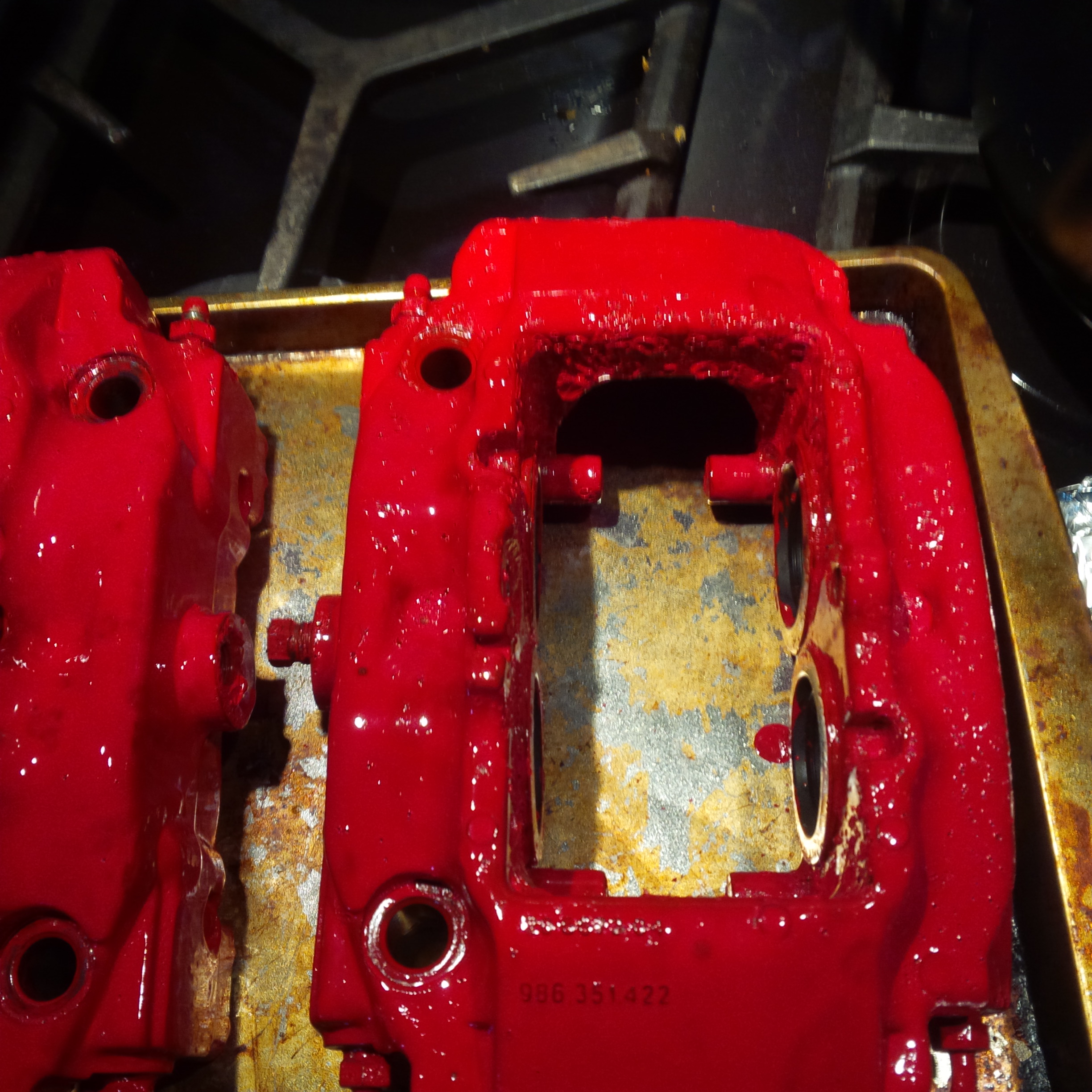

Note to self. Don't put calipers in the oven at 200 deg and go to bed...:(
Sorted.

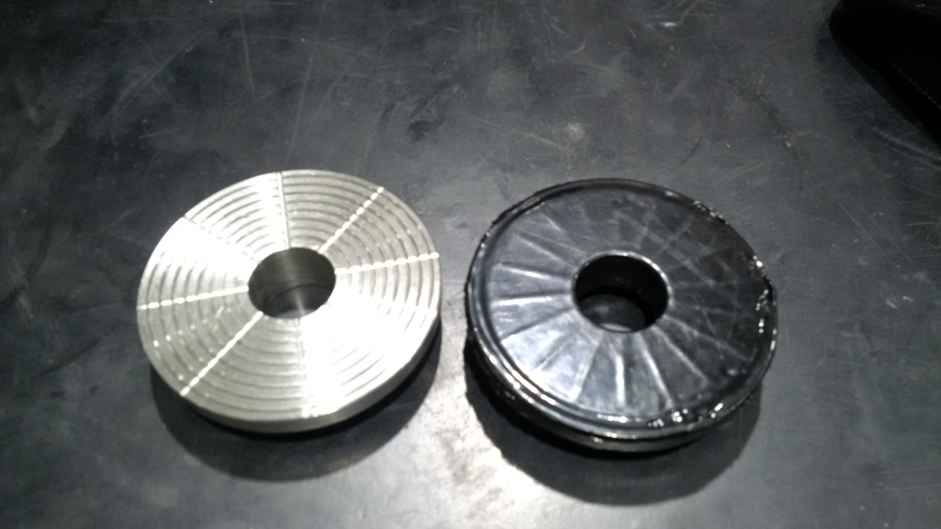

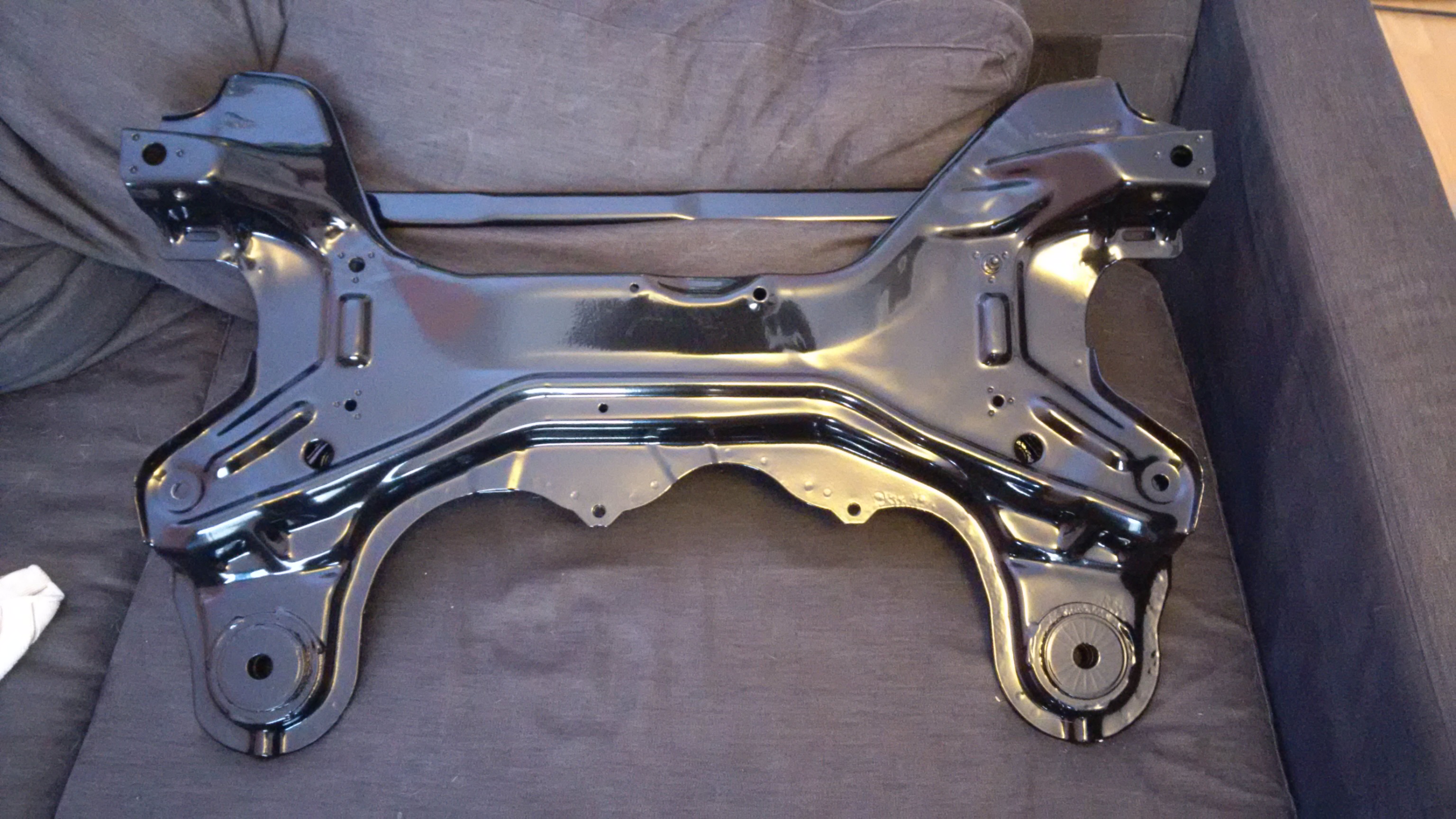

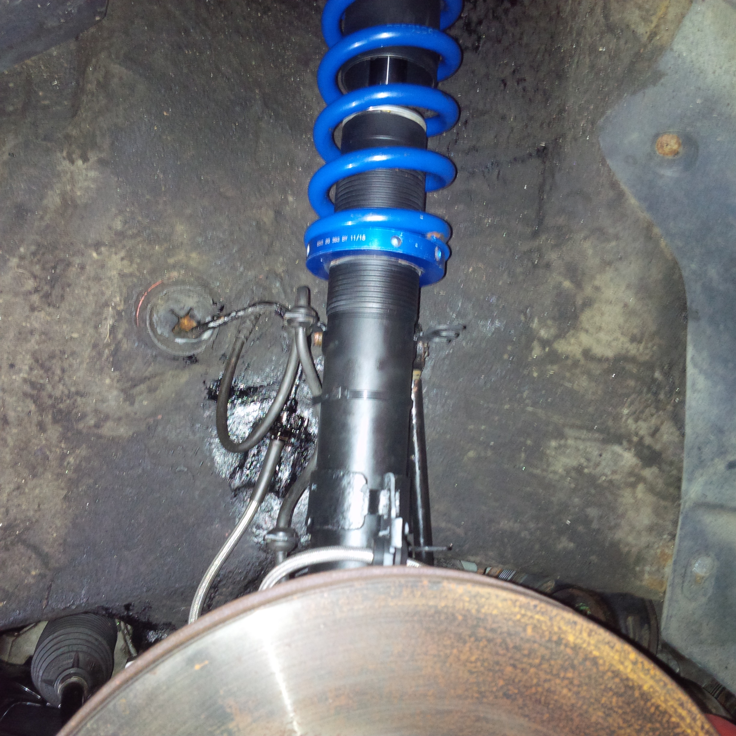

Working on solid bushes for subframe front tt sub frame powder coated after 2 years fitted in Scottish air, only summer  driving rusted the oem one ??? Rubbish oem coating.

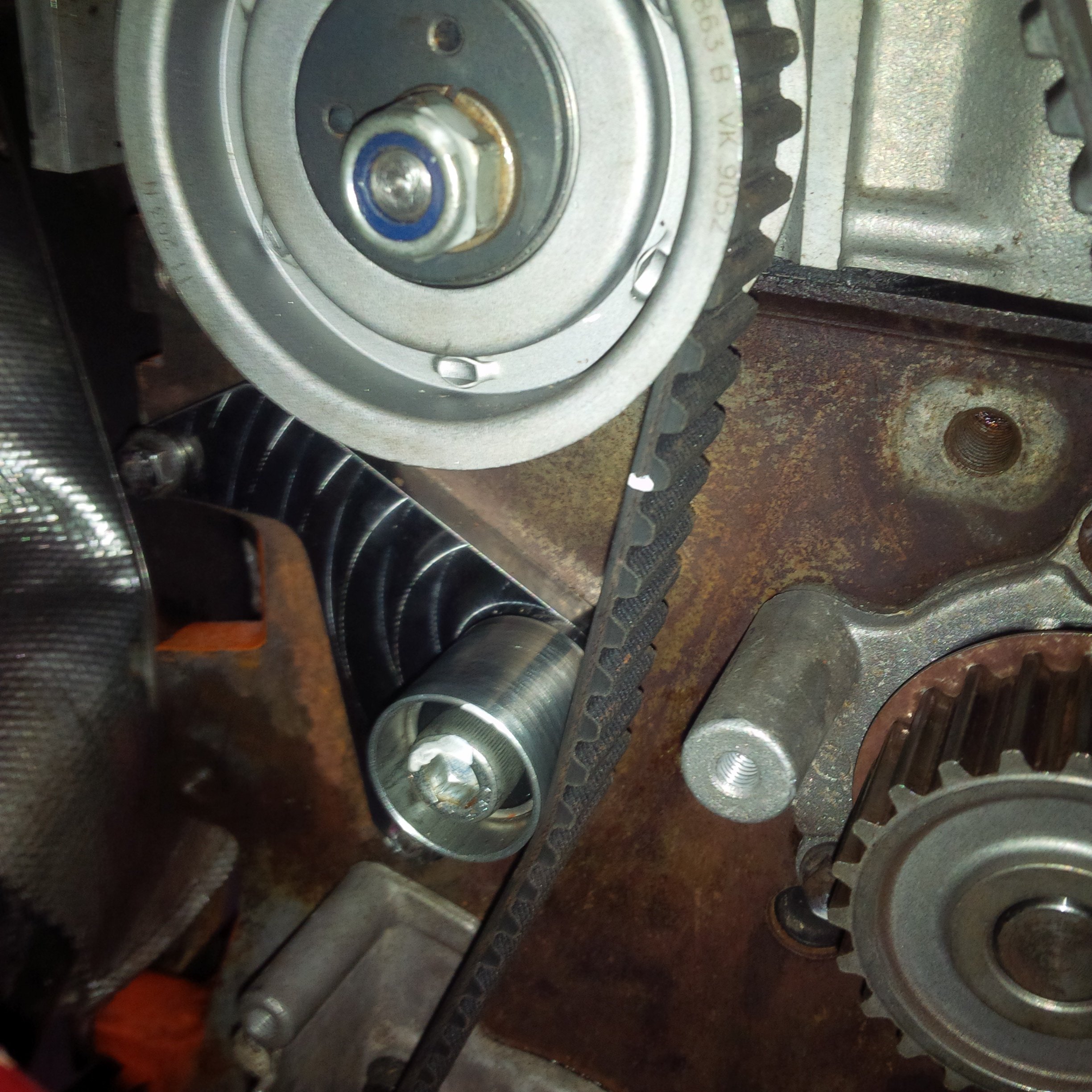

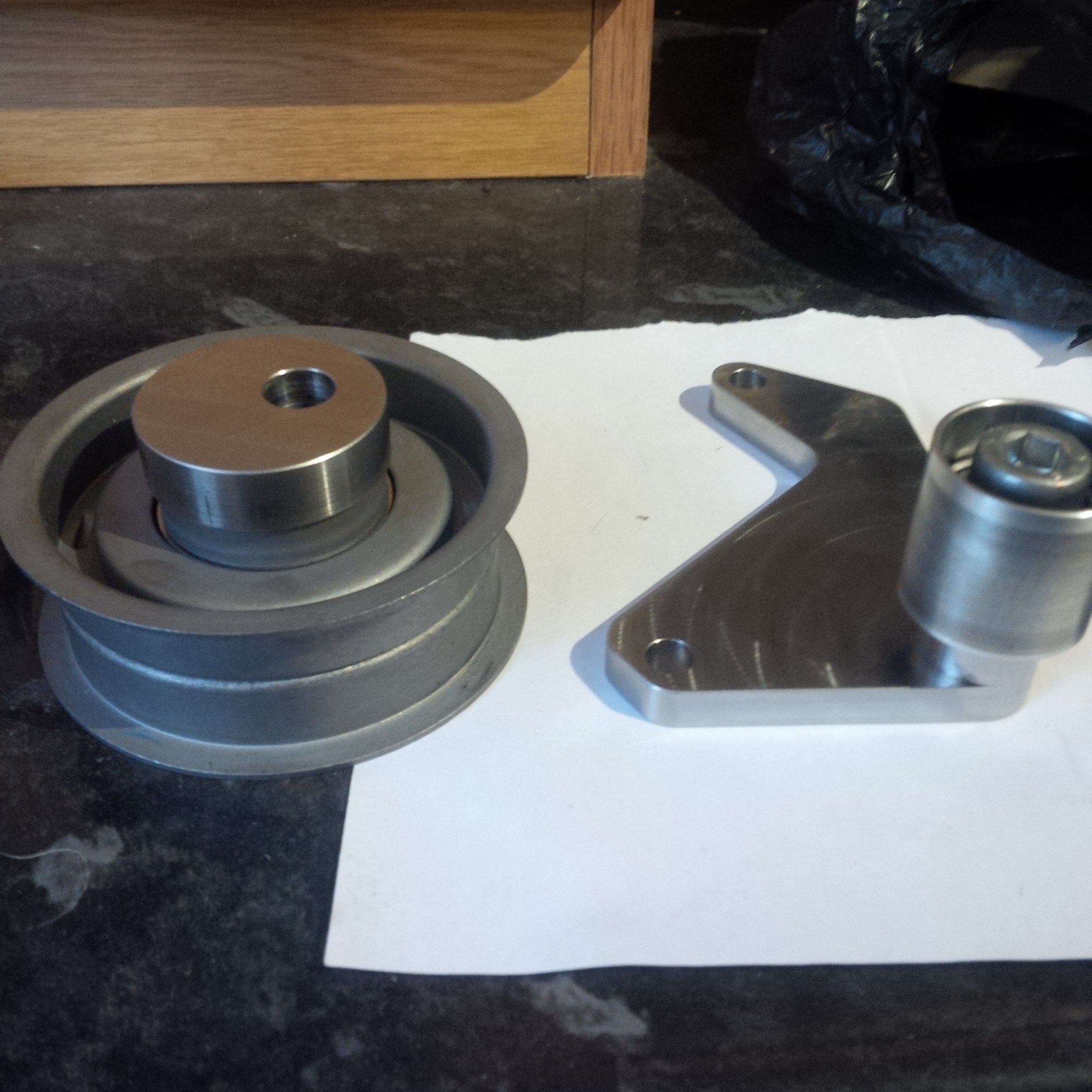

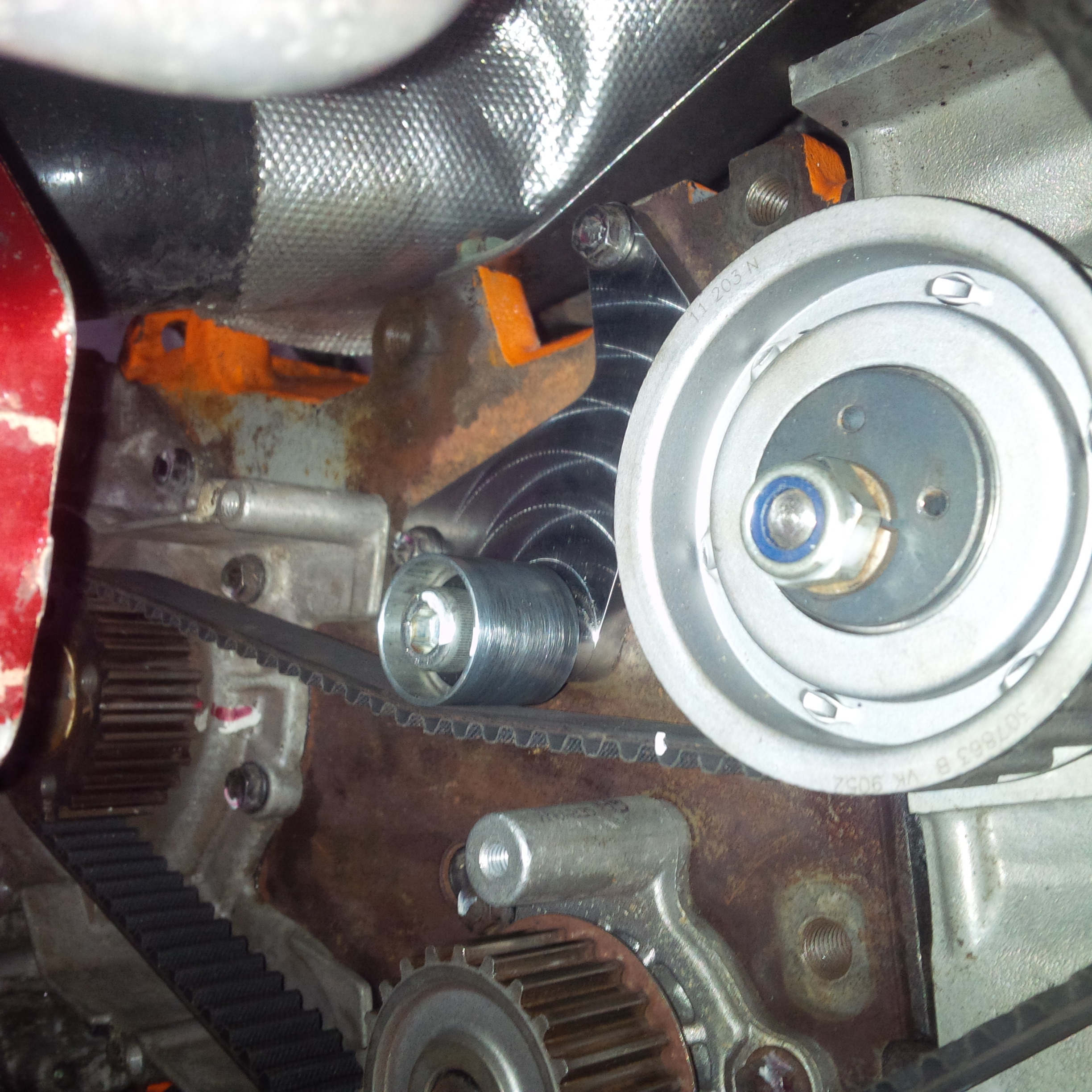

Just some updates. Working on my manual tensioner to remove the crappy hydraulic unit, belt was to tight with the 3mm gasket 8-1 cr
manual tensioner in place and running. 90deg belt flex and 33ft/lbs. no more strange over tight belt noise as you get with the hydraulic units

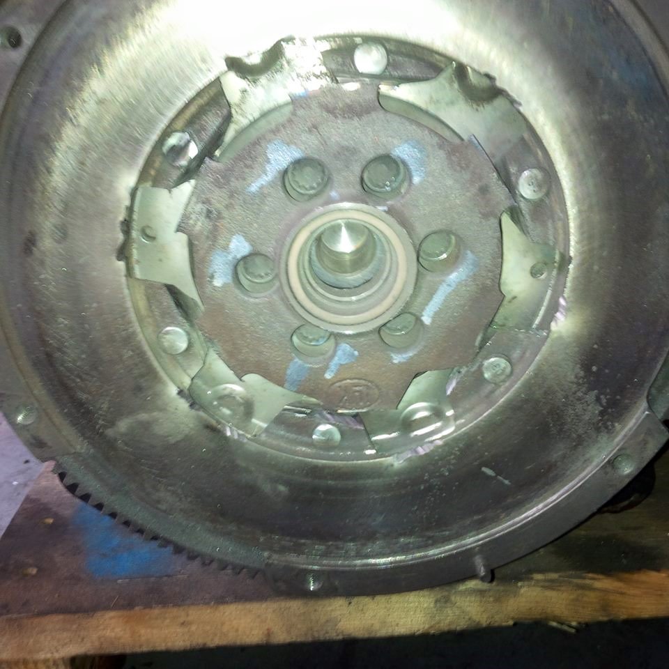

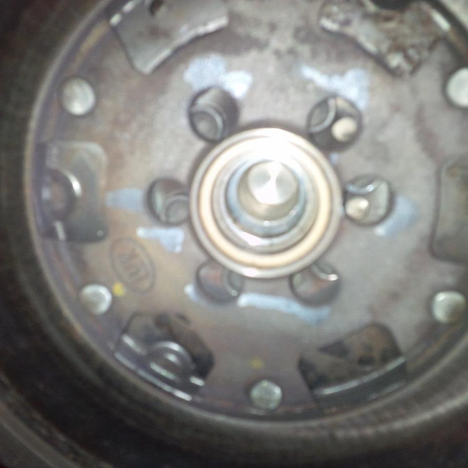

37019800_10160592962865076_8099878398324637696_n.thumb.jpg.2dfd49d88bb79710e5a582dfd2650fd1.jpg37050796_10160595038050076_8756273079031693312_n.thumb.jpg.70d7614f0a867b68f4d54842965f9e7f.jpg
just an update another DMF killed, cg motor sport duel friction still in good condition. this one lasted about 800ish miles
