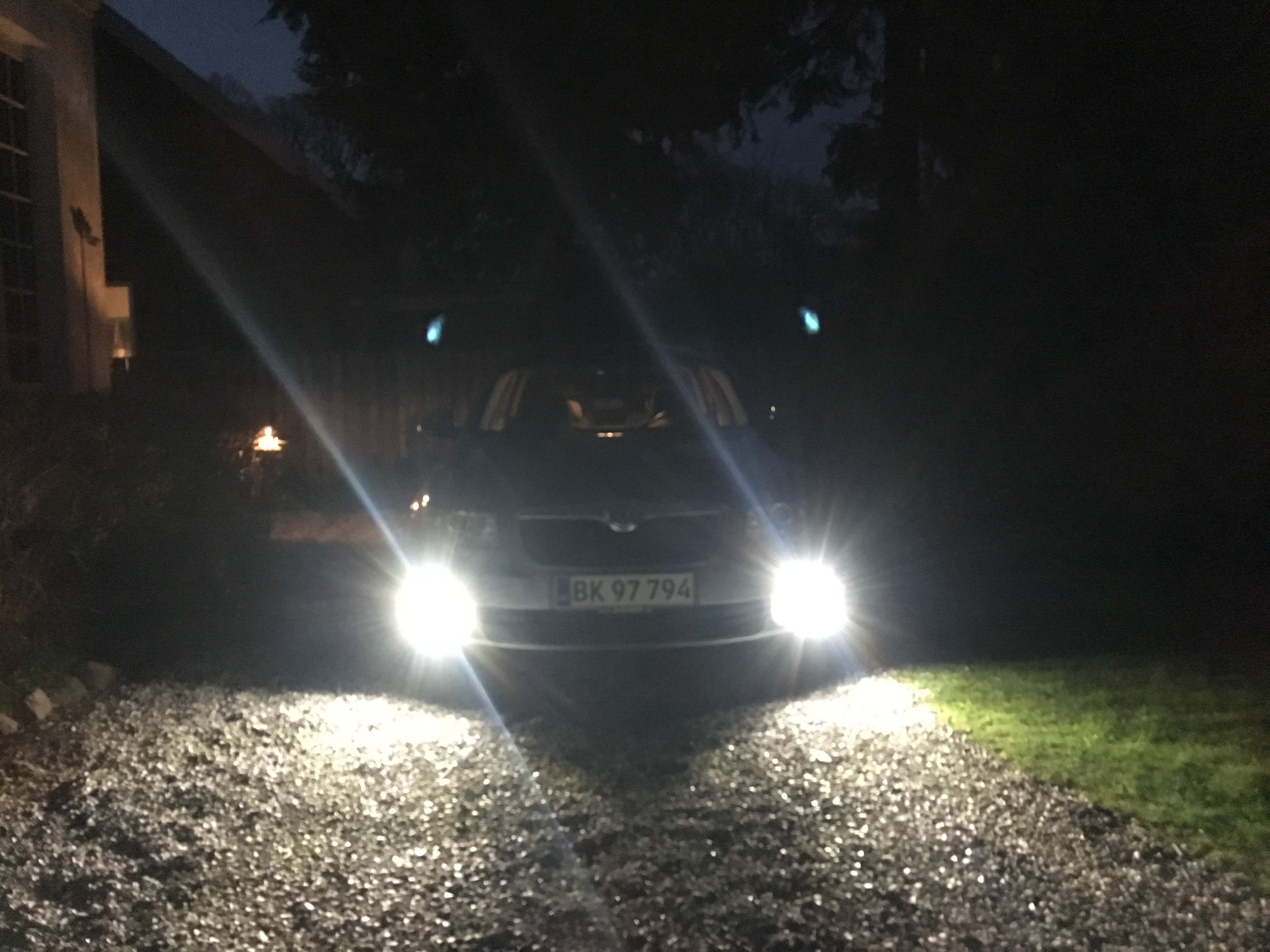

Nope, work perfectly.

No, no issues with warnings. They're around 3 years old and as bright as the day I first installed them.

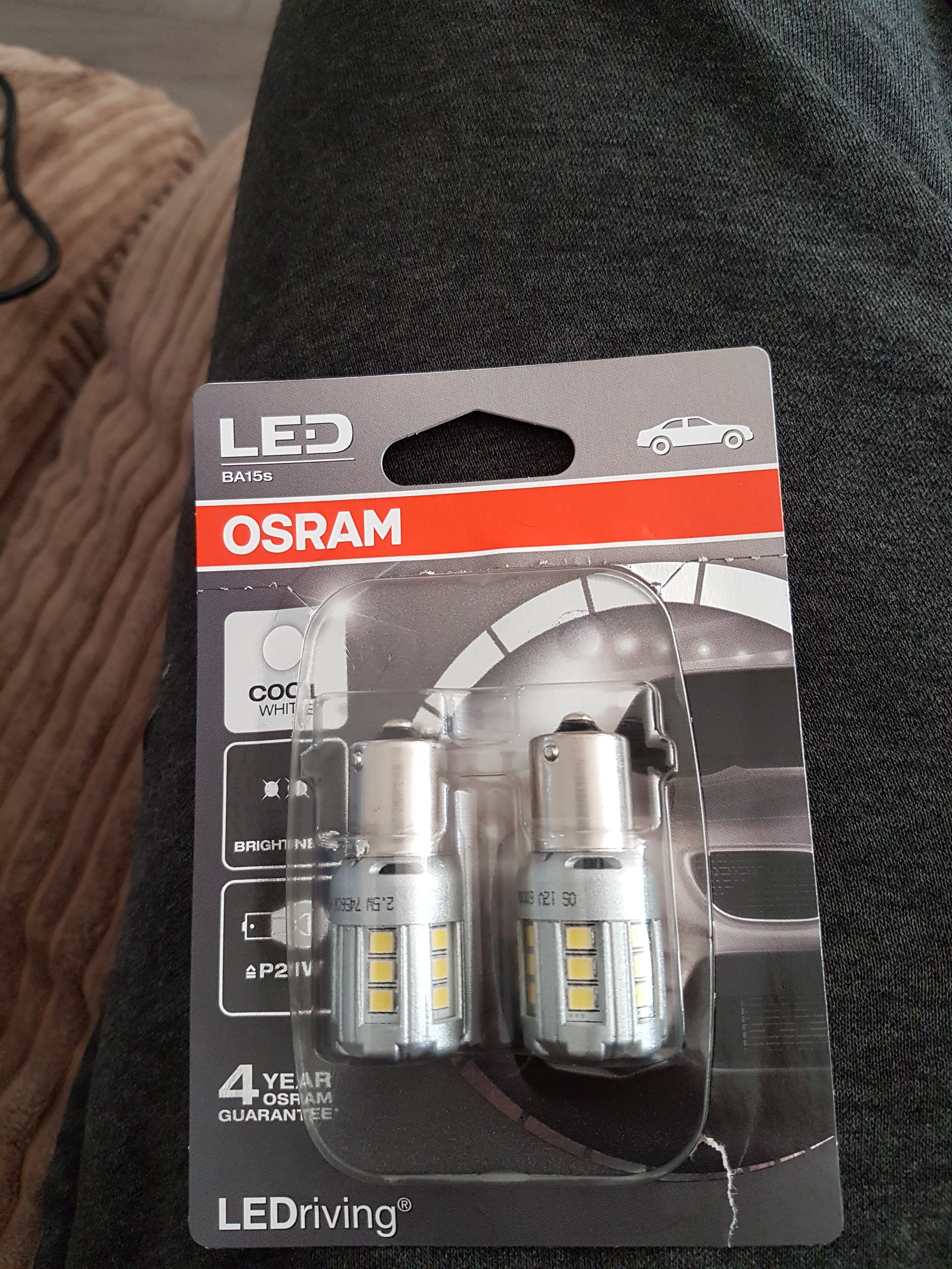

Ok I might look at getting some. I bought these osram ones but they don't work at all. I'm not sure if it's because they are only 2.5w or I also read that the drls are negative centre pin? I'll have to check it out.

Hi, when you say they didn't work well do you mean they were not very bright? I assumed Osrams would be great, but thought they needed a CANBUS adaptor to stop errors.

They didn't work at all in the drls. I tried some cheaper led' s that I had from before and they worked but flickered. The osram ones wouldn't work even slightly.
I tried them in the rear fogs just to make sure they do work and they worked. Really confused me.

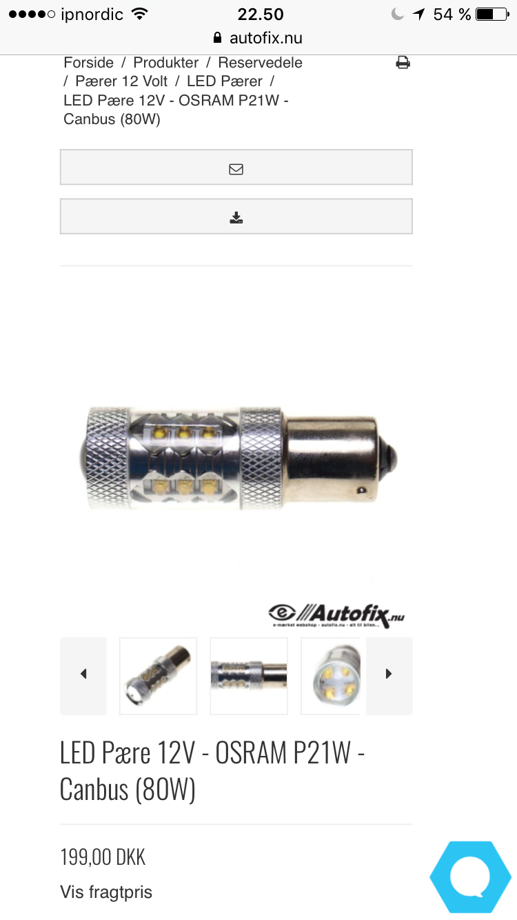

I also just purchased a set of LED DRLs for my 12' Superb. They are Cree bulbs built with canbus in mind. Plug and play and they work great. No warning lights and no flickering etc.
