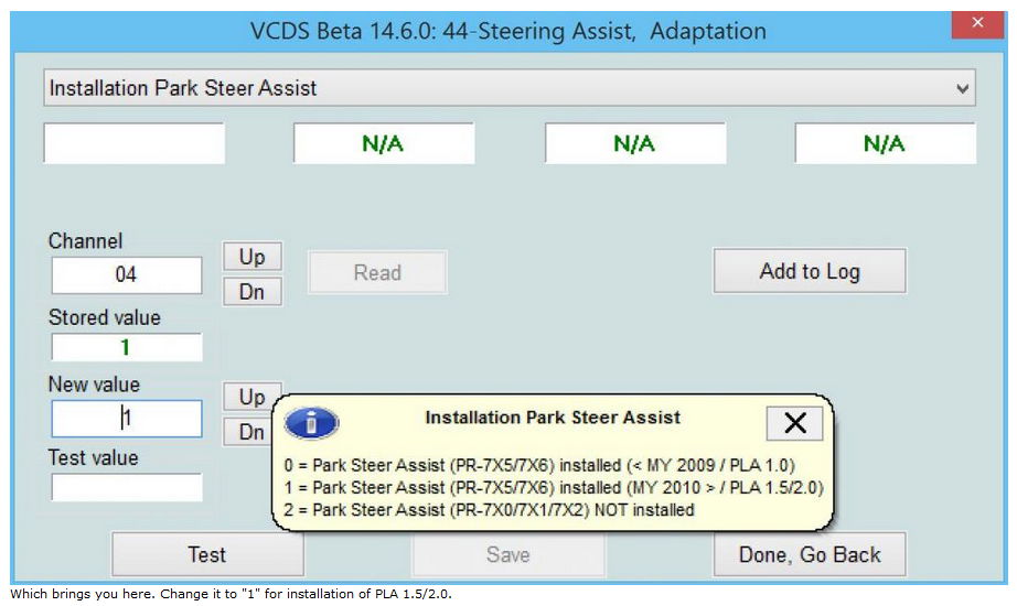

If the car came from a dealer, go back to the dealer. Otherwise you need VCP or VCDS and check a few settings. Our 2014 has PA II and it was not working until I changed / corrected some settings. Unfortunately the dealer was not much help here.

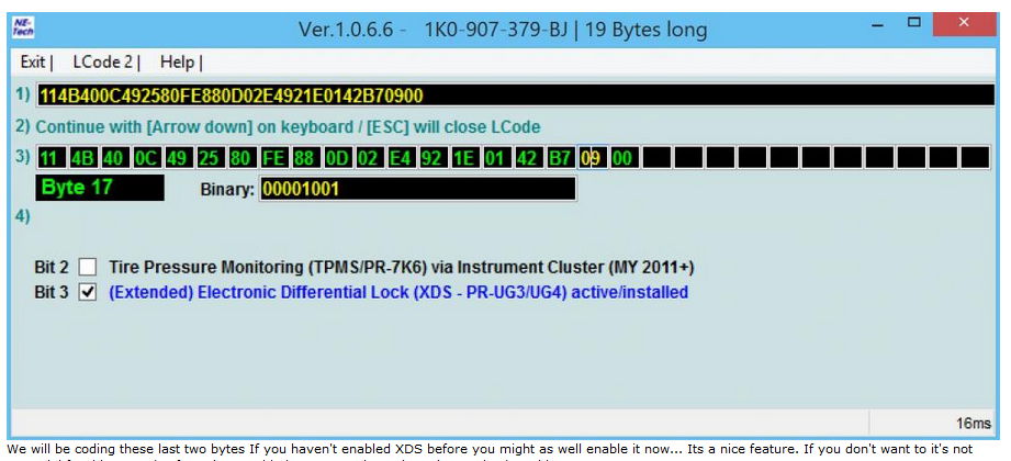

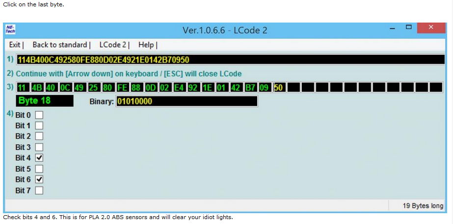

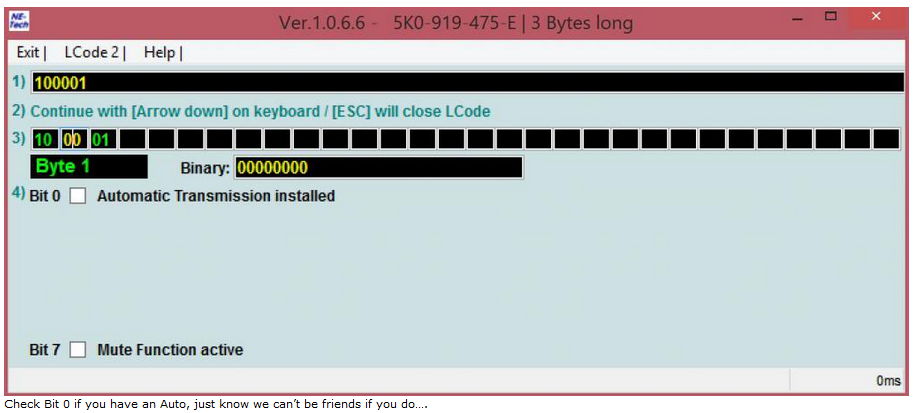

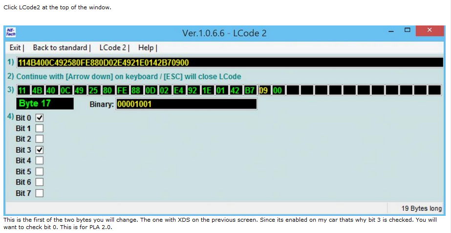

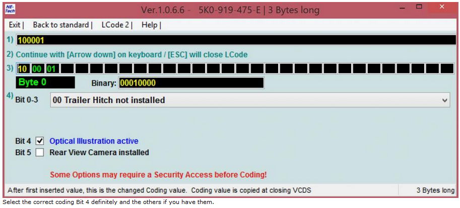

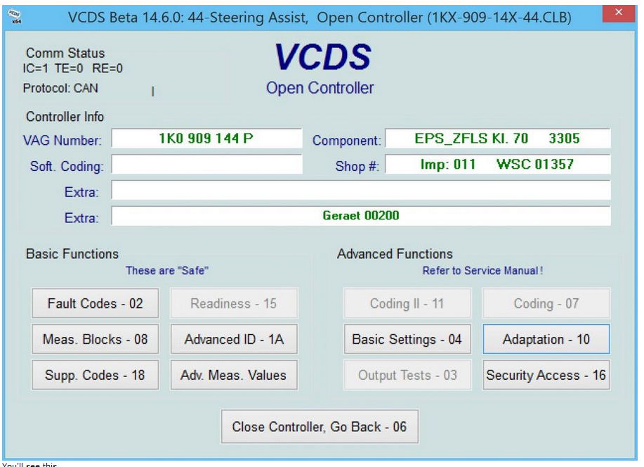

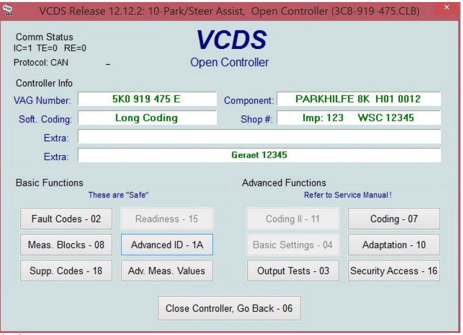

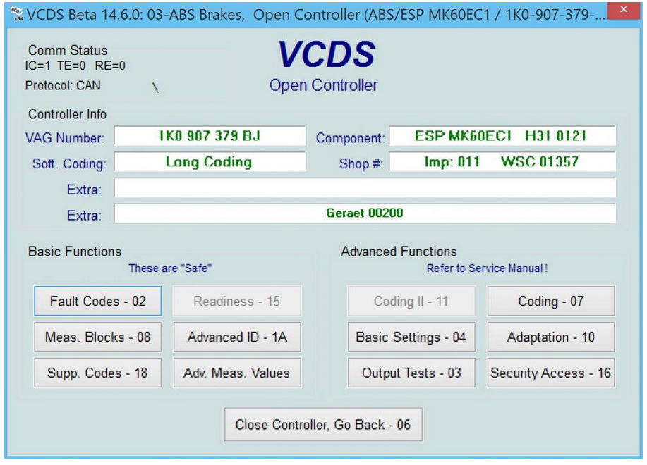

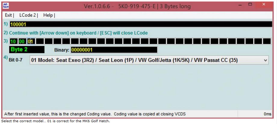

I have attached the instructions I followed to fix mine. A guy put PLA into his car and he put the coding steps online. I took screen shots of his VCDS and he put remarks below each screen.
Thank you so much.
It was disabled on my superb, and driving me nuts.

It was deactiaved and kept on telling me i was going to slow.
Under 44 steering thing it channel 4, it was coded as a 3 instead of a 1. changed that and now she auto parks for me. :D
