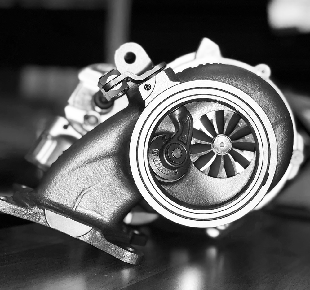

Christmas update! I got the car back a couple of days ago with the new turbo installed. Due to the holidays the map is not completed so only running 1.7 bar (with over 2.2 to come). Even with low boost the car feels great and turbo spools from lower rpm as expected and is very smooth. The APR dsg map that I also just installed is great and gives me adjustable rpms for launch control and allows fully manual operation in M mode without changing up automatically while in gears 2 to 5 and also not kicking down automatically either.

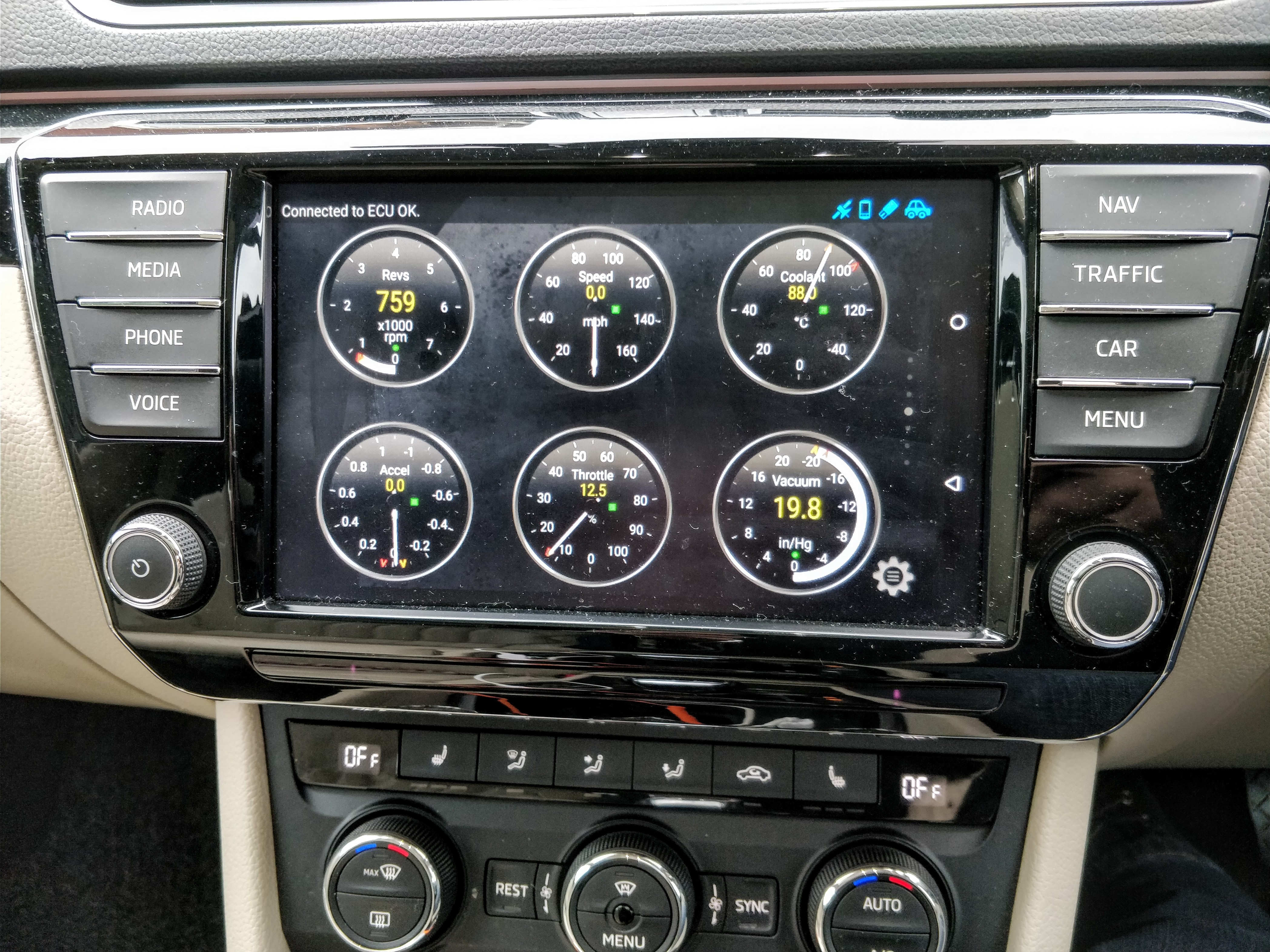

Android torque app on the infotainment system through mirrorlink.
I have the exact same app. How did you manage to get it appear through Mirrorlink. I’m running it on a Samsung Galaxy S6 Edge but it won’t appear as an app via Mirrorlink. I have got the Pro version installed. Any help would be greatly appreciated.
Depends on the phone unfortunately. Did not work on the Samsung Note 4 but works on both the HTC M9 and the LG G4.
Damm, looks like I might be up for a new phone.....bugger!!!!!
I have a spare G4 :)
