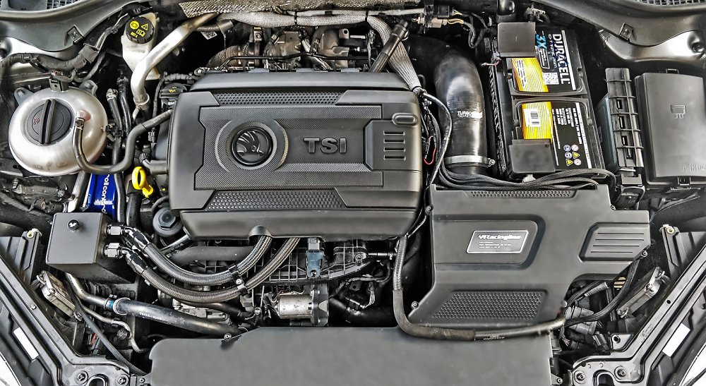

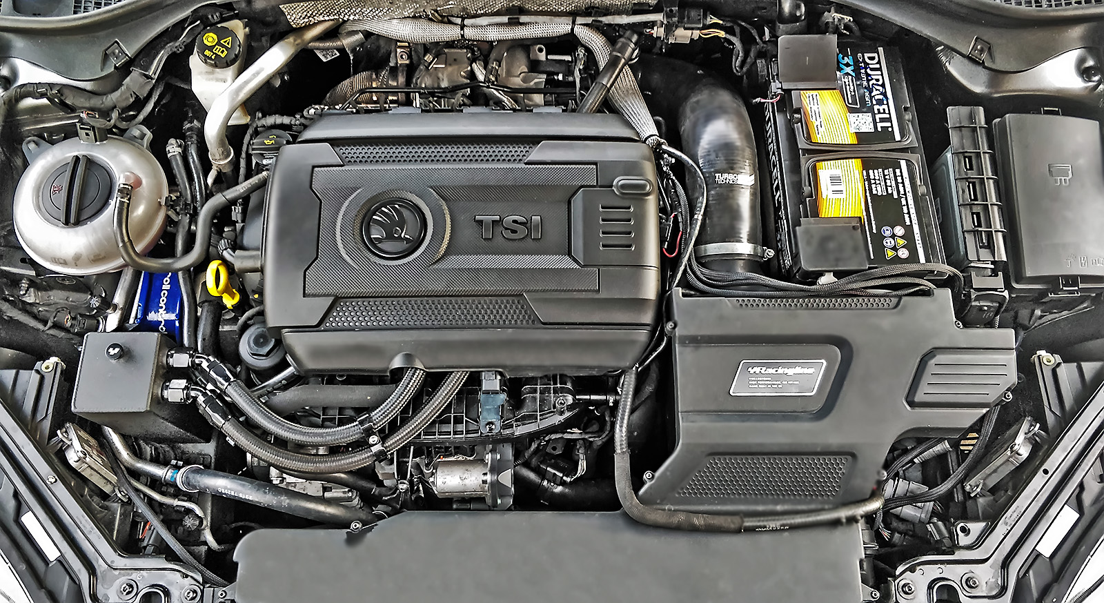

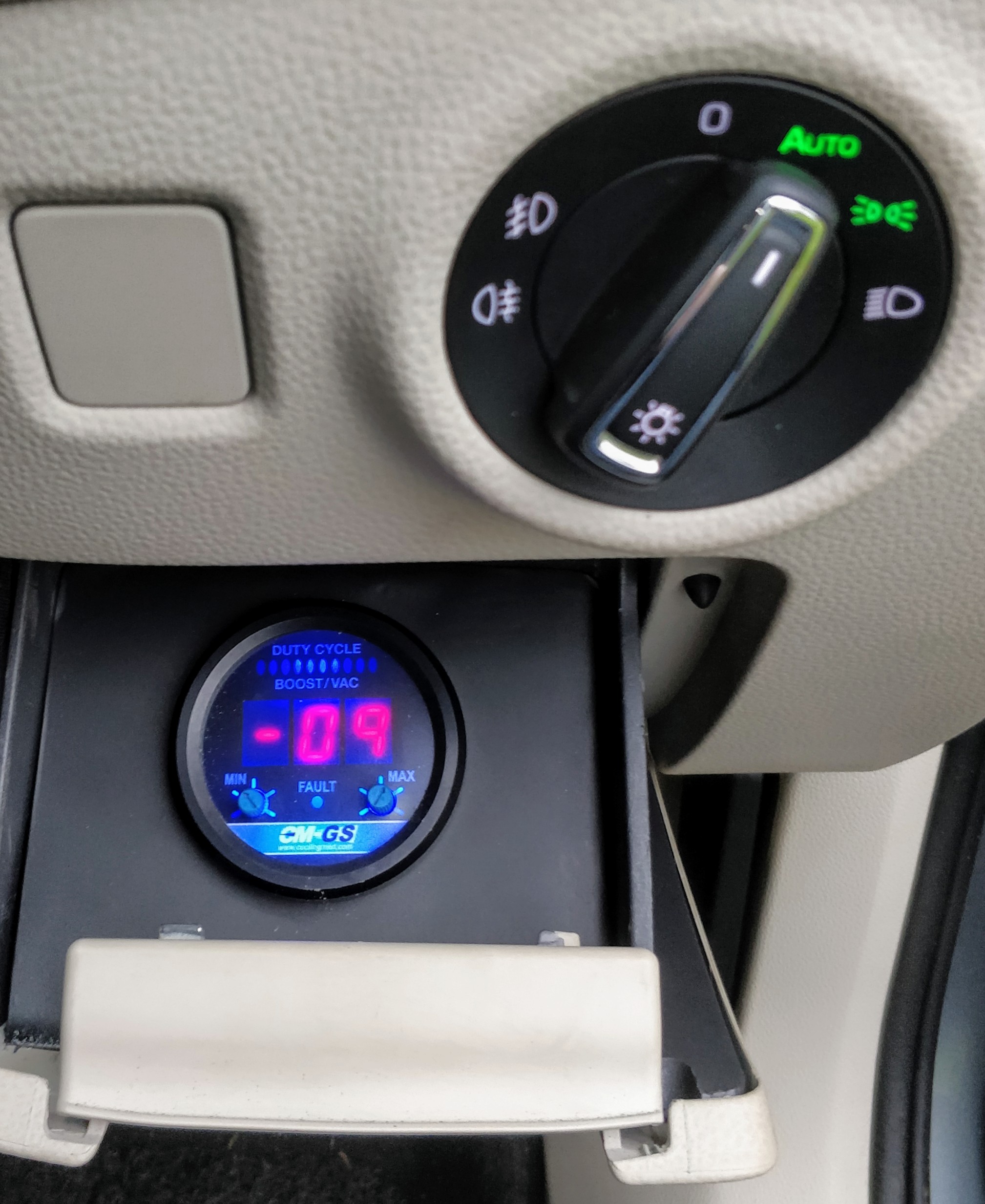

20 hours ago, superbtte said:
Map has been tweaked with the Turbo Technics V4 and is now running at 2.3 bar.
Battery has been replaced with an even larger one (Duracell 80ah, 800amps) and the battery tray modified accordingly, tight fit!
JB4 removed and a dedicated water meth controller installed with digital controls/boost gauge.
Next step possibly a v5 or v6.

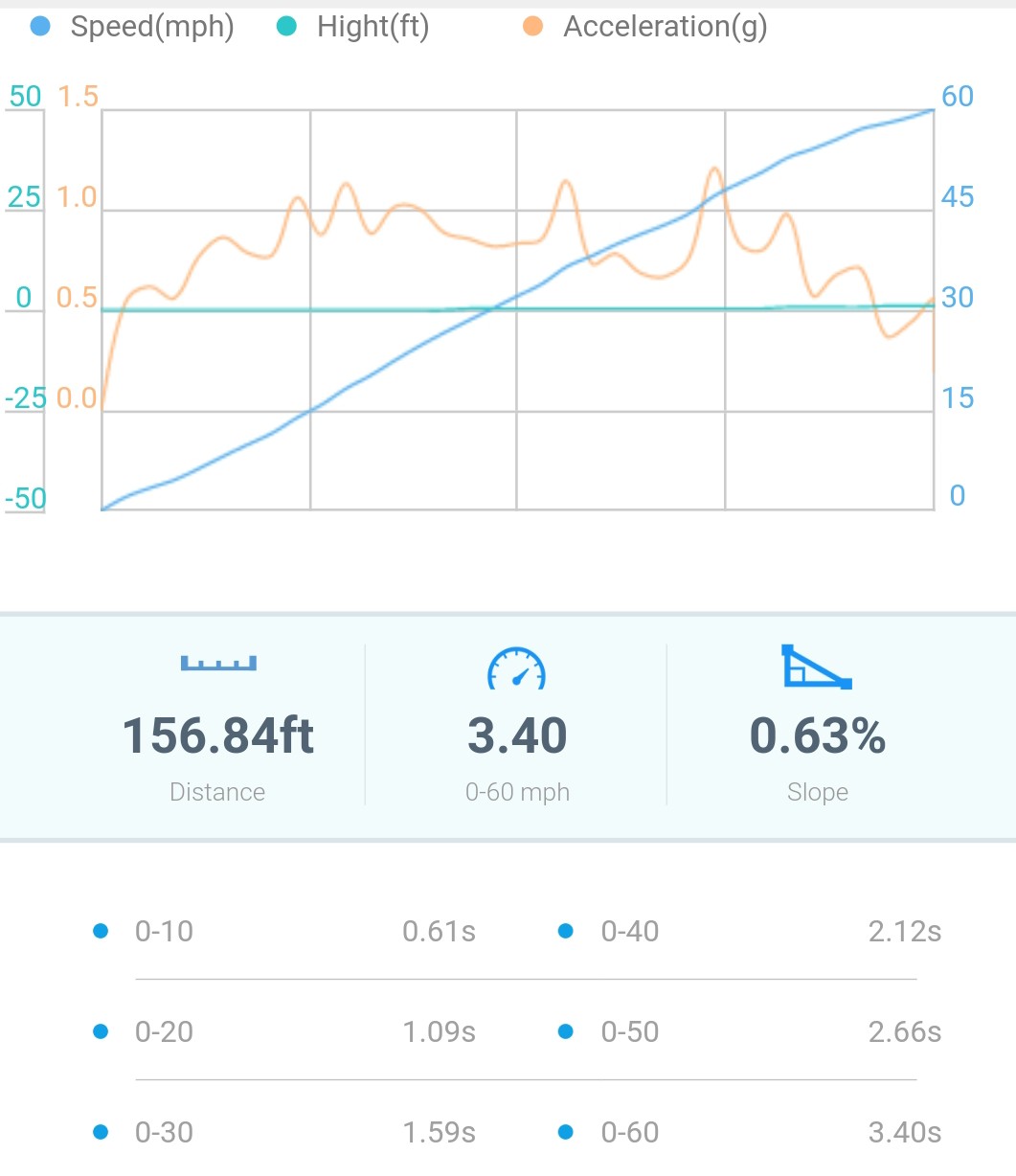

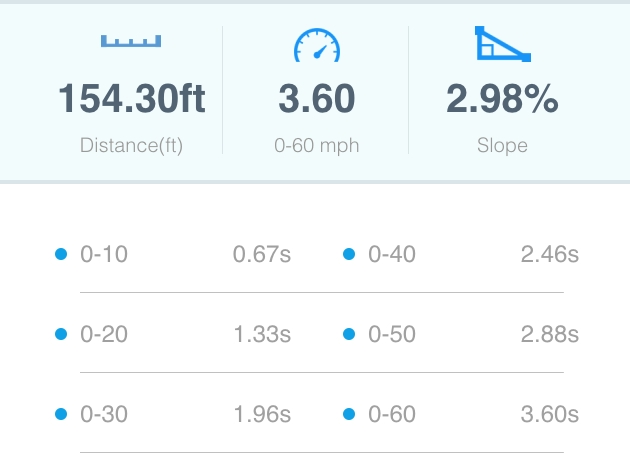

Quick 0-60 test today.
Winter tyres, full weight, slight slope and plenty of wheel spin so very promising for a very low 3 seconds with proper tyres and good tarmac (under 1 seconds for 0-20mph is easily achievable with good grip)
30-50mph in under 0.92 seconds is very fast based on my previous tests which shows that the car now has a lot of potential with the new turbo.

3.4 seconds, still winter tyres and full weight
Unbelievable! Do you have a target 0-60 you are working towards?
Hope for flat 3 eventually
