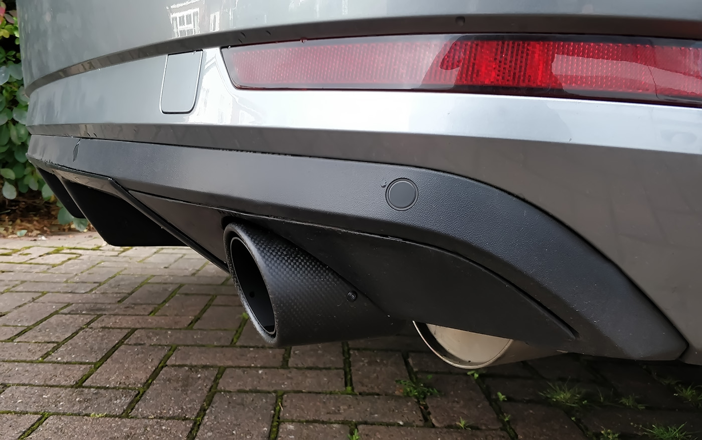

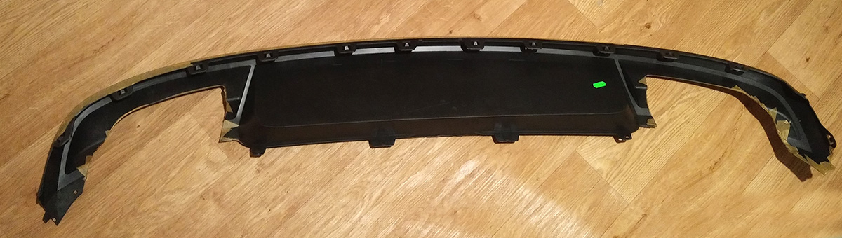

What an amazing build. I'm especially keen on your exhaust system. I'm driving the 162tsi here in Australia and currently attempting to have an "exhaust job" done on the car. I keep running into trouble with an unwillingness of fabricators to cut into the plastic bumper/diffuser to make way for exhaust tips and secondly the supposed height difference between the stock muffler and where the cuts will have to go. Any advice or template on how you cut into your rear would be warmly appreciated. Secondly, I'm also weighing up the APR carbon intake against the VWR R600. Probably tending more towards the VWR but again, any words on your experience with both would be greatly appreciated.

Hi,
The 280 (206 in Australia) already has the cuts. You can buy the rear diffuser from the 206 to fit your 162 and have the cuts ready for you.
The VWR600 gave me more power and looks more OEM too

Is this a part you purchased from Super Skoda? If not, do you have a supplier that you would recommend? Parts for these are harder to source in Australia than it would appear in Europe (and the postage is a killer)
This I bought directly from Skoda, it's an oem part.
Milltek 90mm carbon tips. Also tip is shorter (more recessed) than before.

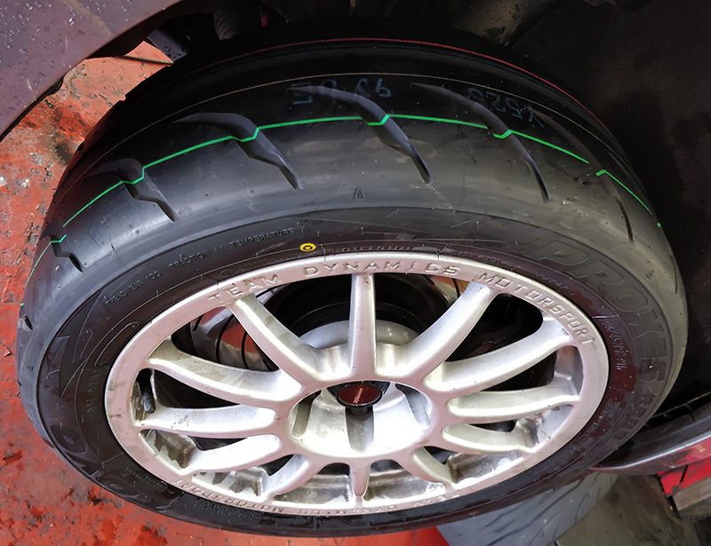

Toyo's Proxes R888R on for testing (alloys need a good clean!)
May I ask please, are these any good for every day use ? How many mile can you get under normal/spirited driving.
They look epic..........any good in the wet?
Yes, unlike the older R888 these have a water evacuation line. I will be using them as everyday tyres.
